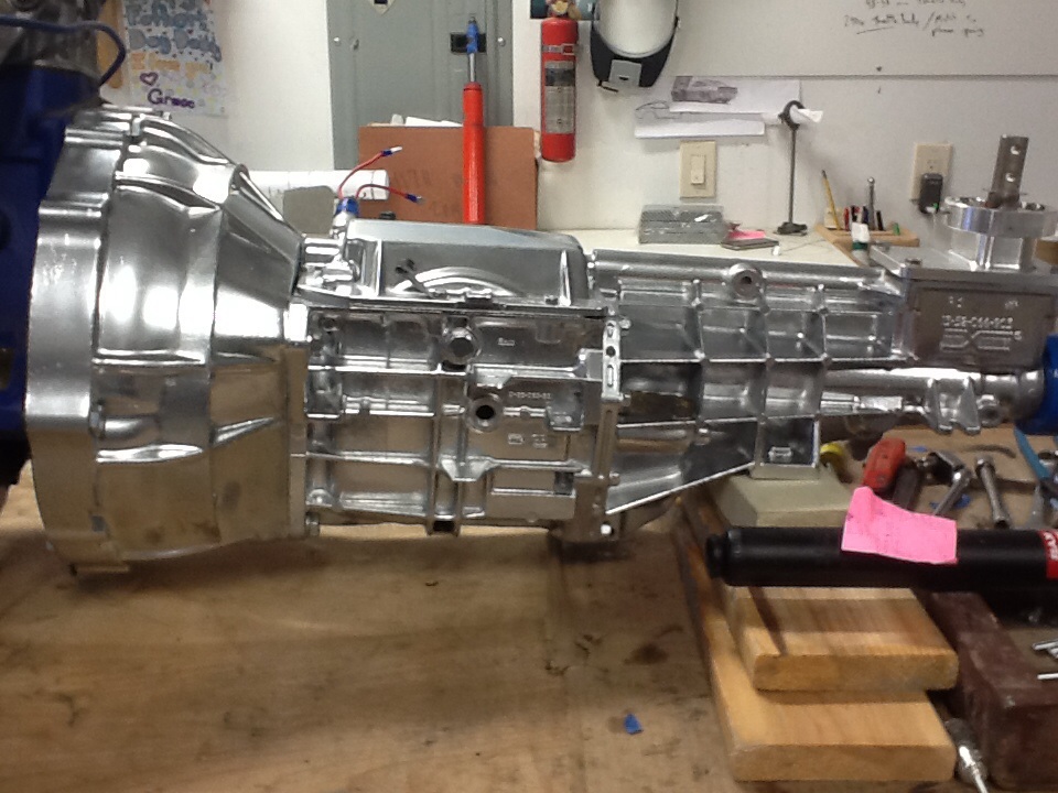

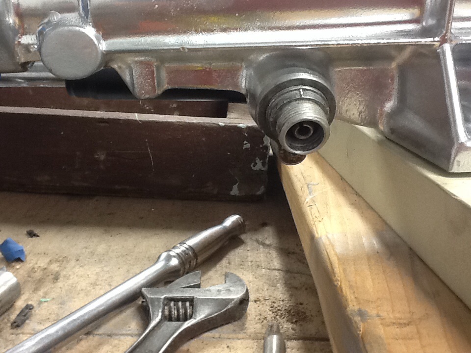

I need to remove this darned "cog" (?) from our T5 in order to put the new correct-toothed part in, but I can't seem to get it to budgepost-29142-0-16999900-1417284103_thumb.j
I removed the small bolt and keeper washer, then attempted to grab and twist with channel locks behind the threads, but no luck. Heat? post-29142-0-34589600-1417284217_thumb.jpost-29142-0-70920200-1417284235_thumb.j

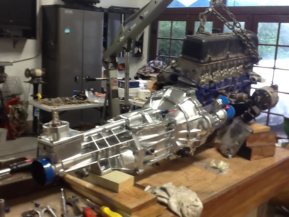

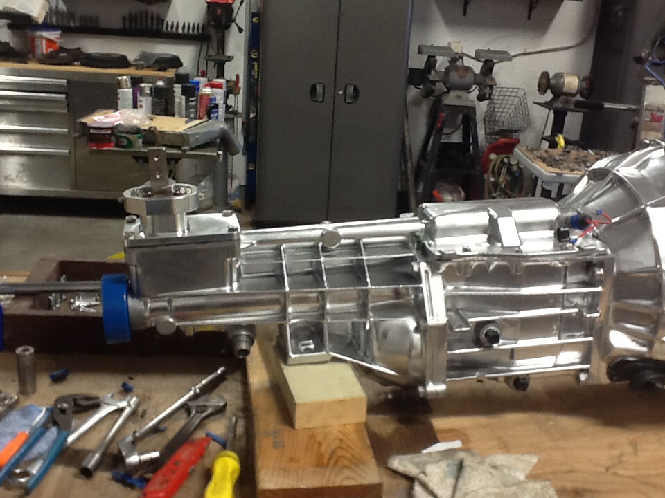

Oh; '72 240 with L28 F54/P90A sitting on my shop bench for aesthetic, sculptural interest as well as anticipation Hell. Seems like every little item; bearing collar length, fork retainer clip, or this speedo housing keeps the project spread out all over my shop in limbo

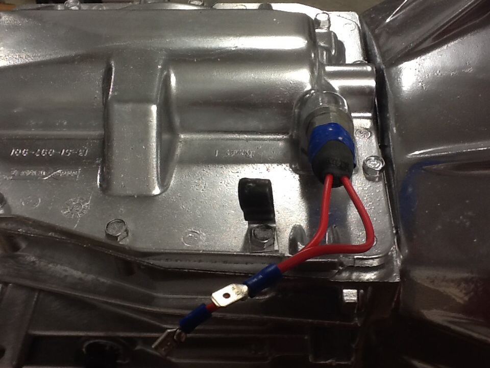

See this?post-29142-0-44974700-1417284715_thumb.j

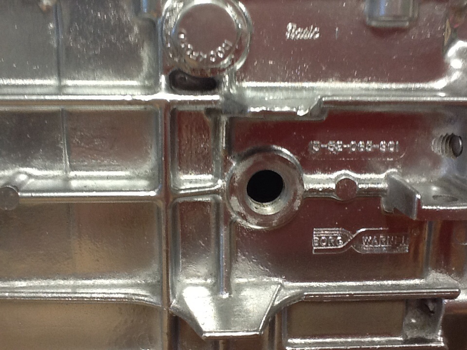

It's not shown in the NWC T5 manual, is it? I re-soldered the two connections and wasted time doing something other than searching online for what the f___ it is.post-29142-0-08938700-1417284896_thumb.j Pic 2 here: this is the port for the back up switch, right? Well I guess I better order one...post-29142-0-74760300-1417284966_thumb.j
So the first picture must be a neutral light (another member/electrical genius, Kurk MacKay -- who is making me a wiring harness to go with a MegaSquirt.... Says he believes it's the neutral switch. But I am so easily confused I could've misunderstood him or what question he was answering). Any help double checking these will be appreciated.
Speedo cog may come out with a bit of penetrating magic (50/50 mix of ATF and acetone) and a twirl with a pipe wrench.
Some heat on the aluminum surrounding the cog is another method.
If I was home I would check for you, but I believe that's right- neutral switch.
Have a DS made , you will be better off.
The switches are ID'ed in the FSM.
Second the heat suggestion on the cog housing,  It will soften the o-ring rubber and open the clearance.  You can also tap it in a hair with a soft mallet or block of wood to break it loose, before twisting it out, or levering it out via the notch with a screwdriver.
