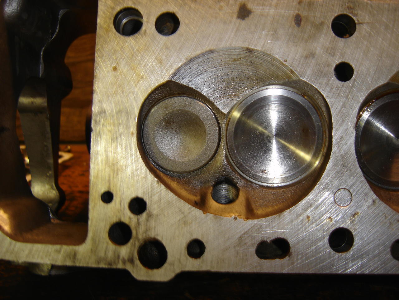

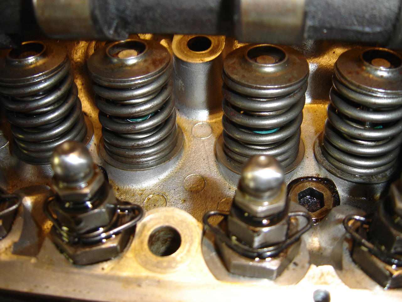

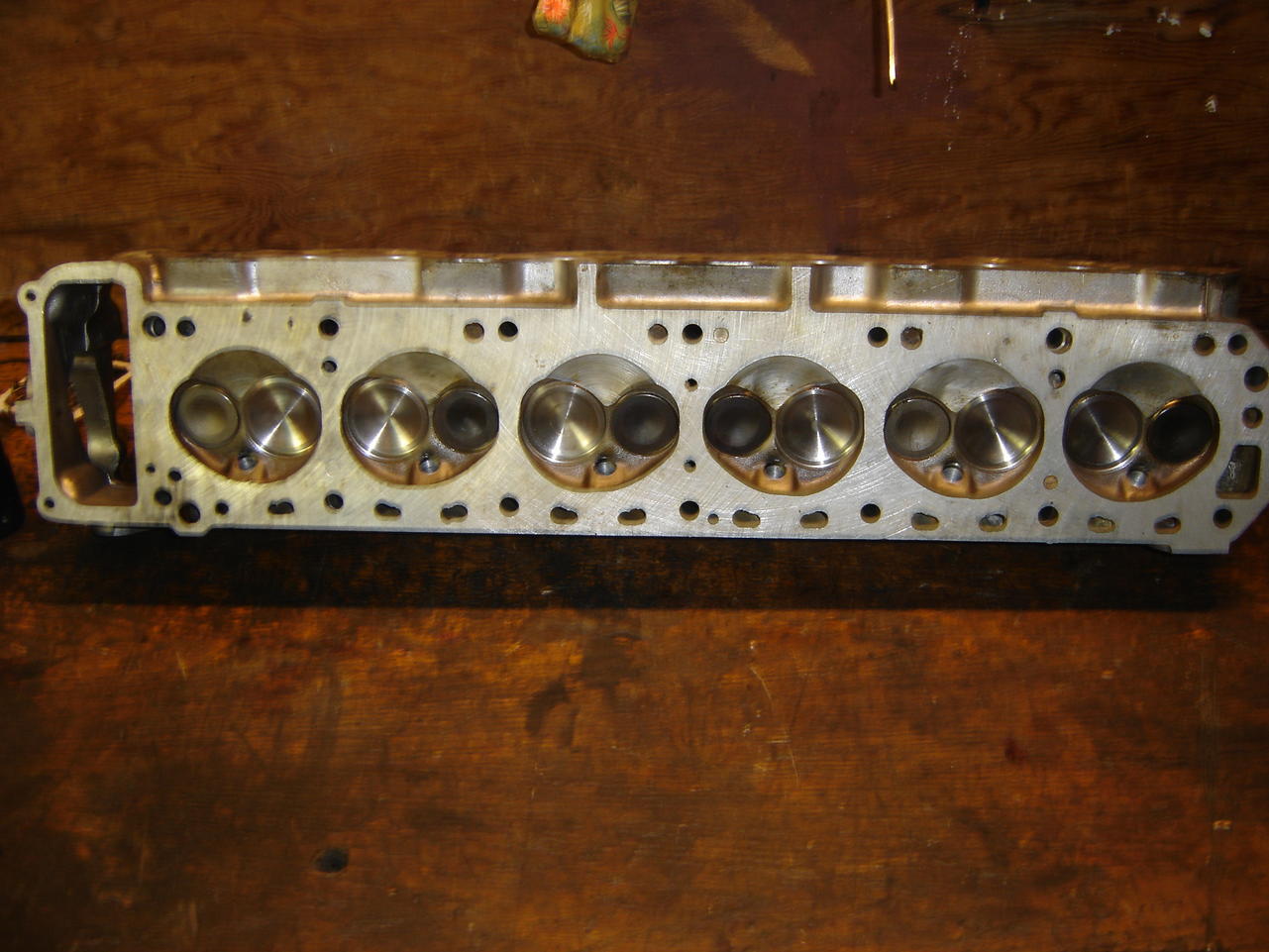

I got this a couple of years ago and am ready to get the cam kit for it. I've read go wild not mild to prevent detonation problems, but cam specs are all over the place so advise me please. Can't decide whether to put it on top of an L28 with flat pistons or the L24. It's got the big intake valves and steel seats, also teal colored valve seals. All new a few years ago, never been bolted down. maybe I should use the N47 I have. LOL
Big intakes on the L24 will likely require fly-cutting the block, unless it has already been bored .040" over. Save it for an L28.

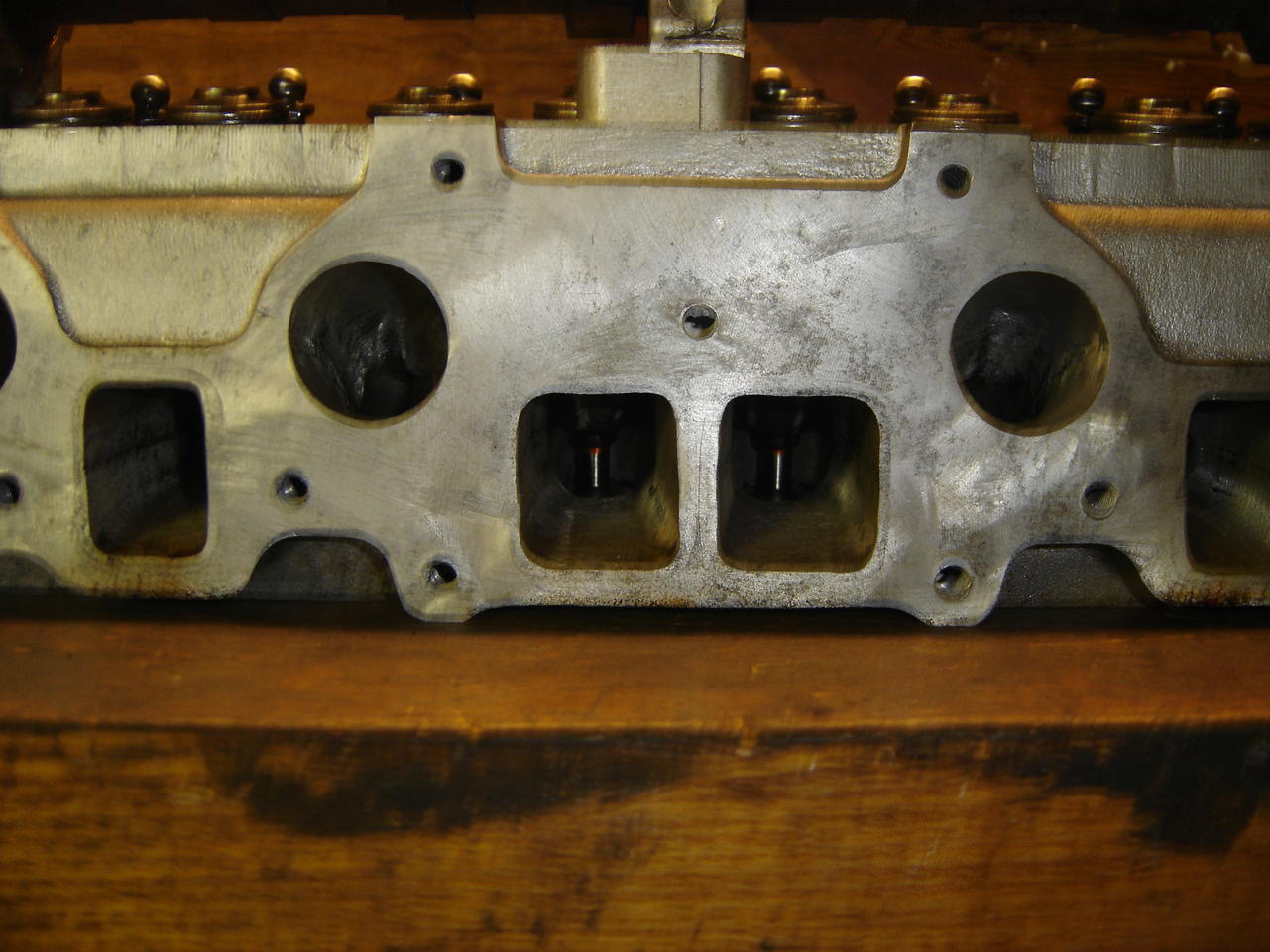

Besides the bigger valves, it looks like it might be ported. Are you sure the installed cam is stock?

Sure the exhaust wasn't upgraded also. I'd see if those aren't 35mm.

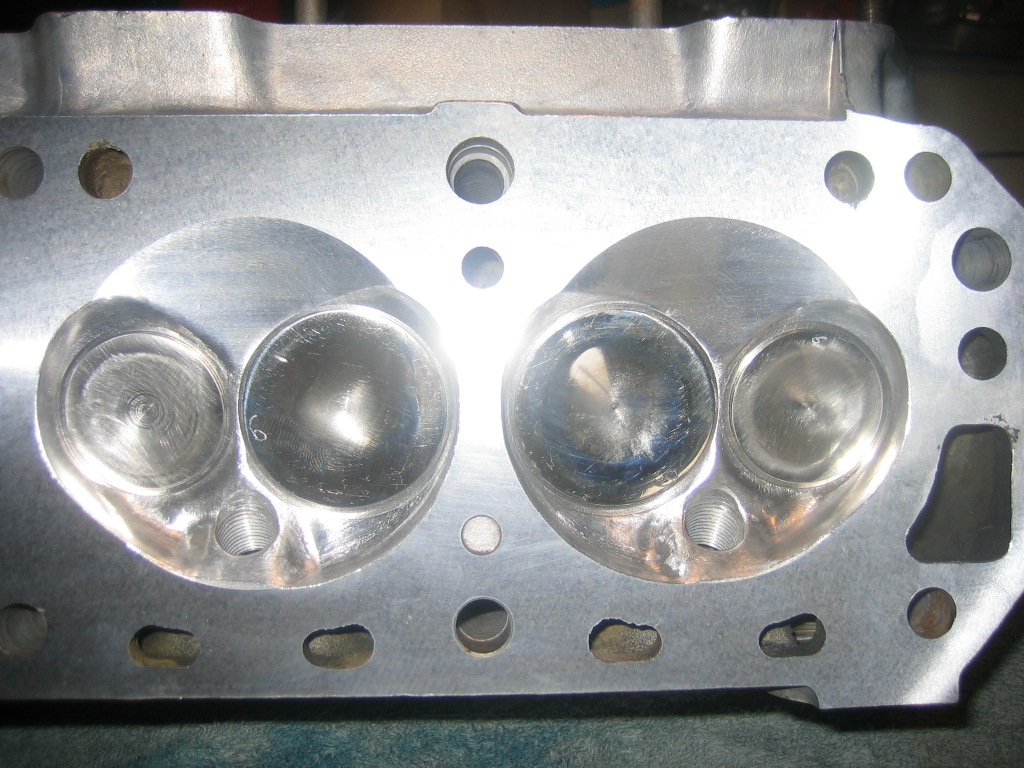

Clearance would need to be checked for sure, or just unshroud everything including the cylinder bores.

L28 block would put you at about 10.25 I think. That's my next step. I already have the flat top block sitting on a stand
You might measure combustion chamber volume to see what your CR will be. You might find the flat-top L28 puts you at 12:1 or something.
It looks to me like the exhaust valves are oversized also. Those are the ones that hit the block on an L24.

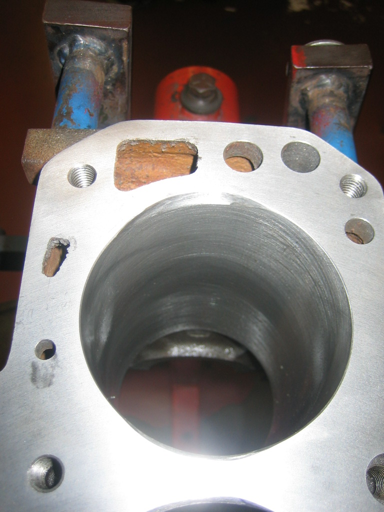

I have big intake valves with stock exhaust valves on my engine, and they didn't cause any problem on my stock diameter L24. Somewhere here there is a thread where madkaw (Steve) shows a view from the bottom of the cylinder that illustrates the problem with big exhaust valves better than it could ever be explained in words.
Not sure what pic you are refering to Walter, but the one above shows how I clearanced the bores. My block is .040 over , but I did it for breathing reasons.

Valve guide seals can't be stock with that size cam so check that.
Unshrouded combustion chamber will lower CR a bit.
