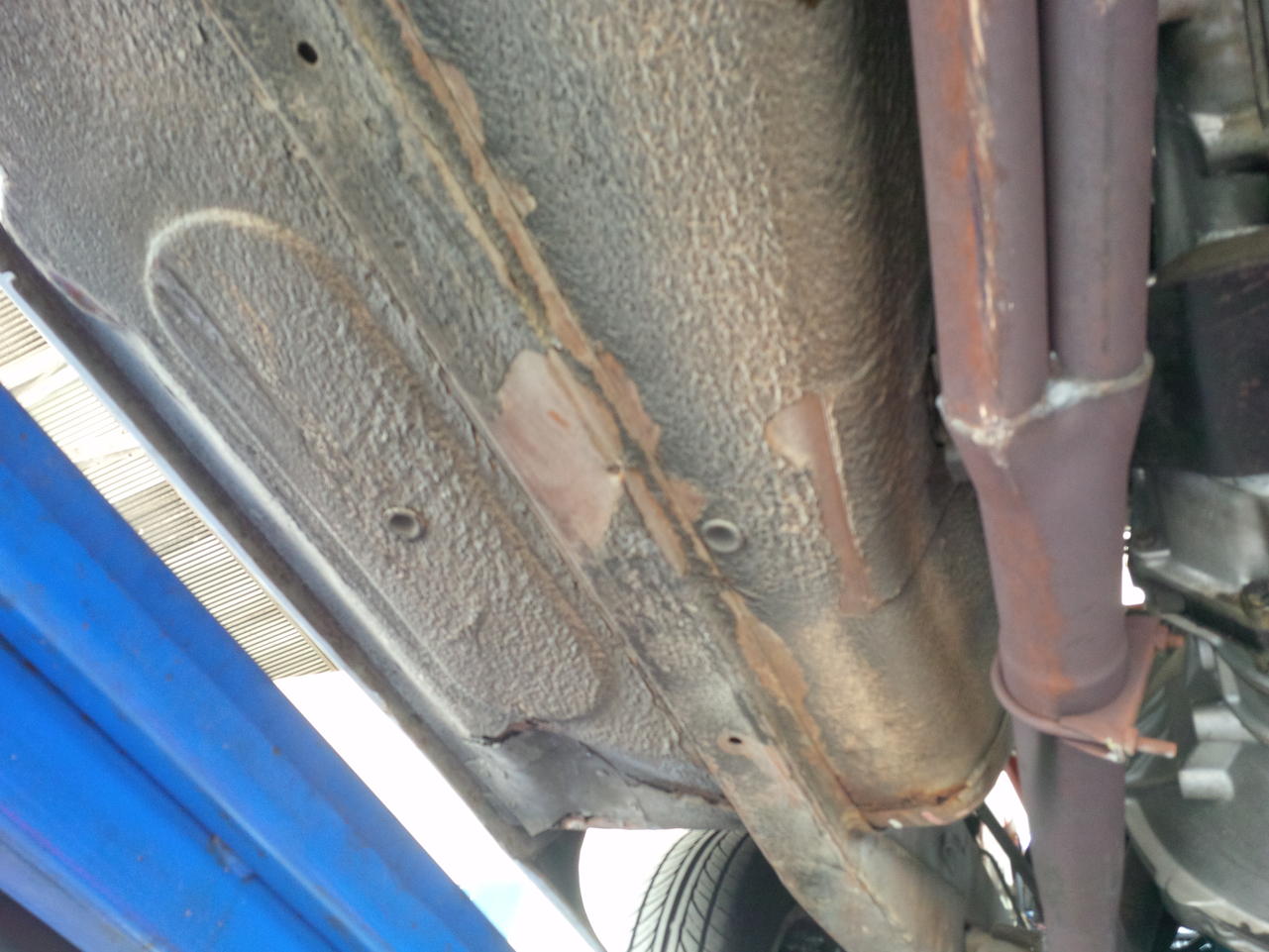

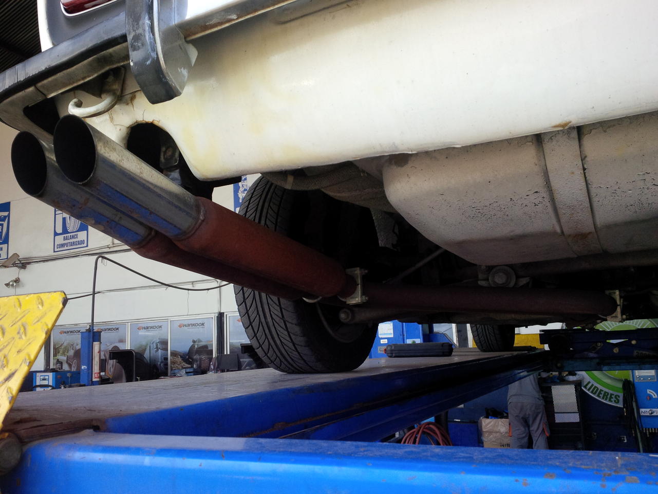

My 1972 240z was previously modified with this twice pipe exhaust system which is loud as hell:
I want to go back to stock so i can use my car as a daily driver and not a racing machine. Just as a normal sedan. Is this what i need to purchase and have installed:

I don't see any mufflers in the picture. Many people run their cars with no mufflers, you might not have any. The MSA twice-pipe came with mufflers. It might be that installing two simple glass pack mufflers will make it quiet enough.

You are at a crossroads. You could try additional glasspacks midway in the system, but not sure if it will quiet it down much. You won't beable to find a chambered muffler that will easily mate up with the system you have now. Your best option might be to sell off that system completely and start over with a single pipe system with a premuffler and muffler for quieter results.

From what I've read over the years, the twice-pipes exhaust provides little benefit under most driving conditions over a large pipe exhaust. There is more pipe surface area to provide friction. It's not a V engine.
I'd just go to a local independent muffler shop, have them install a pipe and muffler. Just explain you want it quiet, and as much ground clearance as possible.
Stock pipe reduces performance. Installing 2 1/4" pipe and turbo muffler (with an adapter welded to the stock Y pipe) took about 1.2 seconds off my 0 to 60 mph time with no other modifications. And it's not so loud I'd get a ticket.
I agree with Stanley. Make it easy on yourself and just go to a local muffler shop. They'll have you in, out, and quiet on the road in no time.
