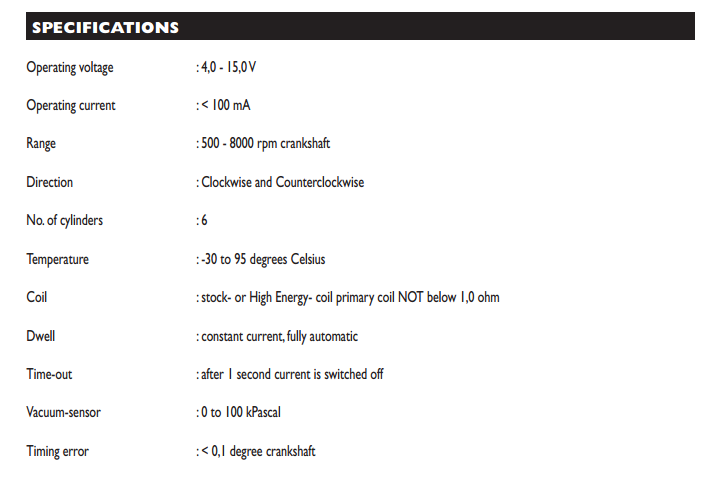

Did you get an older model or are you assuming that it needs a low energy coil?  I'm not sure which thread it was discussed in, maybe this one, but the latest versions allow high energy coils.  Not less than 1 ohm, but that's what the 78 and later Z's and ZX's use, about 1 ohm.  In the higher energy range, certainly more than the old 240Z systems.  With dwell control, which is the key to the modern systems.
http://www.123ignition.nl/downloads/manuals/123SWITCH6.pdf

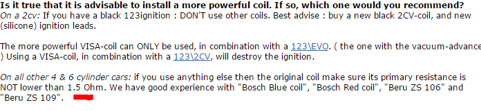

The manufacturer has always recommended using a coil of not less than 1-Ohm. Stay away from square coils they typically are .75-Ohm and lower. You may get away with it for a while but no guarantees. I personally use a Bosch Blue (3.4 Ohm). The Bosch Red is 1.2 Ohm.
Ed
Easy to get confused, especially since most "high-energy" coils (assuming means coils for high-energy ignitions, commonly assumed to mean constant current systems, like the GM HEI system) are below 1.0 ohm.  The GM HEI coil is about 0.7 +/- 0.1., for example.  Plus the FAQ's give conflicting information, and say 1.5 ohms is the limit.
http://www.123ignition.nl/faq.php
