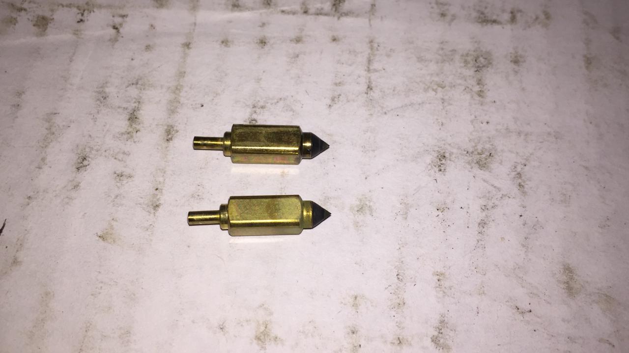

Where do i purchase a new set of high quality needle valves for my 3 screws su carbs?
