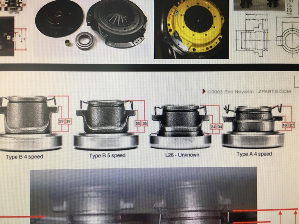

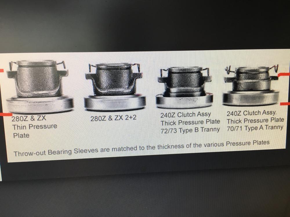

Which collar would I use?
I not sure which collar you now have, but it sounds like you have the longer one. If you open the transmission link in post#8 and scroll down to the clutch forks. You probably have the left one in the right photo. Its 28mm from were the fork fingers sit to the back of the bearing. The right one is 24mm. You could ask the company that supplied the clutch for info on which collar to use.
I think, but not certain of it, that they changed from 280z to 280zx, but that could be onlt the turbo model. It the clutch is for the 280ZX then that could be where your problem is.

I had a similar problem, and simply made up a shorter thrust rod for the slave. Worked for me.
I knew a brickies labourer that had exactly the opposite problem. He had both collars and used the short collar where he needed the long one. To solve the problem he just made a longer rod for the slave cylinder. Only problem was the clutch fork hit the housing before the clutch was completly disengaged. You could only push the clucth pedal 3/4"down. After a test run grinding gears, he had to pull it back out. Talk about bad luck, but he wasnt all that bright...

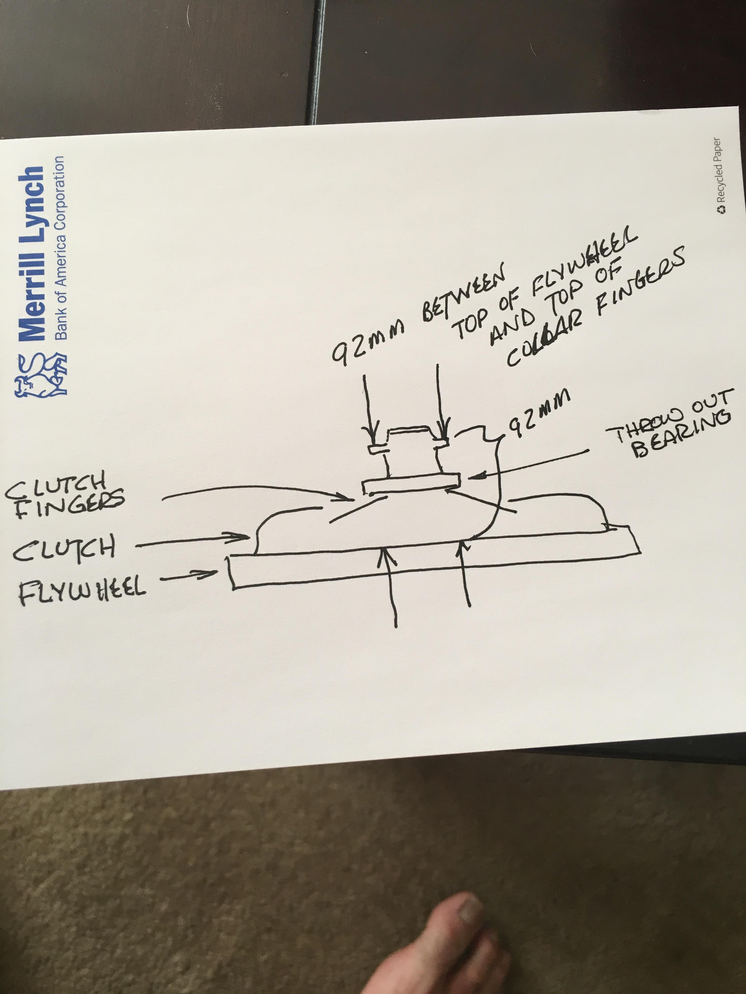

Sounds to me like you've ordered the right collar.....unless they sent you the wrong clutch. I just installed a 240mm flywheel and an Exedy Stage I comp clutch. I used the 2+2/ turbo collar and she works like a dream (it'll really build up your left leg lol). It's easier to pull the tranny. When you get the new collar, use this test.....if the measurement comes out like in my drawing, you'll be good to go and you'll love the old girl once more. :wub:
