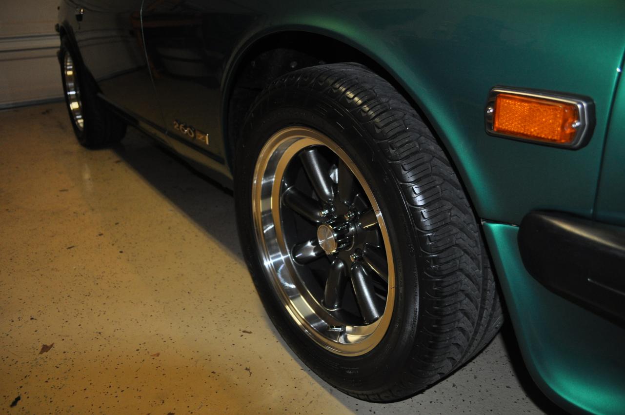

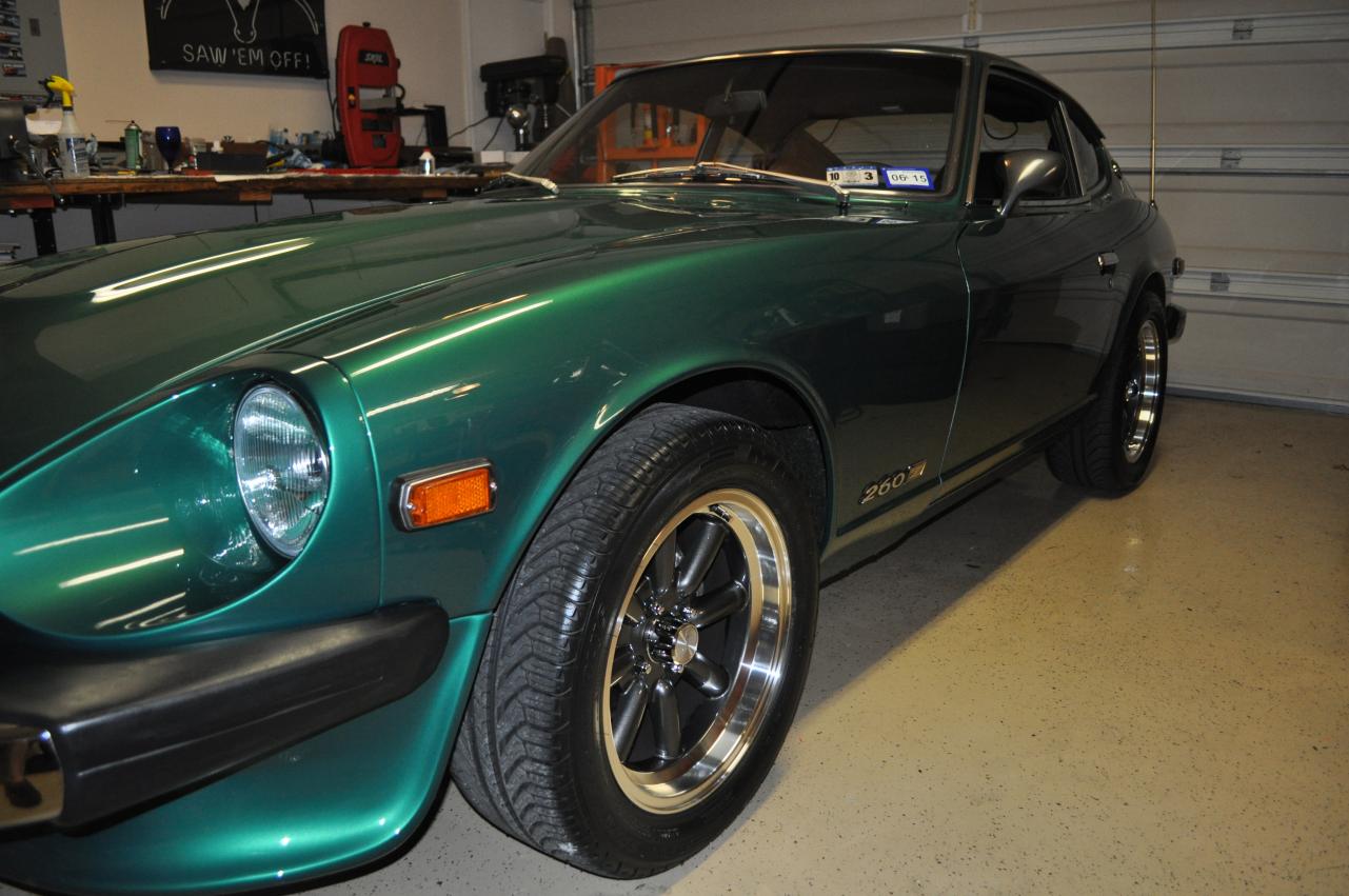

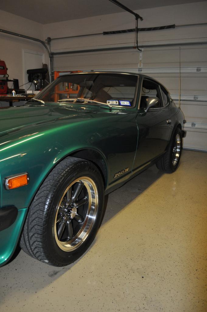

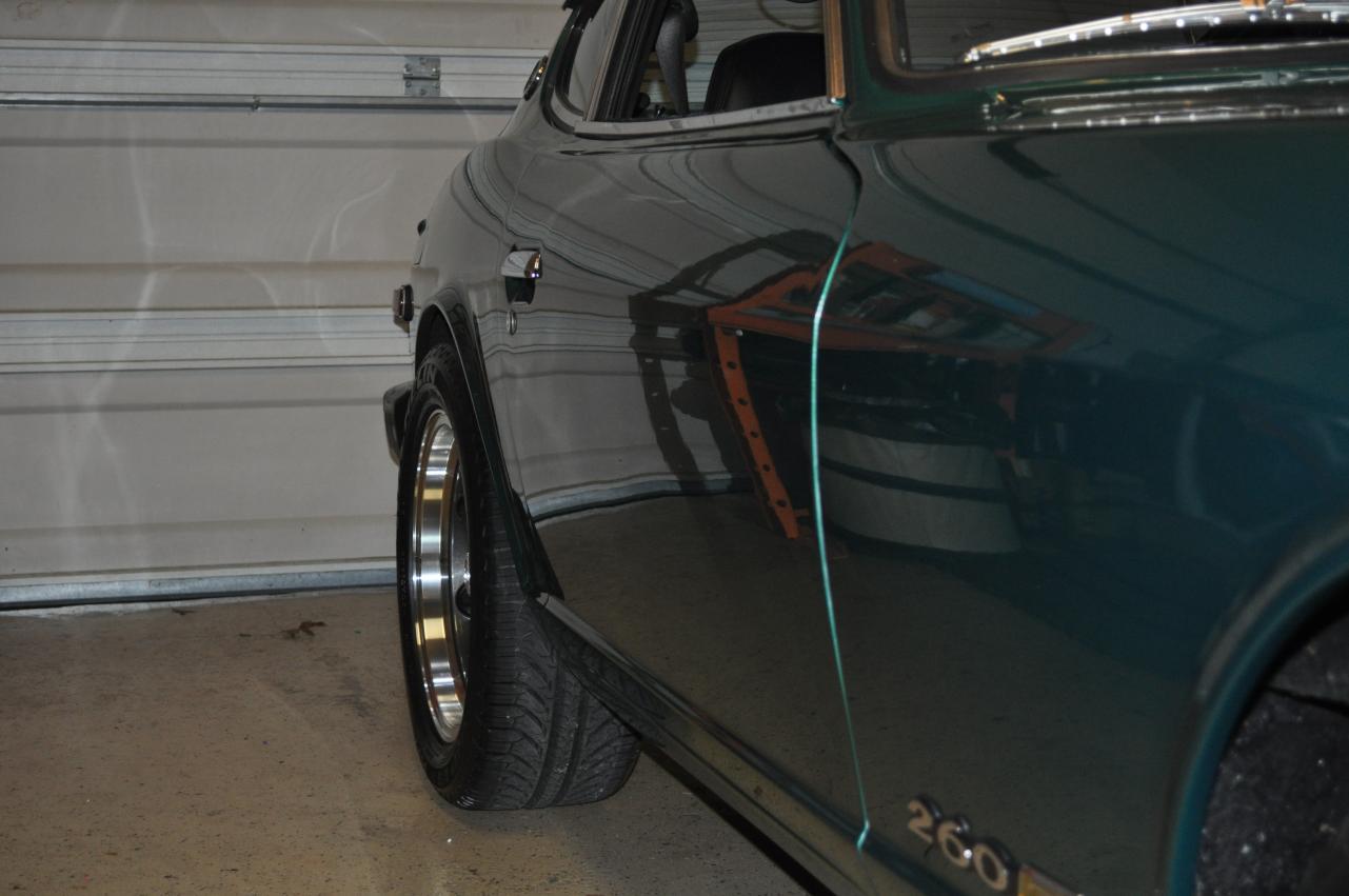

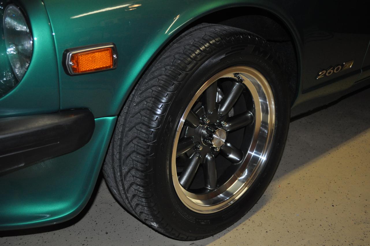

I just went with a similar setup. I decided on the Konig Rewinds and went with Michelin Pilot Sport Plus tires. 225/50-16 fit just fine. The only clearance issue that I had was a very slight rubbing on the right rear tire when going over very aggressive bumps in the road. Had to have the fender rolled to cure it, but that was pretty straight forward.
It's also pretty amazing to feel the handling differences with these tires as compared to the BF Goodrich Radial TA's that I was running. I decided to keep my Appliance wheels and BFG tires so I have the ability to switch if I want to change out the Konig's for a different event, but for really driving, you can't beat the Michelins.
Here's a few pictures with the new tires and wheels.
Mike.
