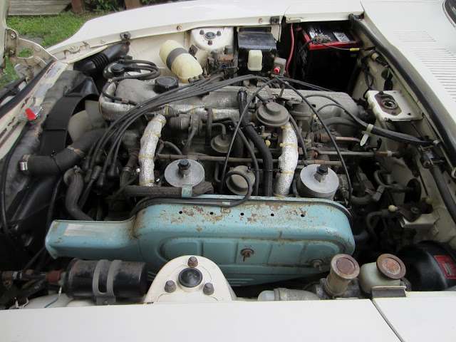

Okay, from that picture we can tell you have a "late" 260Z. The bumpers are a dead give-away. You'll find it has a lot of parts in common with the 75 280Z. You might find that there are components in the engine bay that are in different locations from the FSM, too. What is the build date on the door jamb plate?

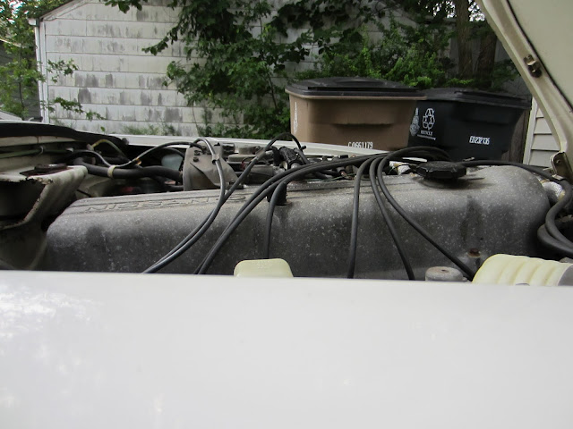

Thats a picture of the engine bay, but whats kind of worrying me is this:
It may just be the angle of my driveway and the shape of the car, but it seems a lot of other cars engines also tilt the same way.

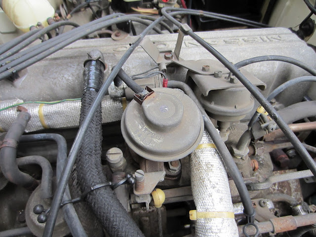

About the diesel noise, Ive narrowed it down to this area:
I can hear it in some form on nearly every Datsun engine bay video and shouldve captured it today on video. Not the fans like I thought. Any ideas? What is that covered by that cap?
