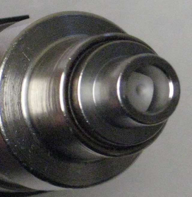

That would be great. I haven't ordered mine yet and would love to know if the spray end has a small hole or opened up like most of the pictures I've seen. If you could tell me how they look when you get them I'd be grateful.

You might be thinking of the pintle cap design. All of the Z injectors, I believe, are pintle type. There is one small hole in the end and a pintle, or pin, that is used to block the hole. The pintle is attached to the solenoid and moves up and down to let the fuel out. There's a variety of pintle caps out there, but the end of the injector itself underneath looks the same, a metal end with a small hole with a pin sticking out of it. I don't think that any of the injectors available for the Z engines are the later multi-hole hole design.
The pintle design can still give a variety of spay patterns from a straight narrow stream to a nice big cloud of vapor. I just tested a variety on a home-made testing rig. A set of stock Nissan injectors gave a V-shaped pattern, while some Bosch injectors gave a big cloud.

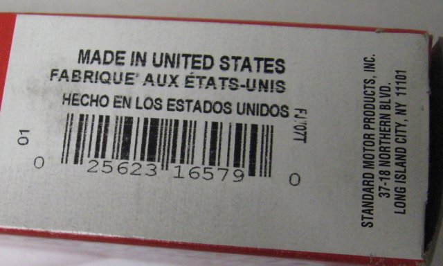

My FJ707T injectors have arrived. Photos attached. FWIW, I thought I had read that the Standard T series injectors were chinese made but the box states that they are made in the USA. We'll see how they perform. I am encouraged that a USA made item like this is so price competetive (~$26). I was also happy that these injectors came with the seals and clamp. Not sure if that is standard practice or not.
Its going to be a couple of weeks before I am ready to fire up this Z.
