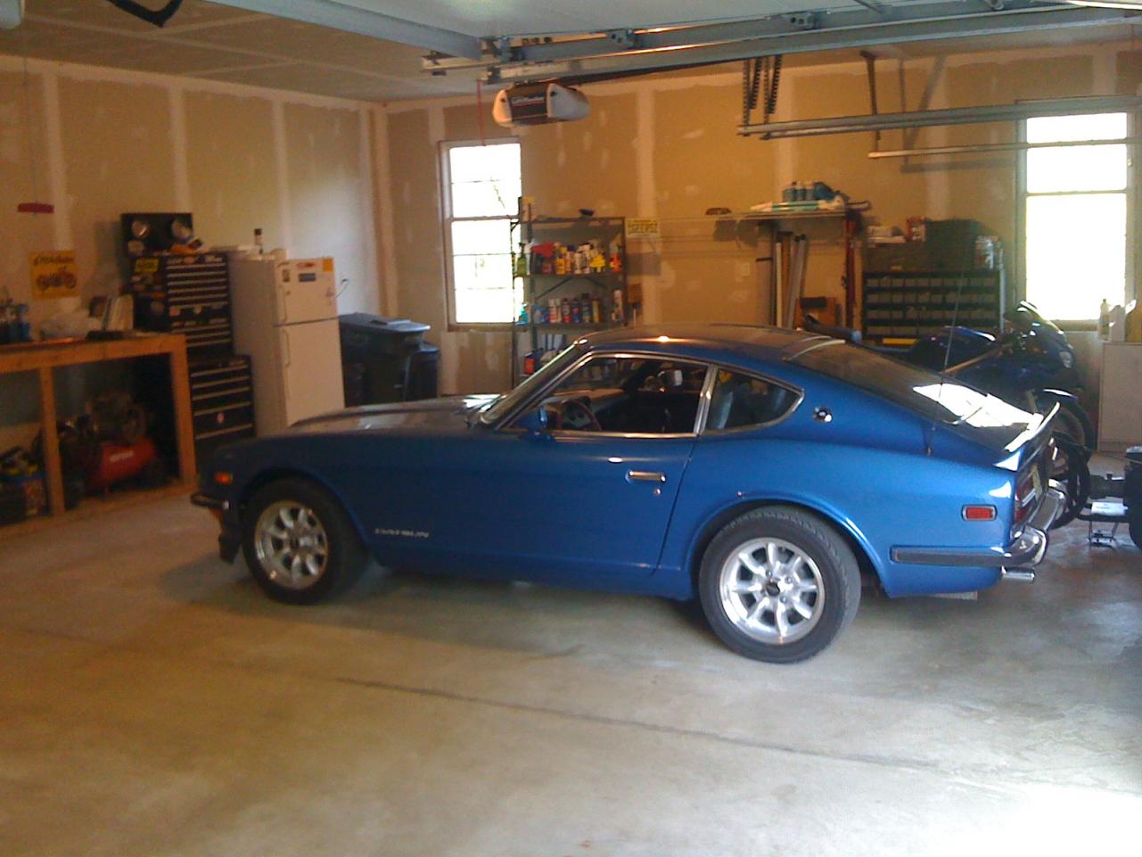

And get you self one of these good DIY project :D
Guys stop braggig and do as Gary, post photos
