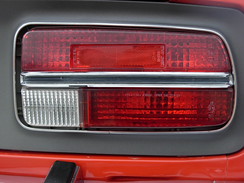

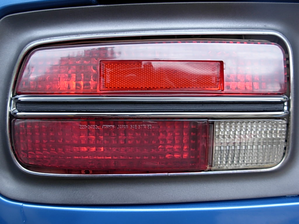

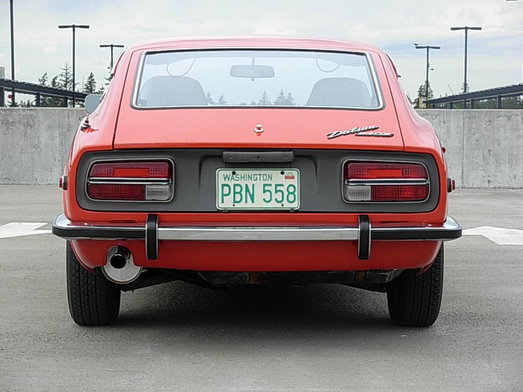

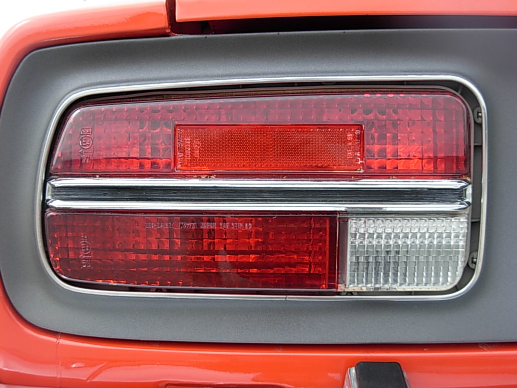

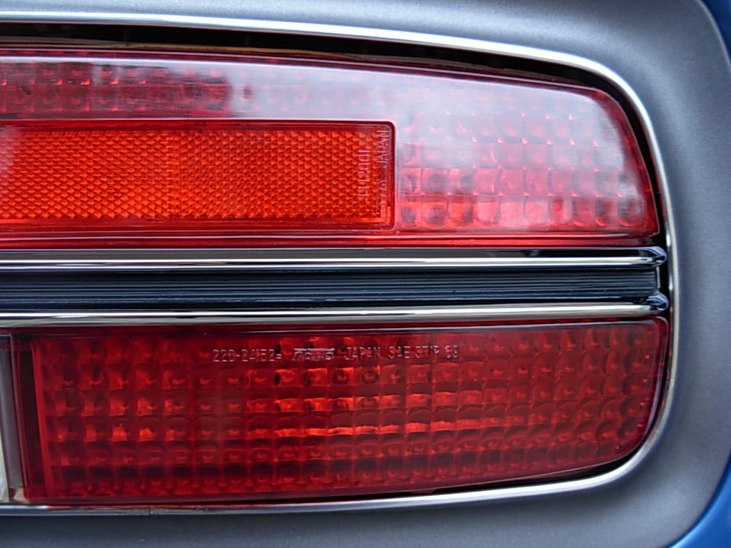

Arne I agree the chrome strips are all the same (none were ever metal). The early lens may be slightly darker, but it is hard to tell and I am not sure that the part number is a good identifier. Early North American market lights are all marked 220-24152 (L or R depending on the side) and most of the later lights are marked 220-24166 (L or R depending on the side). However, I have also seen some later lights marked 220-24152 that are not darker like the early ones. My 5/72 production car has a 220-24152 on the left side and 220-24166 on the right and they both look the same to me (see pictures of the red car below). There is a way to differentiate the early North American market lights though. On all three of my 1969 production cars the only markings are the ones on the bottom of the lens (220-24152 Koito Japan SAE STIR 69) and the markings on the left and right side of the flat rectangular piece in the upper part of the lens. Later lenses have other markings on the outboard side of the lenses (left side on the left lens and right side on the right lens) and some more markings on the flat rectangular piece. I've also attached some pictures of the early lenses from HLS30-00032 after I installed the rechromed trim strips.
-Mike
