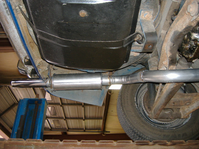

When replacing the exhaust on the 73, I was there and showed them where to weld the flat cut tip. It extends about 2" from the bumper, only photo. The old system had a slant cut which I think helped drag fumes under the car, and unwelded connections. :stupid: The combination of a new system and the flat cut end has reduced fumes 98%, but still get a whiff now and then.
