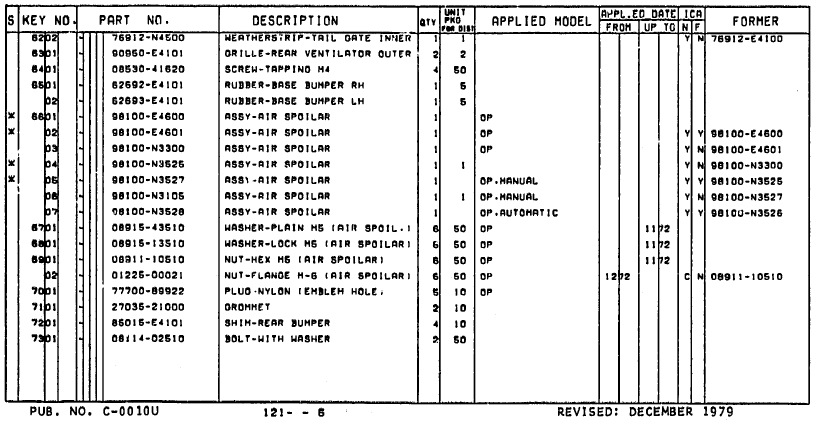

If the supercession took place after your parts catalog was published it will not be seen in your catalog. I will look it up in the microfiche to see what changes were made after June of '74 up to the microfiche date of issue. I know you are getting frustrated trying to source this weatherstrip, but I don't know if it is possible to find one identical to your original today or not.
Richard, I did read all of your post. Most of what you ask seems somewhat rhetorical to me. You are surprised that there may have been further supersessions after your copy of the parts list was printed 35 years ago. This surprises you -- how? The attached screenshot shows that the part number you are working with now WAS superseded by the time my copy was published in December 1979.

Your '74 parts book was right in '74, since then, there have been umpteen revisions to the parts lists it illustrates, caused by consolidation of similar parts, loss vendors, and to make matters worse, the latest part number is what makes it into the latest parts listing, meaning a superseded part only lists its closest predecessor, and not the however many there have been for the original part number. If you use Nissan Fast to look up your part numbers(the USA version or the Japanese versions anyway), it will normally list the entire supercession chain-most parts people will not share that with you by default, but it is there. Older listings will only show what was current at the time it was published.
I have several version of the parts catalogs, and this is just the way it is...which is why I have collected several of the carts catalogs, Microfiche, and software, sometimes a partnumber has to be found by exploring several layers of Nissan part numbers.
