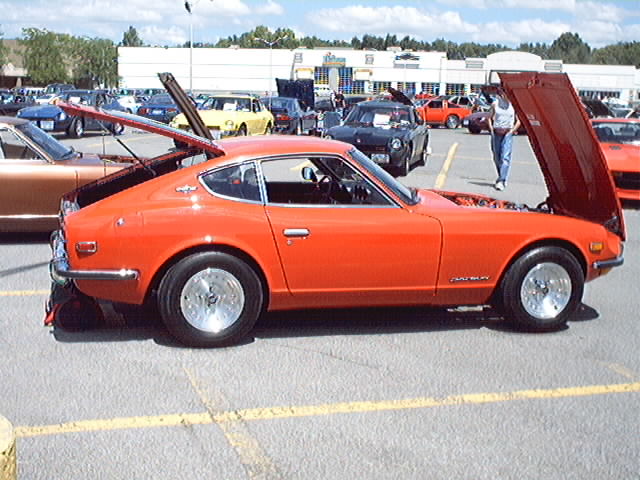

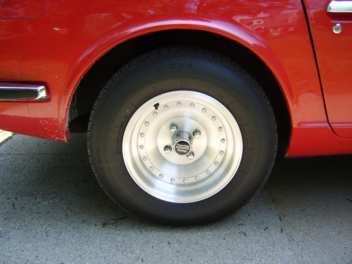

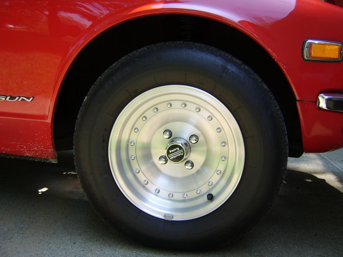

I have just installed Courtesy Nissan OEM springs all around and measure...9 inches across rocker panel to ground.....27 1/4 inches to front wheel arch ..and 26 3/4 inches to rear wheel arch. I am running 205/70R14. I put in Tokico Illuminas in rear and KYBs in front. The older pic is with the original (to my knowledge) springs and struts.
