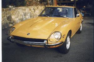

This might help solve the puzzle of a 1970 that I flew to New York to inspect in 2002.
The car was European exotic car dealership in upstate NY. It was repainted the original butterscotch color, and with the exception of clear headlight covers and a set of Panasport wheels, looked to be original on the exterior. When the salesperson opened the hood I noticed the light blue air cleaner. It looked to be taken off a later model car, but it didn’t have a flapper or provision for the aluminum heat collector that connects near the exhaust manifold. It might have been a year correct dealer replacement after all.
