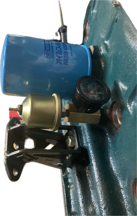

Posted the pic. Until you do this mod you don’t have a clue what the pressure is. Takes research and find the parts.
I thought about suggesting that but it seems so challenging to even get the simple things done, I didn't want to complicate things.
I have done a similar mod in the past and found that even though the gauge showed almost no pressure at idle it was actually about 30 pounds

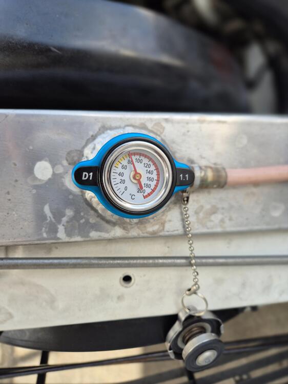

Test done! Water is flowing! I even installed a temperature cap and it remains in 80 degrees under heavy traffic! I guess sensor or gauge is not reading correctly! Any advice?
Ok, thanks for doing the test, now I'll move on - funny how you get a solution when you listen to us, huh.

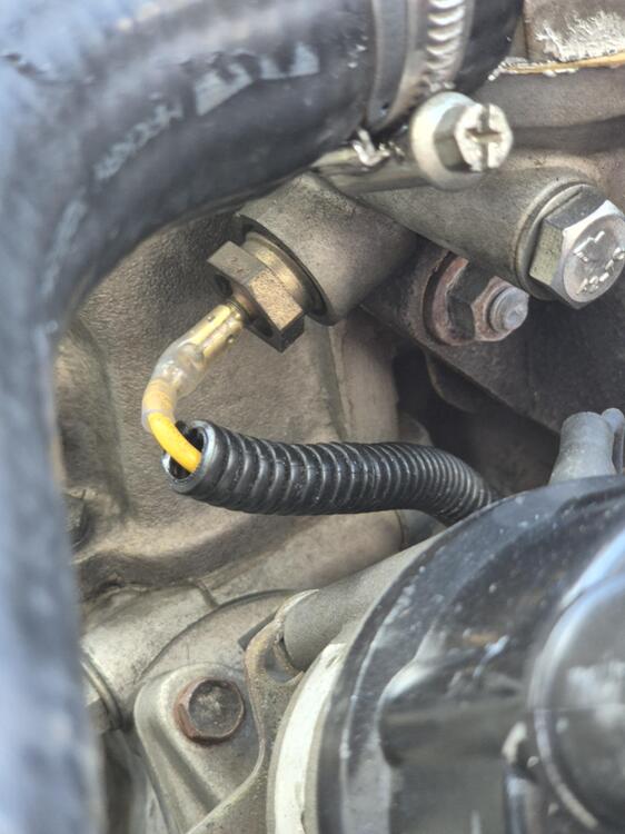

You have 1 test left - this will tell you if its the sensor OR the gauge that need to be replaced.
Unplug that yellow wire you took a picture of and ground it against the engine block using an alligator clip/piece of wire/whatever. Touch one end of the alligator clip to the engine block (or any groundable area), touch the other end of the alligator clip to the yellow wire's metal connector, turn the ignition key to 'on', and look at the gauge:
  • IF your gauge is good, the gauge's needle will move all the way right (250+). If that happens, your gauge is good, and your temp sensor needs to be replaced.
  • If the gauge does NOT move all the way to the right it is probably your gauge. Replace the temp sender too though.
This is the final test - it WILL give you a final answer.

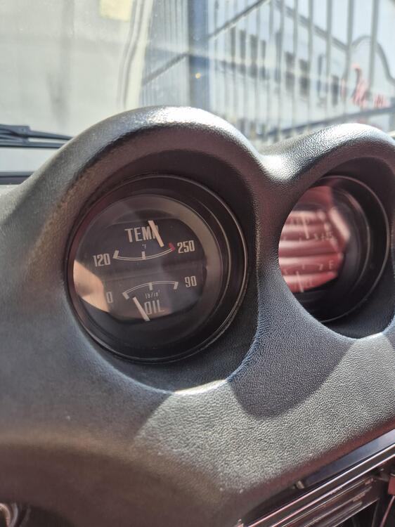

Gauge needle moved all the way to the right till 250F when doing this test. What next?? I need a high quality japanese made sensor. Maybe nissan made in Japan.
