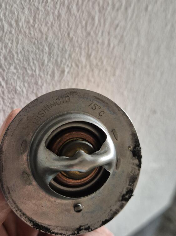

  • Thermostat - since you already have yours out, lets test it. throw it in a pot of water on your stove and use a thermometer to see if it FULLY opens at 75c (use a meat thermometer or something in there to see when the water is the right temp). if not, your thermostat isn't allowing all of your coolant to cycle and that is the issue. I did this a while ago when i suspected my thermostat and that proved it was the issue. the thermostat keeps the car at a minimum temp, not a max one. if you remove the thermostat, it will get to 3/4 still...but it will just take longer if the thermostat is functioning properly

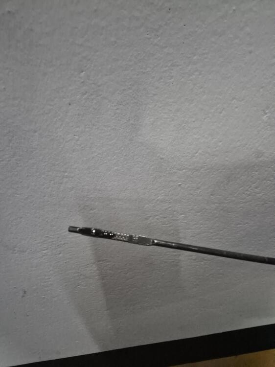

run it with whatever oil datsun recommends (I dont remember). Did you pull the dipstick to see if the oil level is low?
running it without a thermostat can be detrimental in that there isn't a thermostat there to slow the SPEED of the coolant. meaning the coolant can be pressurized more than components are designed to hold. also, if the thermostat you have is working properly, then removing it (besides causing harm) will just be a waste of time. since you already have the thermostat out of the car, just throw it in a pot of hot water and see if that is your problem. all of those tests i wrote out literally take less than 10 minutes

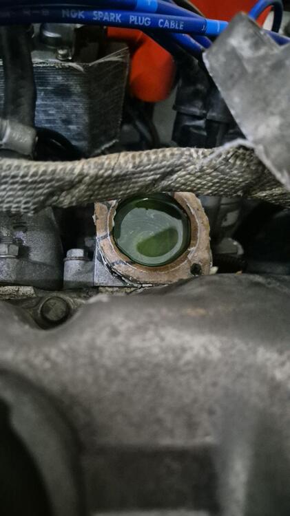

Dip stick out and the car was running with no thermostat. This is really weird. Any solution before opening the engine?
Hang on - the engine runs with the thermostat cover off and the coolant doesn't go all over the garage? If that's the case there is something dreadfully wrong with your water pump.
The car running with the dipstick out is an unrelated issue. If the car runs fine with the dipstick out it means the car has a pretty large vacuum leak that a previous owner didn't find/look for and instead tuned the idle speed to compensate.
Also that oil on the dipstick looks pretty terrible - I'd strongly consider doing an oil change asap
Way way past an oil change and low on oil. Going down a rabbit hole here. A good tech would have seen if there was circulation through the radiator. Posting non conclusive results.

You misunderstood me. I opened the thermostat housing and discover the tech had not replaced the mishimoto 75 degreees thermostat. Im testing the car tomorrow, adding 1 quart of 10w 30 synthetic oil and reverting. Im concerned about the temperature. How come it goes to 3/4 with no thermostat??

Ok, so just to confirm - the car is now driving without a thermostat and you are getting the same 3/4 on the temp gauge that you got when the thermostat was installed in the past, correct?
It that is the case, then the thermostat theory is out the door. Turn the car on with the radiator cap off and look to see if the coolant is circulating since the thermostat is off the car. Then press the throttle linkage to rev the engine and see if the coolant speeds up everytime you rev it. That will tell us if your water pump is working. Also, you'll know if you're low on coolant.

I drove the car from the mechanic shop to my house with no thermostat inside the housing. During light traffic i got to 3/4 temperature. Something is just not correct.
