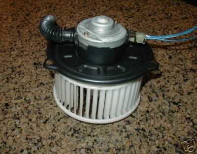

Thats alot of work and money for something I can buy from a couple of different sellers on E-bay for less than $60. And both of them include a pigtail to plug it in with. Just do a search for "Datsun Blower"

Stock 240z fans don't have pigtails....that's a Honda pigtail...even if you have a pigtail, you still have to splice the wires into the setup. 240's use 2 male/female plugs sticking out of the wiring harness only about an inch.
All references to 'honda blowers' show a silver ended fan that even if painted black, does not match the 240z motor housing (the one in the picture has this pigtail thingy plugging into the motor). The procedure I used matches the original fan, where 2 wires come out of the stock motor. Without mods, my fan looks stock...I will post pictures as soon as I find my camera.

What I was trying to say, was that there are guys selling that upgrade on Ebay for about 60 bucks, with a connector for the honda motor that has the conectors spliced on it for "plug and play" use in our Z cars. Your write up was very detailed and complete, I was just pointing out that there was a cheaper and faster way to get the same result...that is to buy it complete and terminated to plug into our harness. I have purchased this exact fan for myself, and 3 other Z cars I service. I swear by it and can attest that it does move much more air than the original fan, is much quieter, and draws less current. I am not a "honda" guy so I do not know of any other year fan that works or is a different color. Are there others out there (fans) that bolt in like this and have a black motor? I would like to see one (pics please) so I can inform the rest of ZCCNV so they may glean from this knowlege.
well, mine's all black; no silver. It's a Honda (but it was the aftermarket new motor I bought)...also, should be noted, that the new motor was quieter w/o fan blade attached vs. the new black one I got.
And, yes, IMO, if you're the passenger, the first thing you'd look at would be the silver motor, because it looks out of place in a completely stock interior. Easy enought to paint however.
