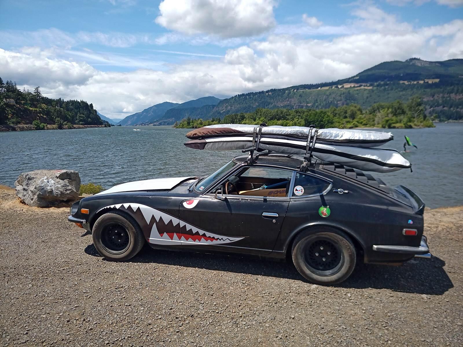

May 11, 20222 yr comment_640269 that roof rack is ridiculous though, who the hell puts that on a sportscar Link to comment https://www.classiczcars.com/forums/topic/67462-amco-front-bumper-bar-for-71-240z/#findComment-640269 Share on other sites More sharing options...
May 11, 20222 yr comment_640295 I liked the roof rack, a very cool item from that period. Link to comment https://www.classiczcars.com/forums/topic/67462-amco-front-bumper-bar-for-71-240z/#findComment-640295 Share on other sites More sharing options...
May 12, 20222 yr comment_640304 21 hours ago, bartsscooterservice said: that roof rack is ridiculous though, who the hell puts that on a sportscar How else do you carry your windsurfing equipment to the beach Bart? Works well on mine! Link to comment https://www.classiczcars.com/forums/topic/67462-amco-front-bumper-bar-for-71-240z/#findComment-640304 Share on other sites More sharing options...
May 12, 20222 yr comment_640305 lol yeah, for a rat okay, but I would not put a roof rack on a restored z lol Link to comment https://www.classiczcars.com/forums/topic/67462-amco-front-bumper-bar-for-71-240z/#findComment-640305 Share on other sites More sharing options...
