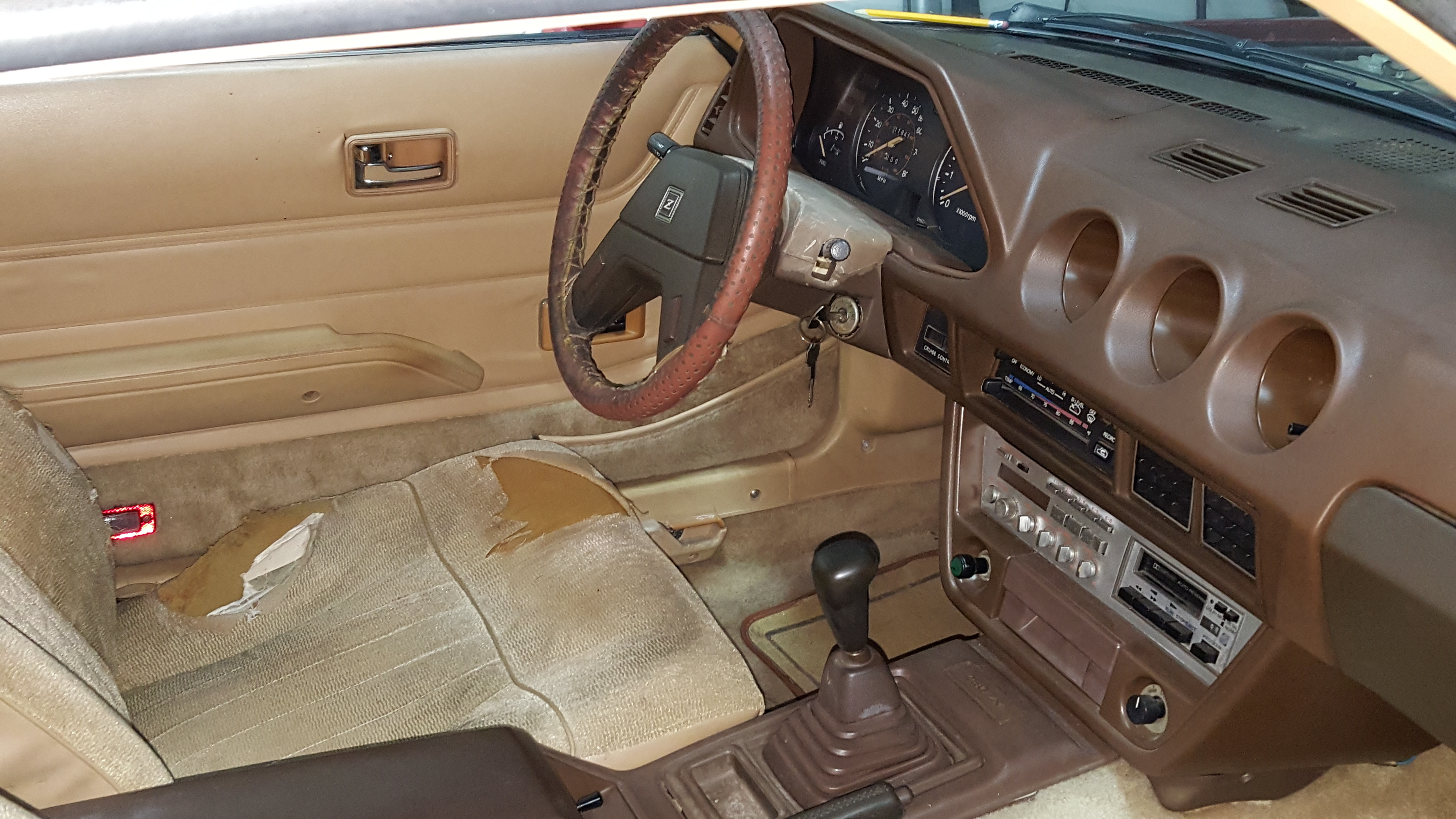

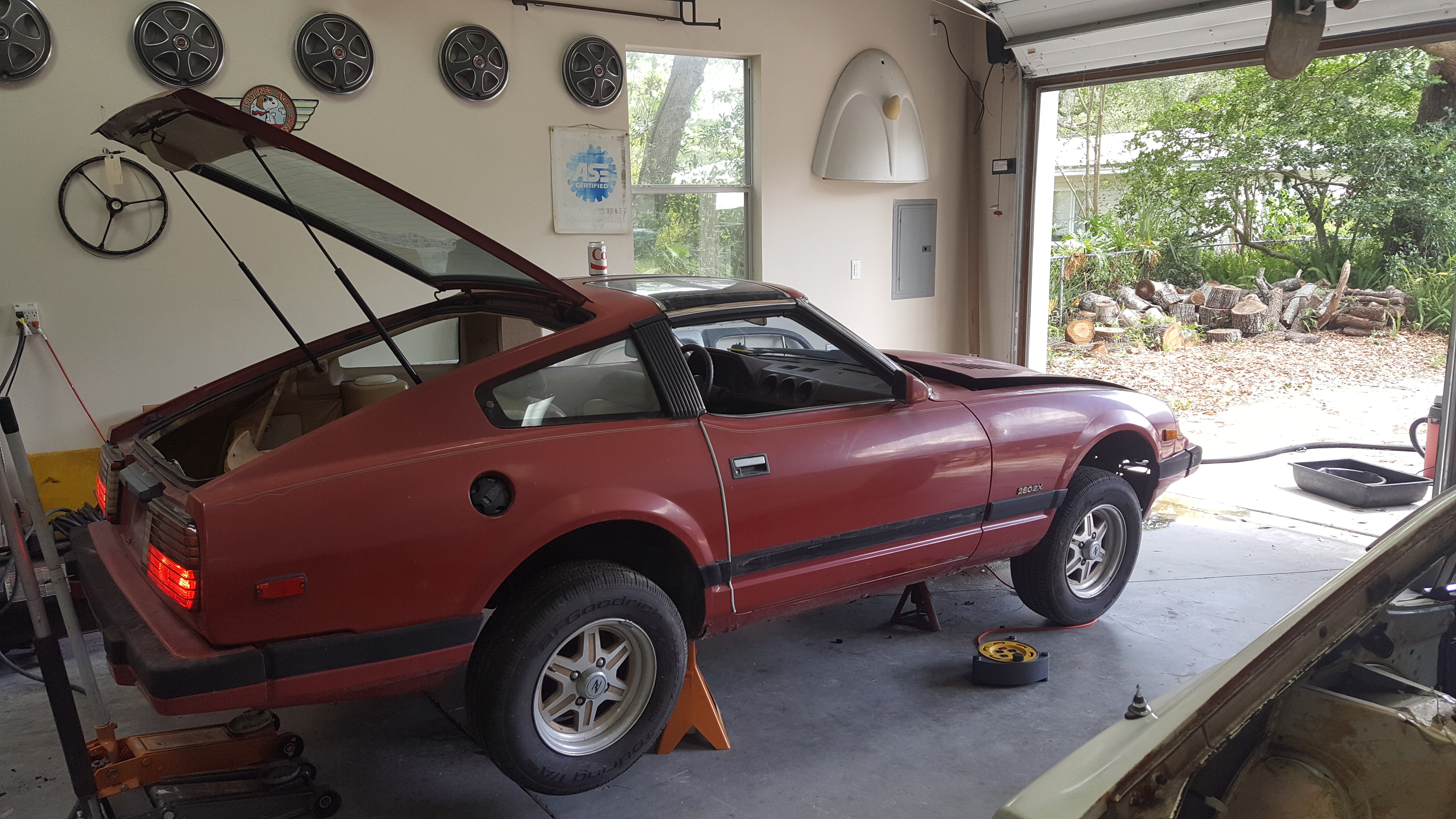

Added a few pics, just for SAG's. Driver seat is the only thing really bad with interior, everything else was nice. A tiny hairline crack in dash, thats it.
