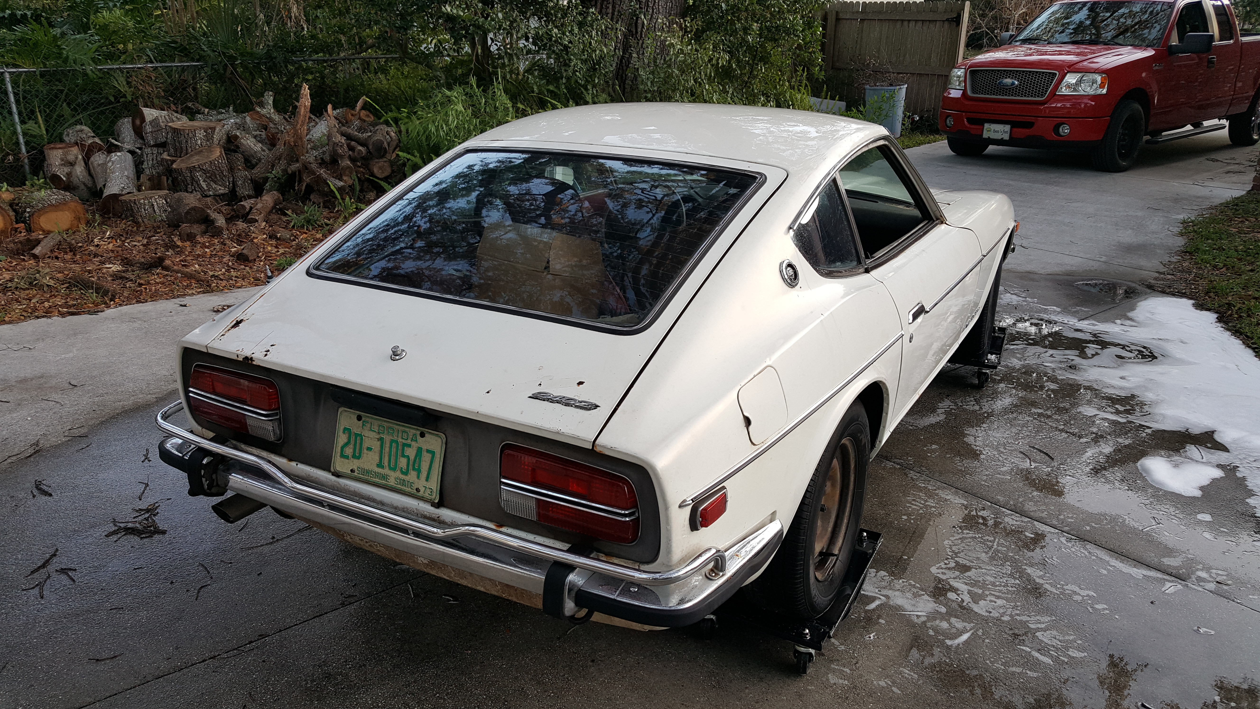

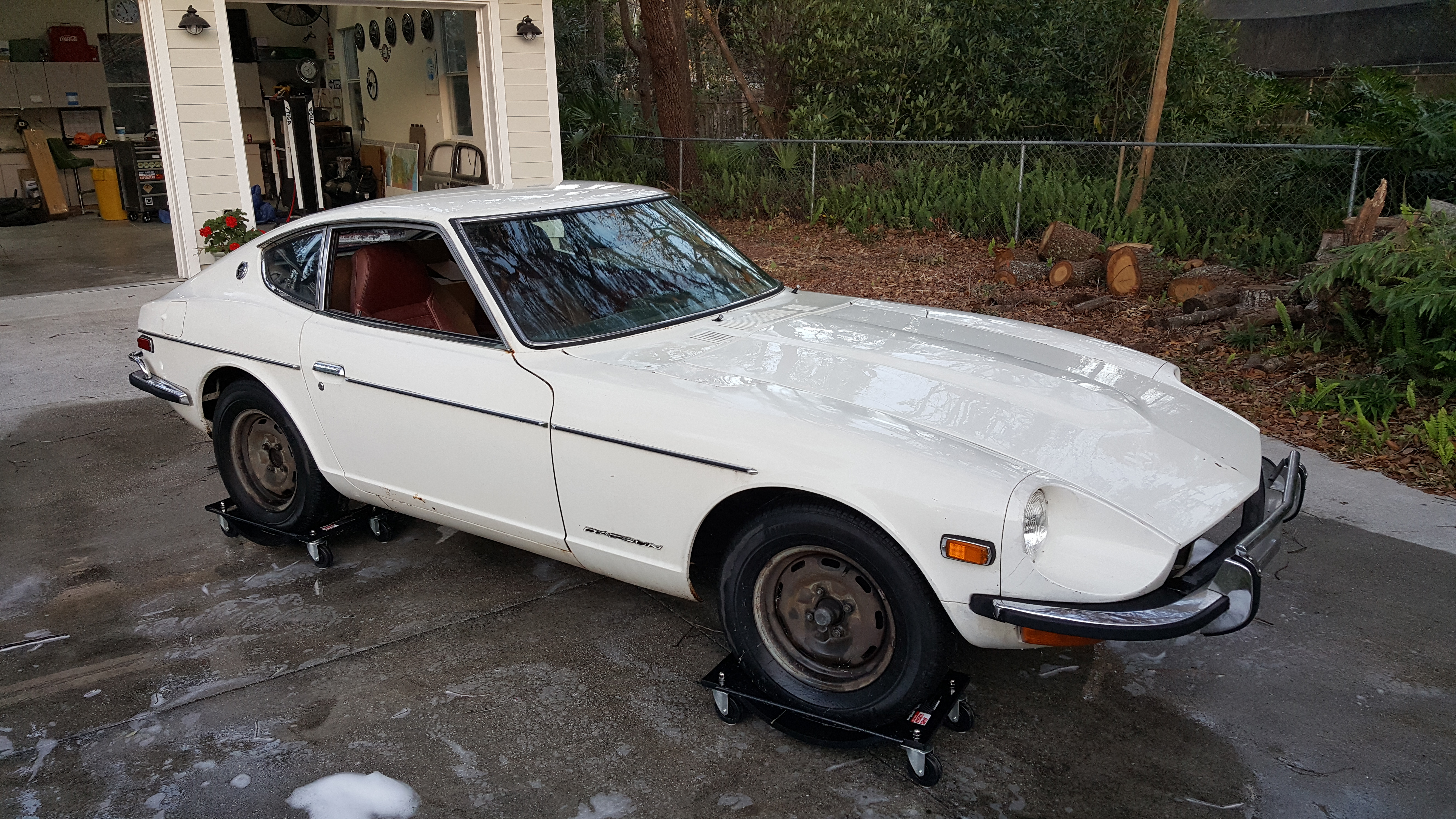

@DC871F What's the story with the white 240 you have hiding in the back ground?  Looks like its in very nice shape.
73 240, in the middle of restoration. Very low miles, all original. The ZX was a side diversion, that turned into a mini project. I have had a few 240's back in the day, then I got into ZX's about 20 years ago. So when I found the 82 sitting and wasting away, I remembered how good the ZX's were and couldn't resist. They are not a 240, but a great car in there own right.

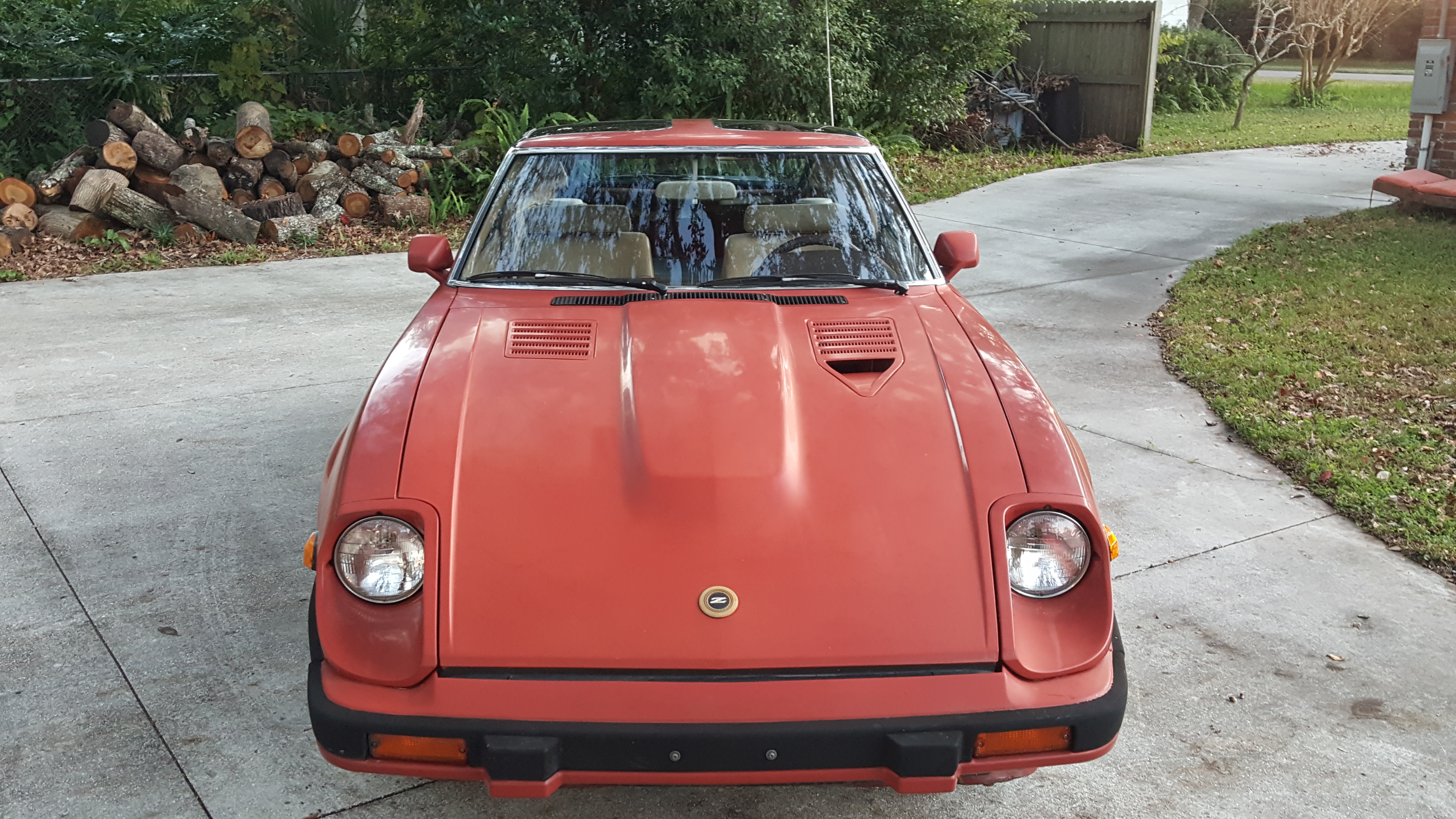

That ZX will be a beauty when you buff the paint up.
240 looks good too!  I was gonna ask about the scallop hubcaps hanging on the wall but now I see where they'll be going.
