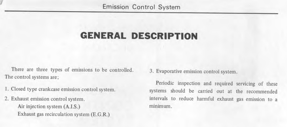

I think that "positive" crankcase ventilation came later. Where the system was designed to move air through the crankcase. They just called it "closed ventilation" before then. Meaning that the crankcase was connected to the air intake system instead of open to air. Anyway, wherever the exit from the crankcase ends up there will be oily gases at times.
