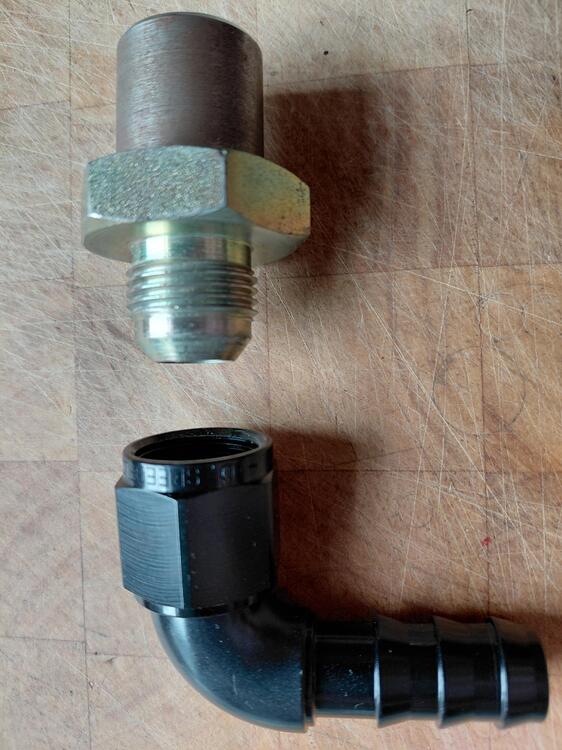

I don't see the need to add an AN fitting to a welch plug, as the machined AN fitting can fit. I found the fitting, it was machined too much and hence given to me. Its steel, but my friend has an aluminium AN fitting. The black AN is a speedflow one, which I think is Australian brand, and I am unsure where the steel one came from. The threads one side are just machined off the large fitting. Obviously its a reducer fitting to aid your search.

@RIP260Z So if I understand correctly, The fitting in the pic was originally the same size as the”Welch”plug. Forgive me if I misunderstood. Seems extremely large. Thanks for the input.
The machined back part, behind the hex, is a tolerance push fit into the block. Yes its quite large, but its alot less protruding the standard pipe. If wanted, the hex could be machined down as well to become just oversize of the block hole, for a slimmer looking fit.
