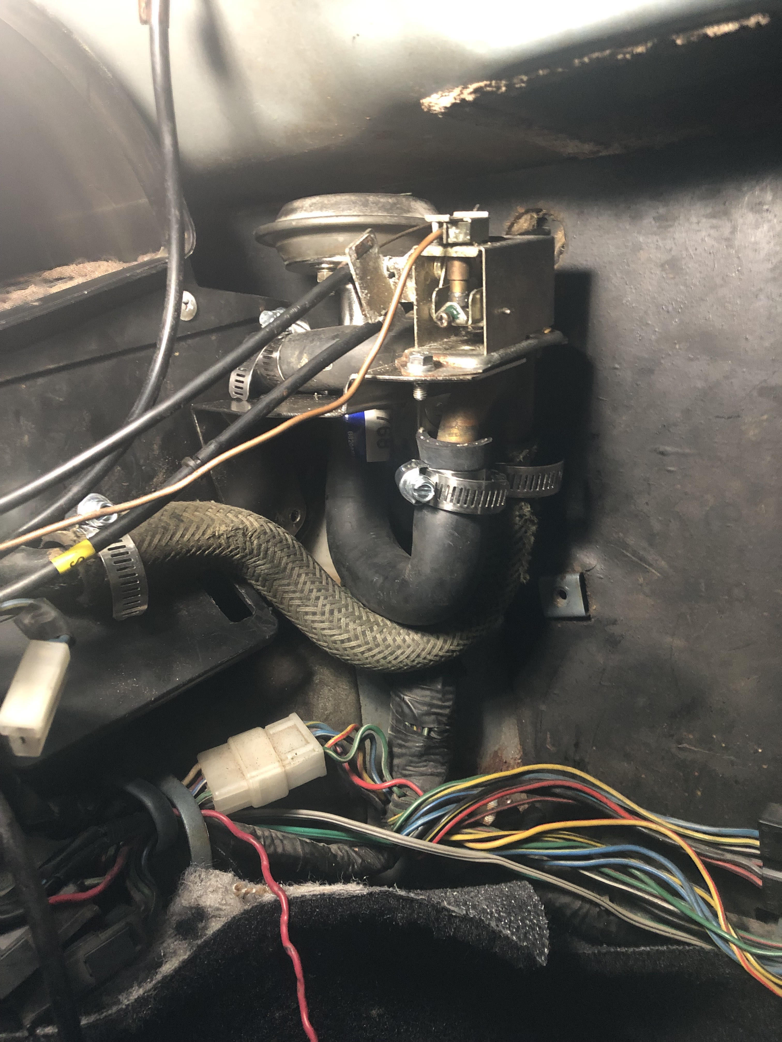

I have noticed when you move the temp cluster knob from cold to hot the steel cable under the instrument panel bends and create issues. Is this known? anyway i had to put some WD-40 on the heater valve and its seems to go UP/DOWN. There is no real rust around it just some slight white calcification i believe.
I am nervous to get the system filled up. Hopefully nothing leaks. The L hose that goes from vacuum co*k to heater core is so tight i wont be able to reach it without again draining the entire system if it leaks. Hopefully not.
One more thing, the new vacuum co*ck has a slightly different orientation for the vacuum tube to connect and I am falling short. Is there a place where you can get the extra foot of this vacuum tube and possible a connector to extend it?

2 hours ago, Yarb said:
I would pressure check it first if you can. Those calcium deposits you mentioned might be from a breach in the system.
How do you do that?
