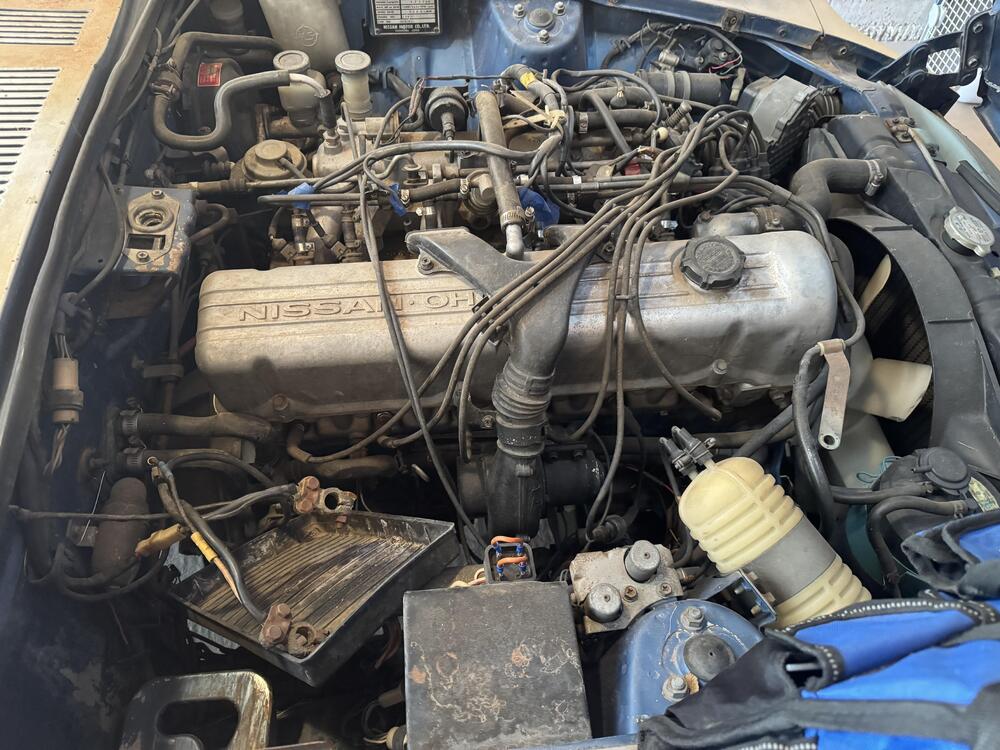

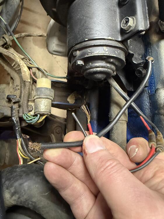

Im trying to clean up some wiring in the car and I have a ground cable and some wires to a blower? im not sure what it is. Would someone be able to point me in the right directions. I dont see any obvious locations for them.
Not a very good pic of the blower but it reminds me of the 280ZX "Hair dryer" fan they used to blow on the fuel rail / injectors. Every turbo ZX had one. So do I, It's just in a drawer... Some people thought it was an answer for vapor lock.
If that's what it is, you'll never find anything about it in a 280Z FSM from any year. And a pic of the entire fan assy. would make identification incredibly easy.
Edited by cgsheen1
I think your right about it being the hairdryer, it does have plastic piping that exhausts over the top of the valve cover. Would it be worth just removing it altogether?

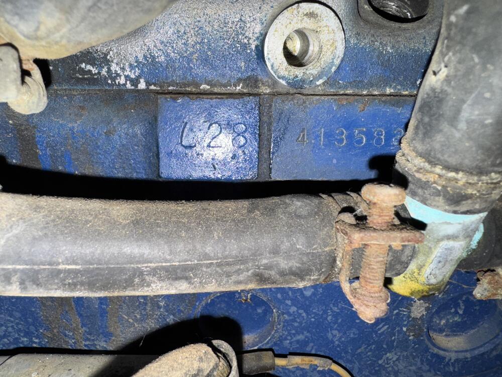

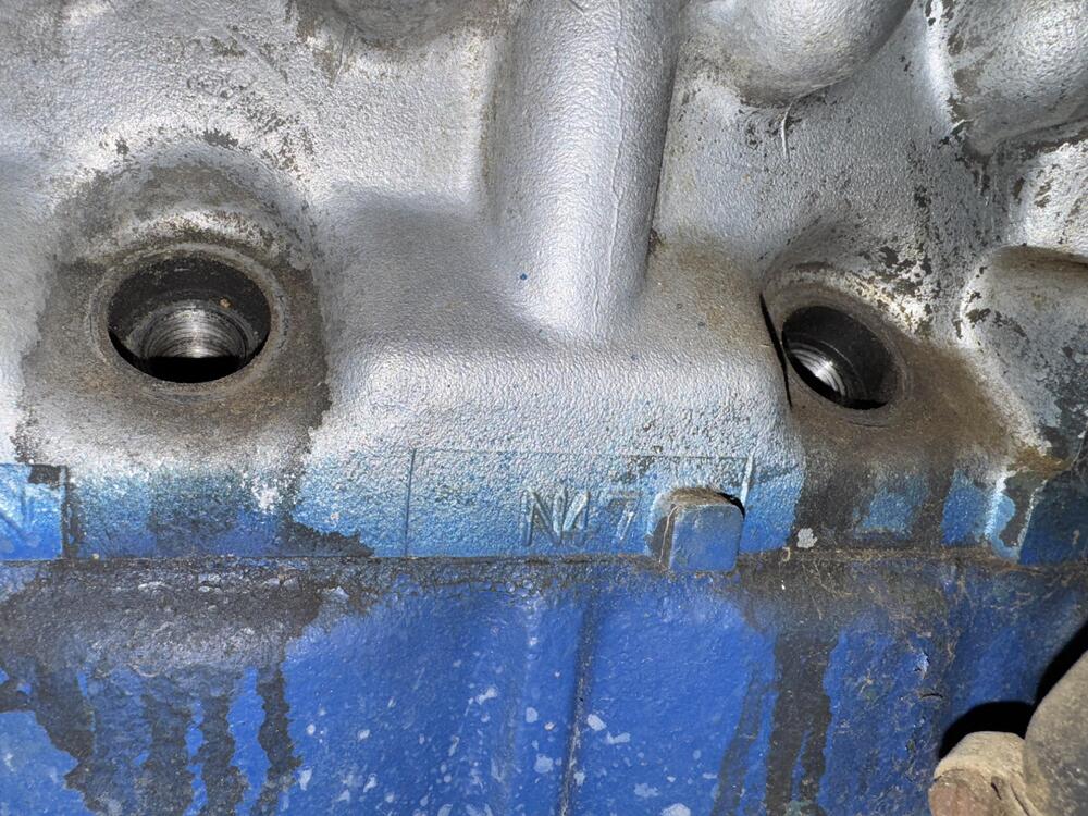

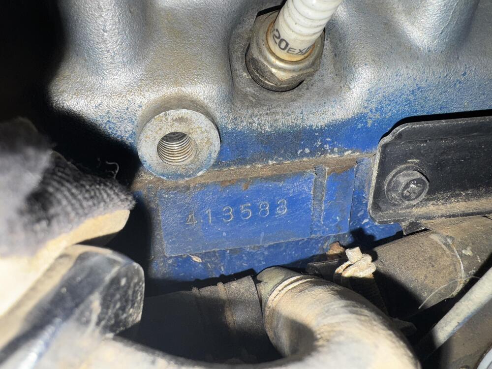

If these are only found on 280zx turbo cars, could it be that I have a turbo head on this car? My reading material says the p90 was the turbo
Edited by nowak1981
