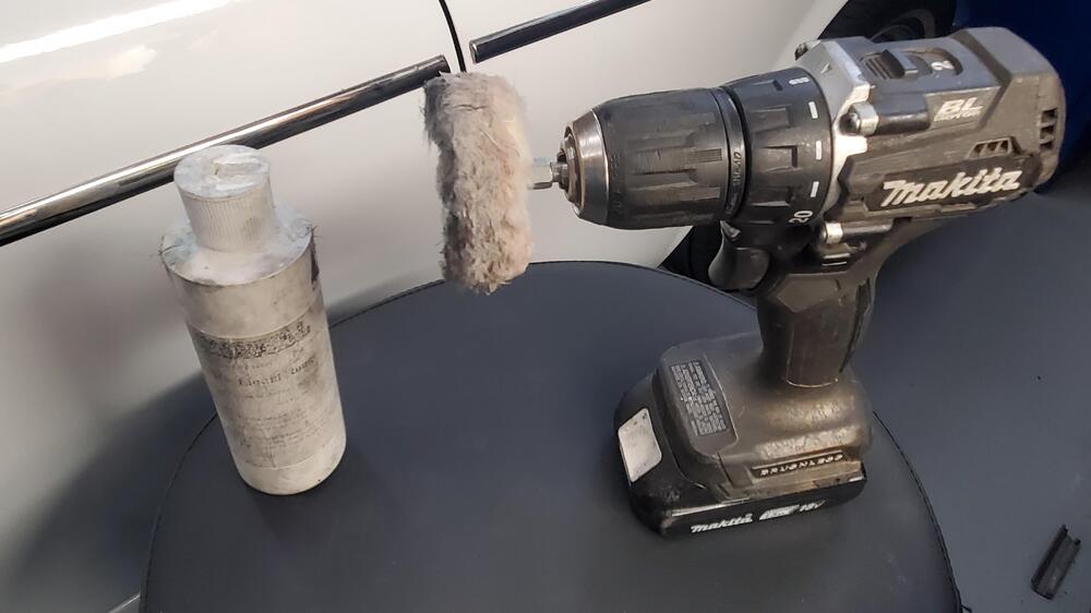

1 hour ago, Patcon said:
What was the technique for the choke knob?
A cloth buffing wheel with fine polish compound on my hand drill. I will show a picture tomorrow.
I have a bench mount buffing wheel as well that I use to polish all of the window frames, but the knob is too small for that.
Here is picture of what I used for the choke knoh polish. Bottle is Caswell White Liquid Rouge.
