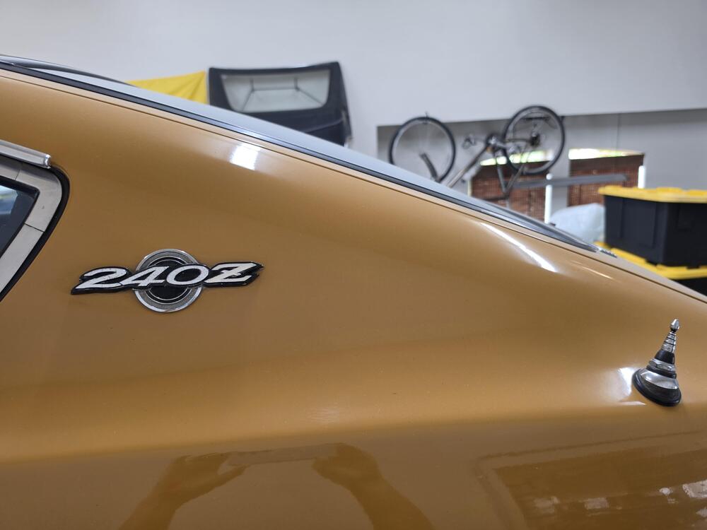

3 hours ago, dspillman said:

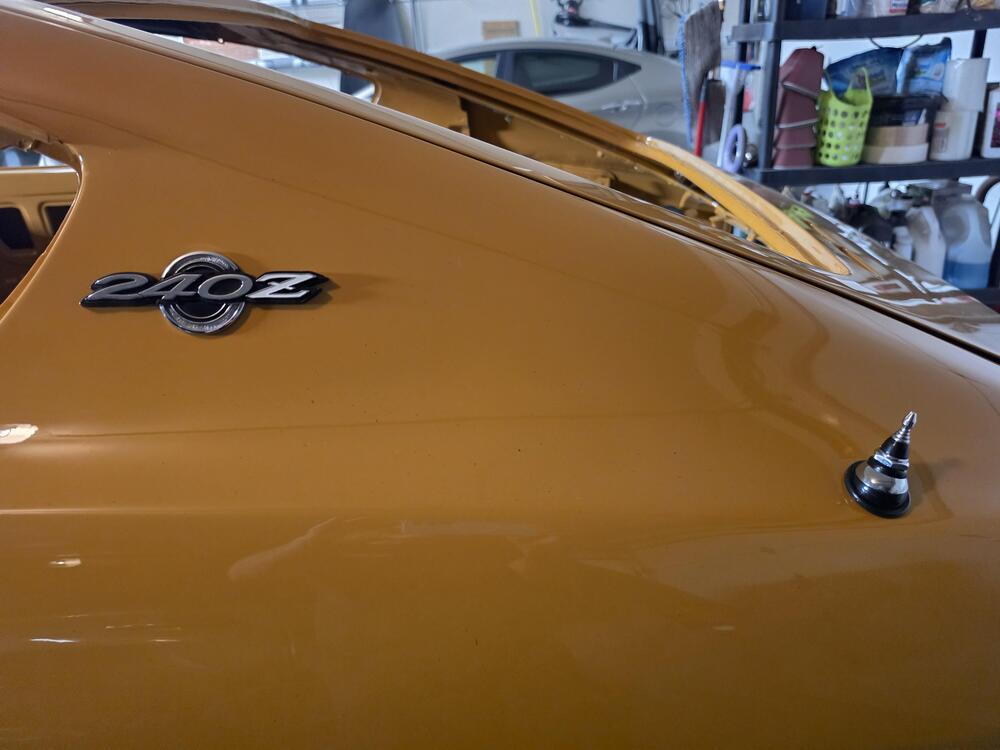

Yall gotta find the right emblems for a build of this quality
My mistake, was just grabbing parts our of boxes. Will correct this.

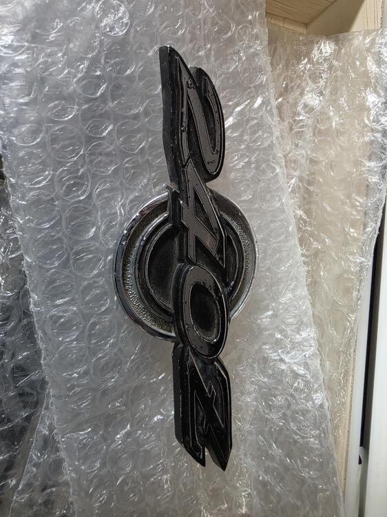

Very interesting with these badges. This is new to me. I am wondering when they switched over from the solid chrome Z to the painted white Z on the C pillar emblem. I checked my 4/70 build and it has the white Z. Pretty sure these are original based on the minor chrome pitting and paint fade, and I don't think me or my dad changed them. I do have one emblem with the chrome Z but it is pitted. Guessing these will be a bit hard to find.
I had Vin 1222 1/70 car years ago, and it had the chrome Z on rear quarters and rear hatch….latest one I’m aware of. The super early double digit cars came with the solid back chrome z emblems. “ 2 different chrome z versions….”
Edited by dspillman
Detail

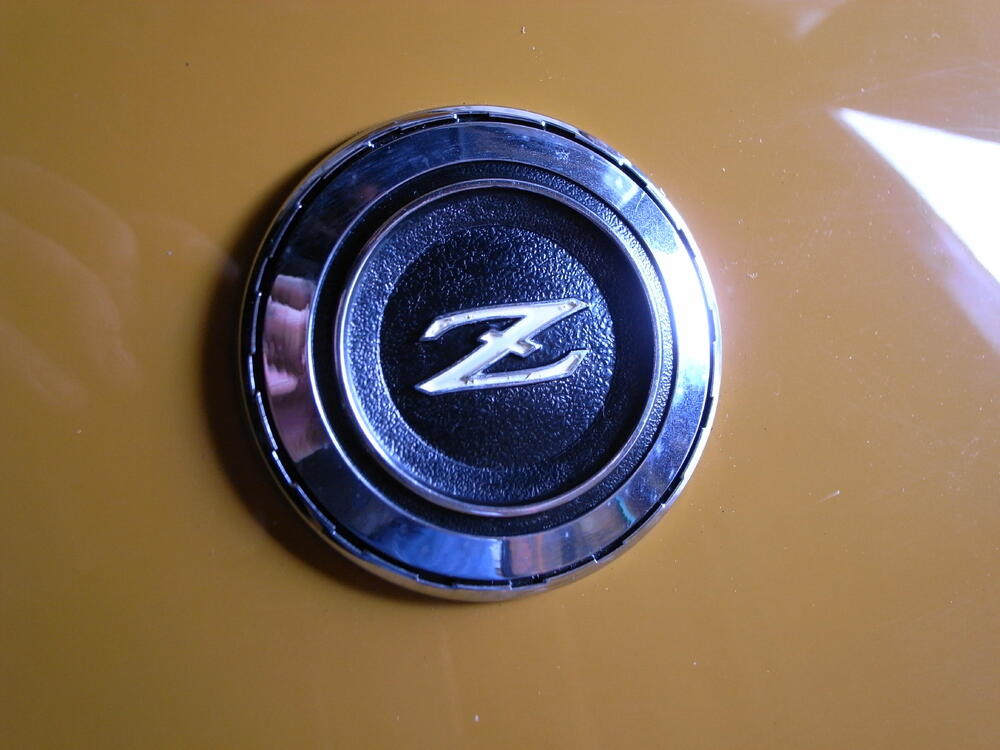

The early production changes to the '240Z' emblems are a legacy of the late decision to change the naming of the Export variants. Japanese market 'Fairlady' variants received a round 'Z' script emblem on their quarter panels which didn't change until the universal vented 'Z' quarter emblem was introduced. That design pre-dated the '240Z' emblem...
In retrospect it's hard to understand why the Japanese market round 'Z' emblem could not have been used on all variants - Domestic and Export - until the vented emblem switchover. The '240Z' emblem, to my eye, always looks a little incongruous in that location. Too many angles and sharp edges in conflict with the swooping and flowing lines of the body. Round 'Z' script much more harmonious.
HS30-H,
Did early (pre 1971) non-US variants round 'Z' emblem have the rear facing indentation and "L" or "R" marking on the rear side?
Thanks,
Keith
3 hours ago, zed2 said:
HS30-H,
Thanks,
Keith
Hi Keith,
Remember that this is about Japanese domestic variants (Fairlady Z, Fairlady Z-L, Fairlady Z432 and Fairlady Z432-R) with vented tailgates and non-vented quarters, not "non-US" variants.
No rear-facing indentation (because it was not a vent...) and they fit flush to the body all round. They are assymetric (to fit the body) and oriented L and R with the letter cast-in, and - like the bonnet/hood 'Z' emblem - have an arrow pointing UP.
An upside-down 'Z' just won't do...!

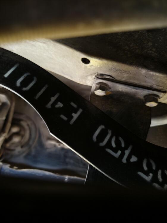

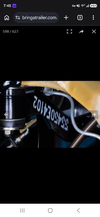

I need a little help from the experts here. I am ready to stencil the part number reference on the mustache bar. I thought I had taken pics of it, but cannot find it. Maybe I accidentally deleted it. Anyway, my guess is that it is 55450 E4101, like my SN O2614. Does this sound correct or is it different? I noticed the S30 car ended in 4102.
Edited by motorman7

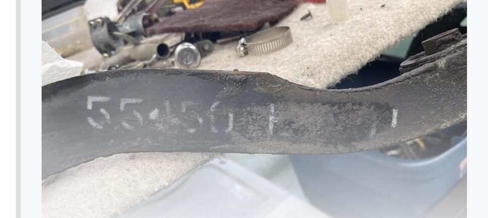

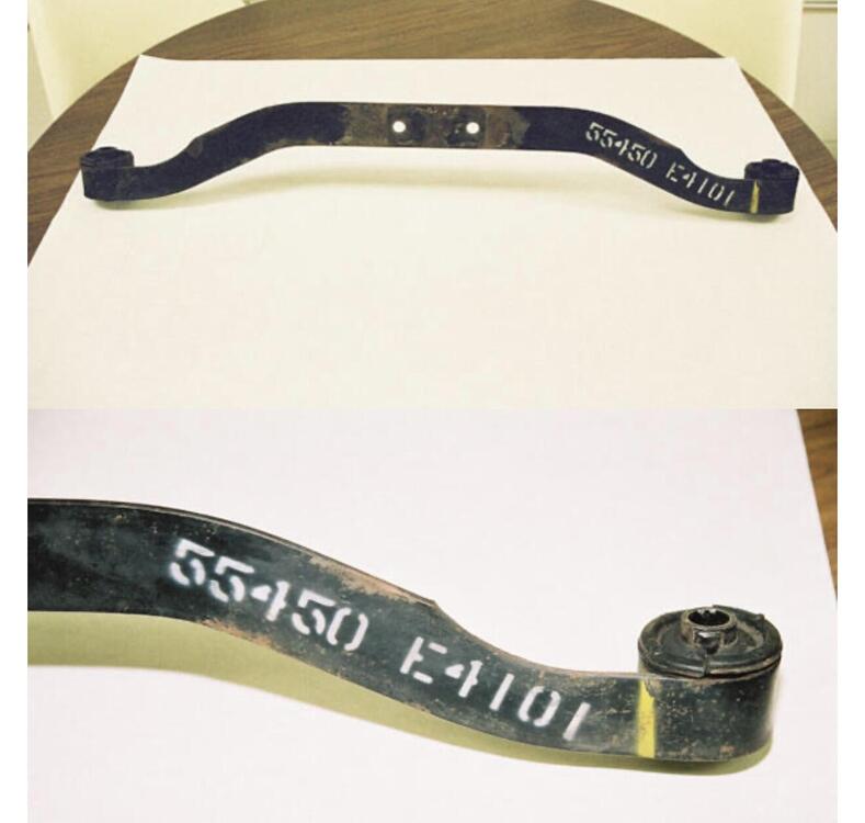

From my “vin 51 Oct/69” thread…. Chris shared pictures of 26/27 and my remnants of number show 4101IMG_4648.jpegIMG_4649.jpeg
Edited by dspillman
Awesome, thanks! I was a little concerned that it might have been 4100.
There wasn't an E4100, started w/E4101
