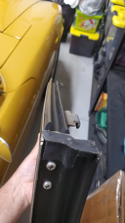

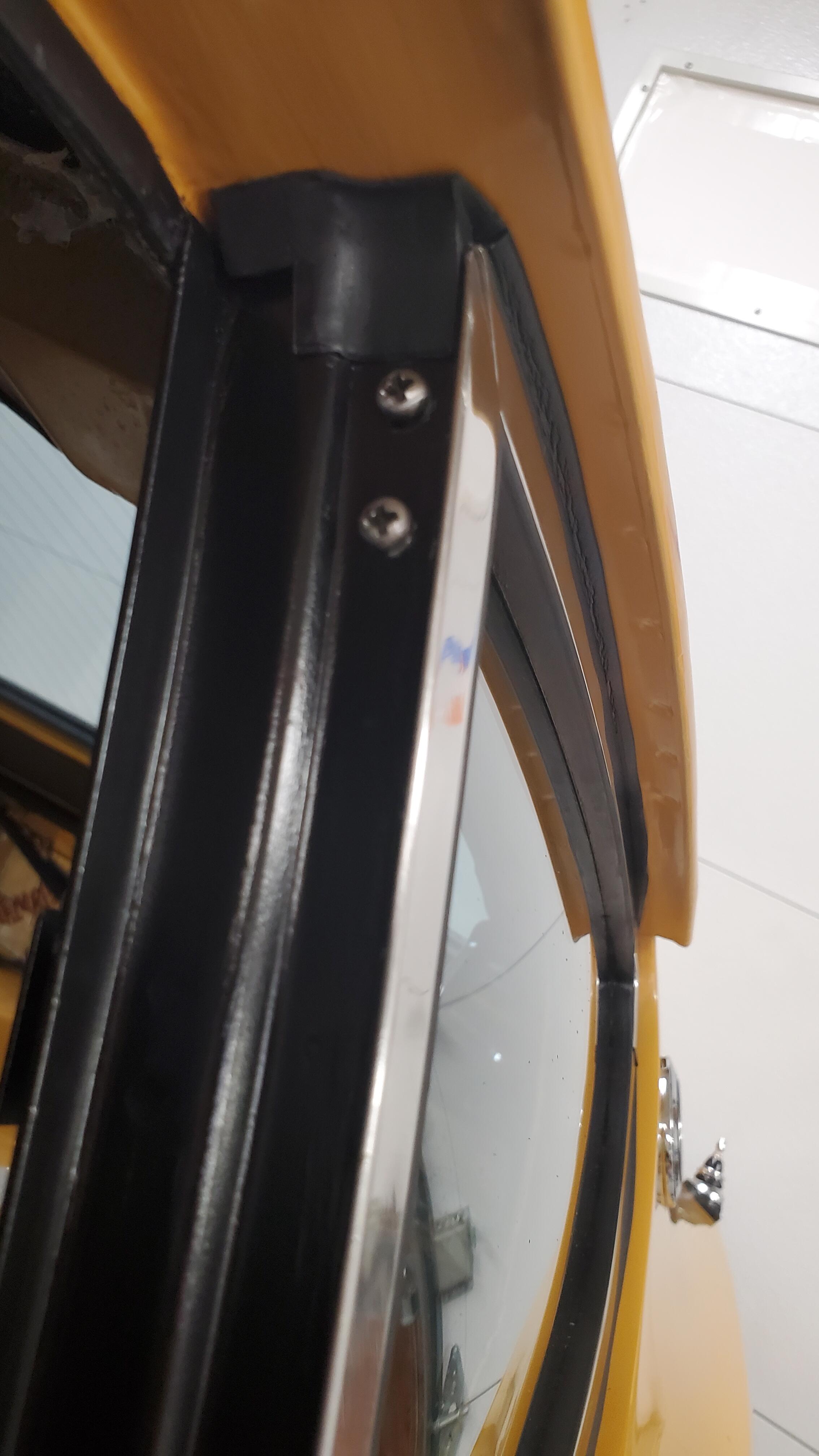

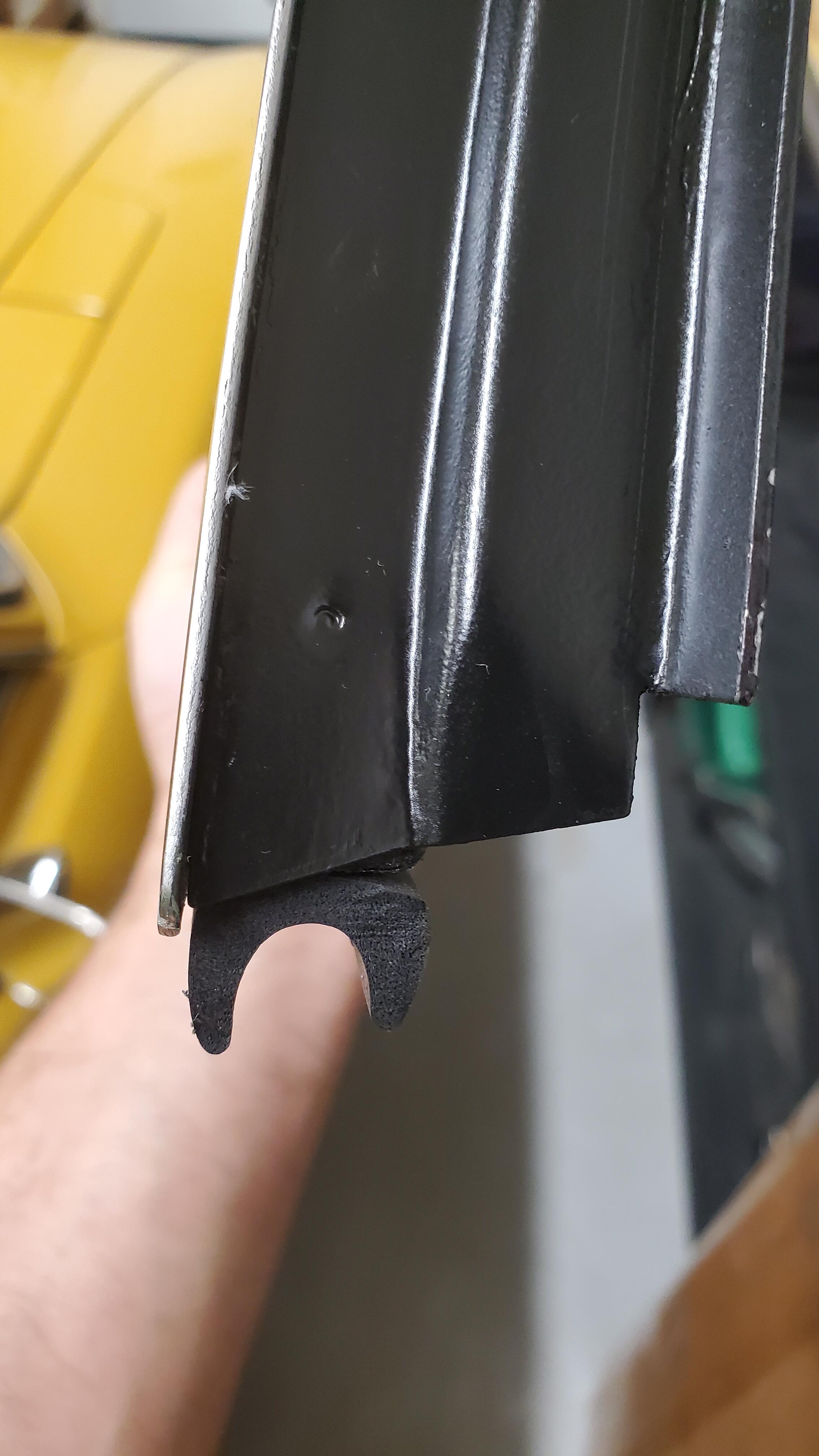

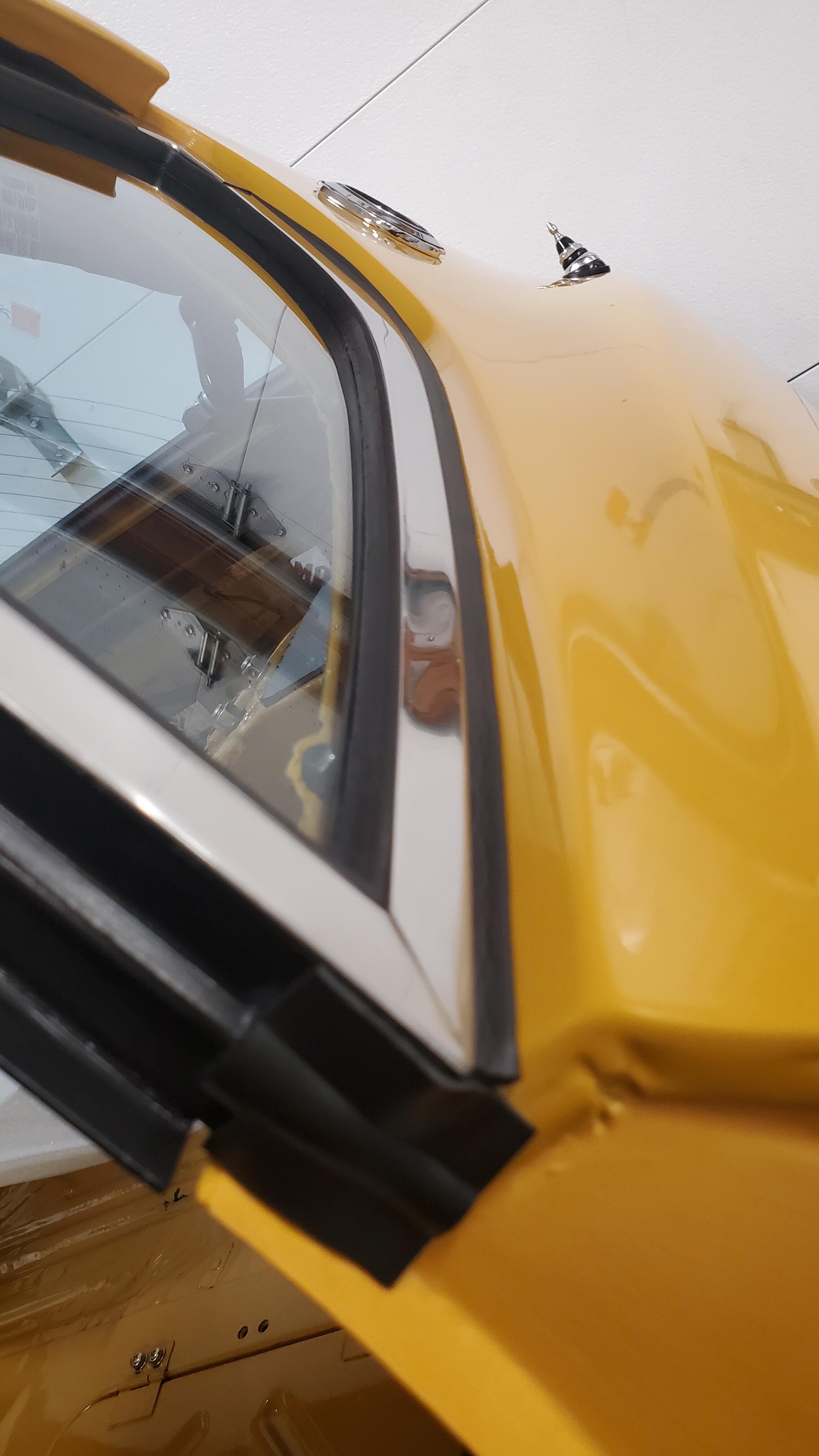

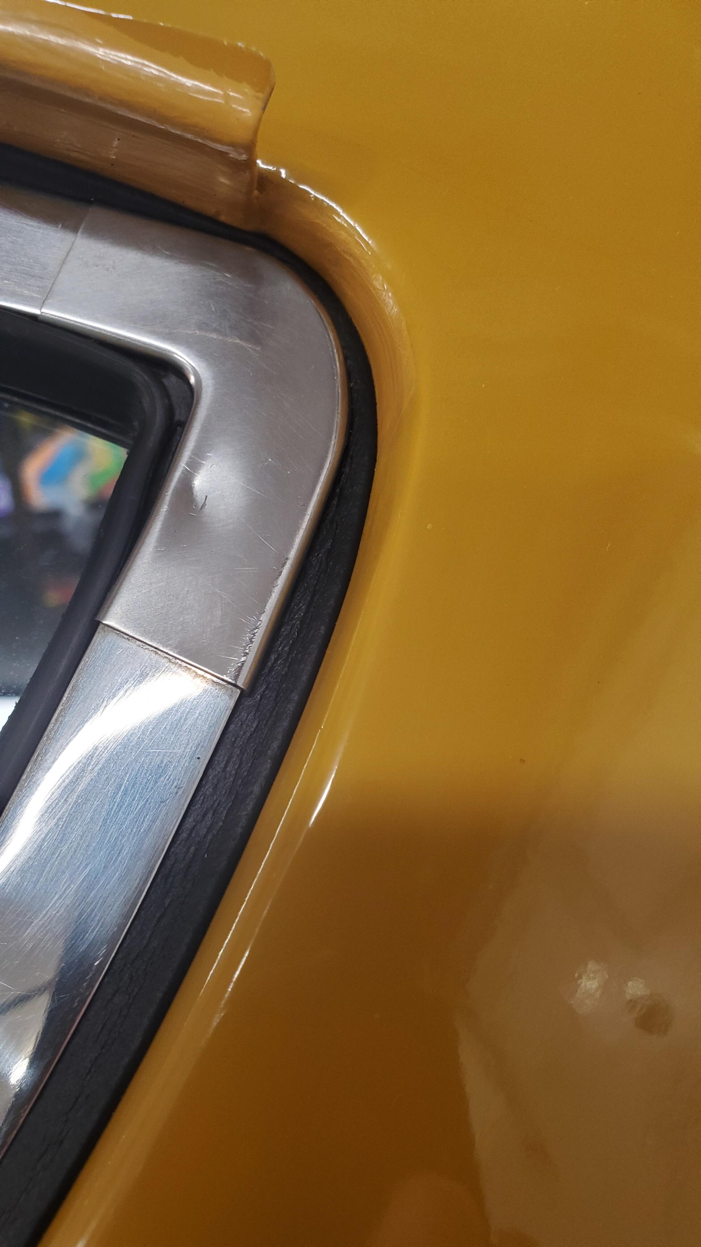

I literally just finished the driver side yesterday and here's some pics.  The precision rubbers work great if you are patient and steady.  You won't break the glass if you apply even pressure inward and towards the rear at the same time.  i was able to do this by myself put using one hand to press on the glass and the other to set the screws by reaching around.  The trick is as mentioned, set the glass about 1 inch or so forward of the screw holes and the trick is to get the corner peice set first.  Only set enough screw to catch them move on to the bottom back then two front.  Remember to only set the screw enough so it catches at first then move on to the remaining screws so you have wiggle room to move it until all 4 are caught then you can easily tighten down.
