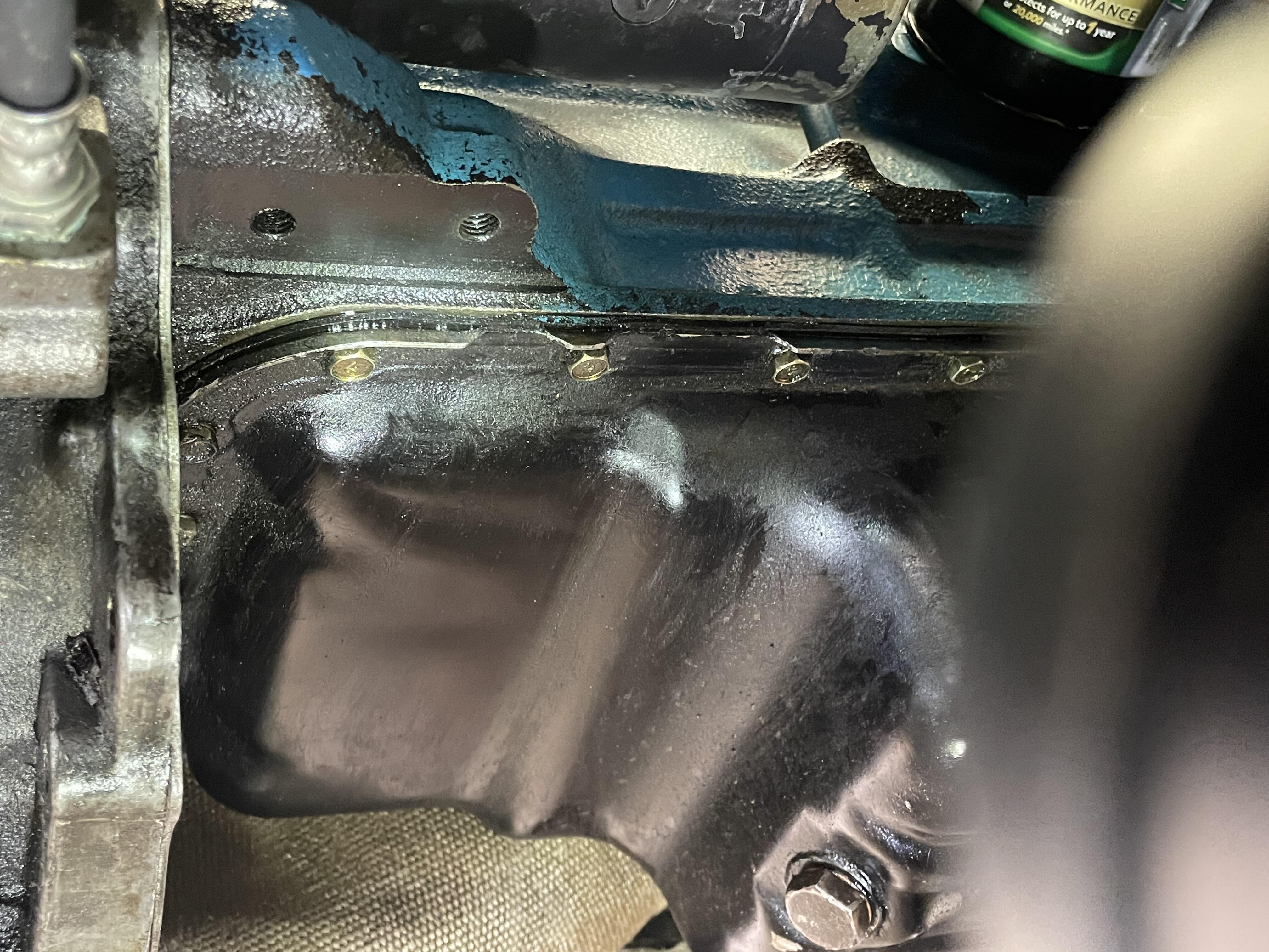

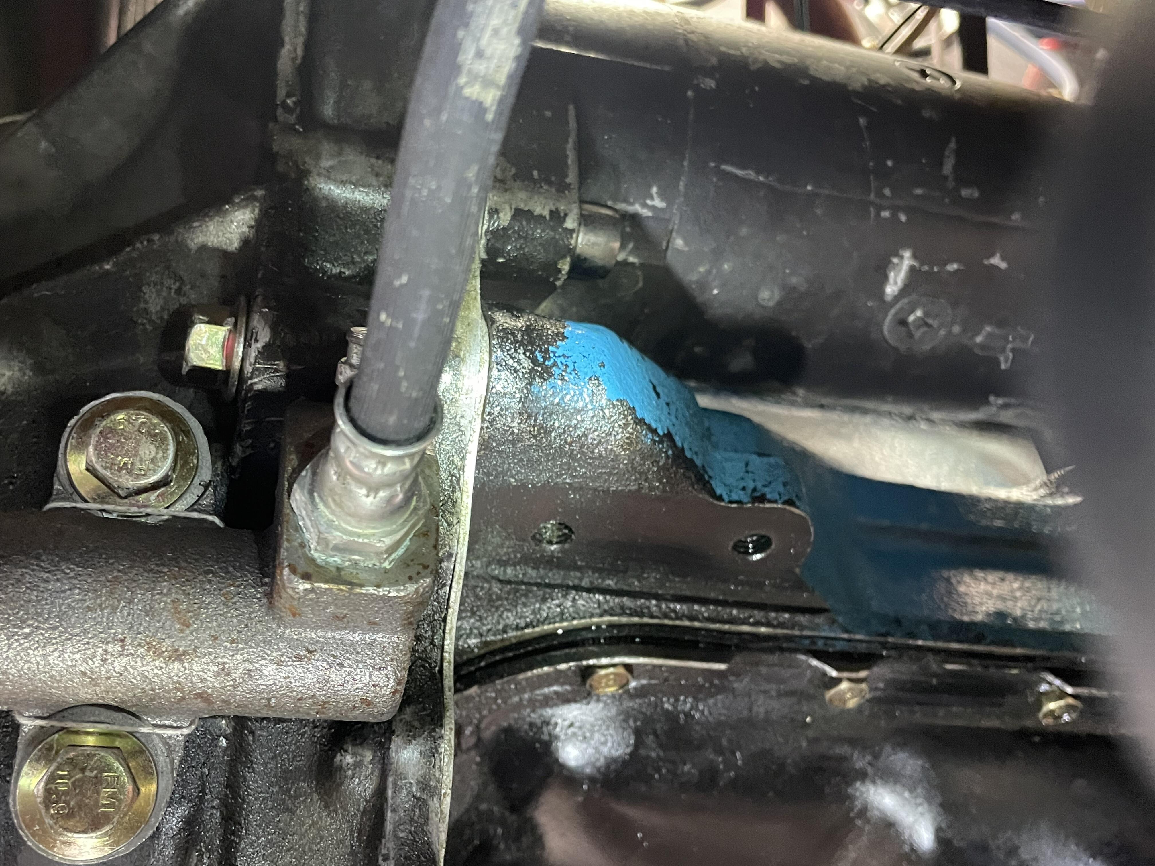

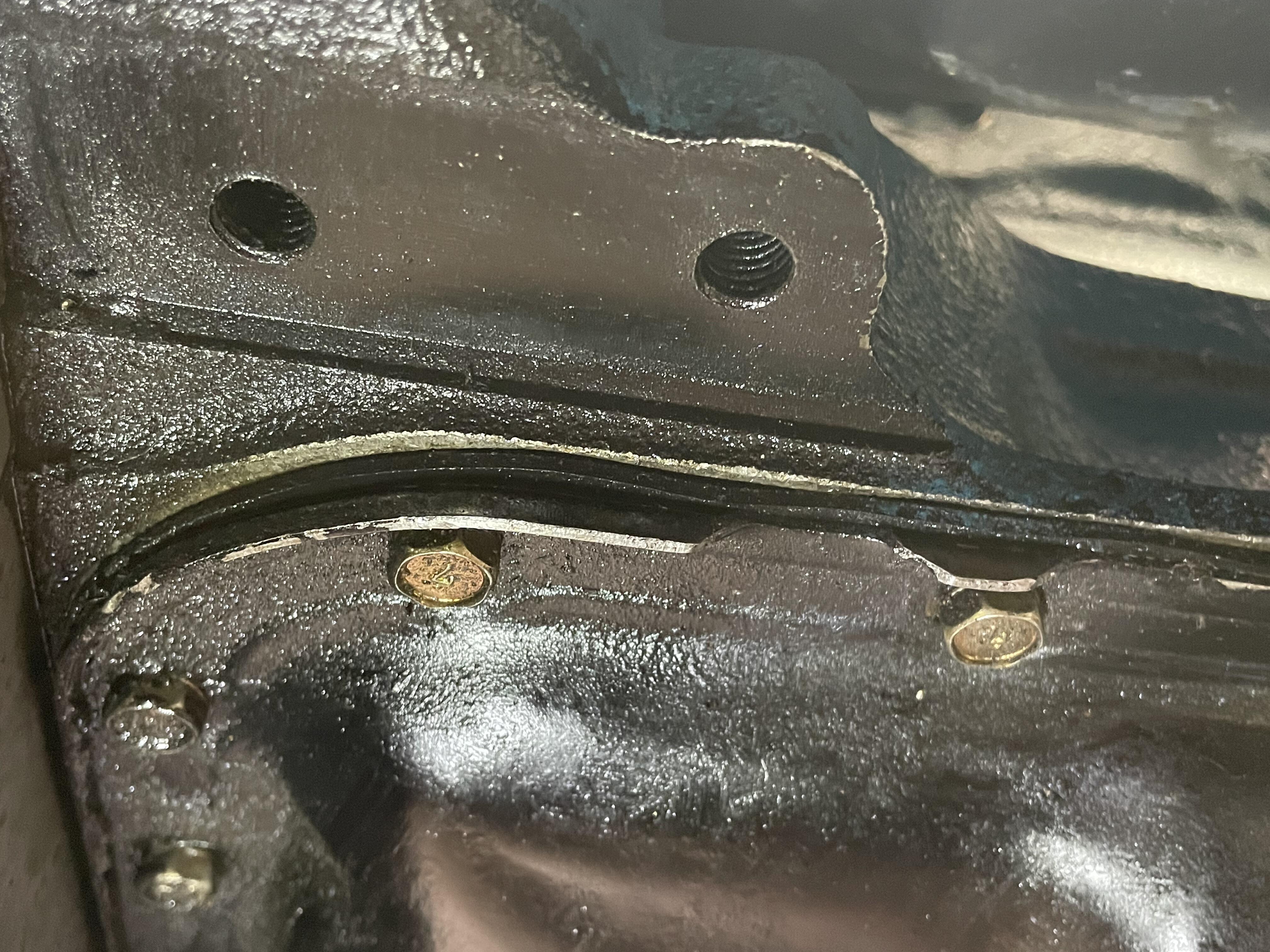

I took a look under the car. I see oil seeping through the oil pan gasket, and gear oil seeping through the bell housing where the transmission mates with the engine.
at this pint I’m pretty sure seals and gaskets need to be replaced.

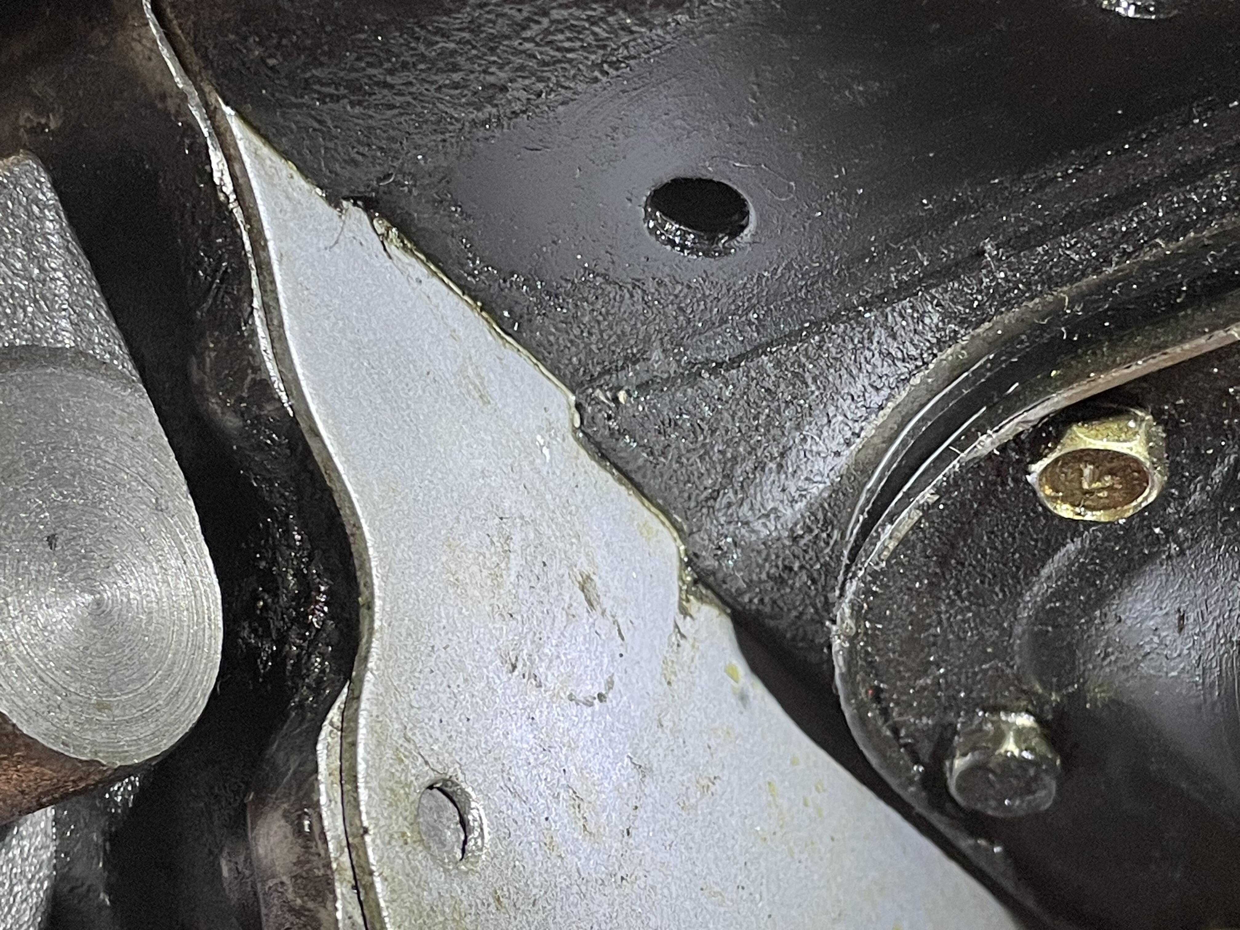

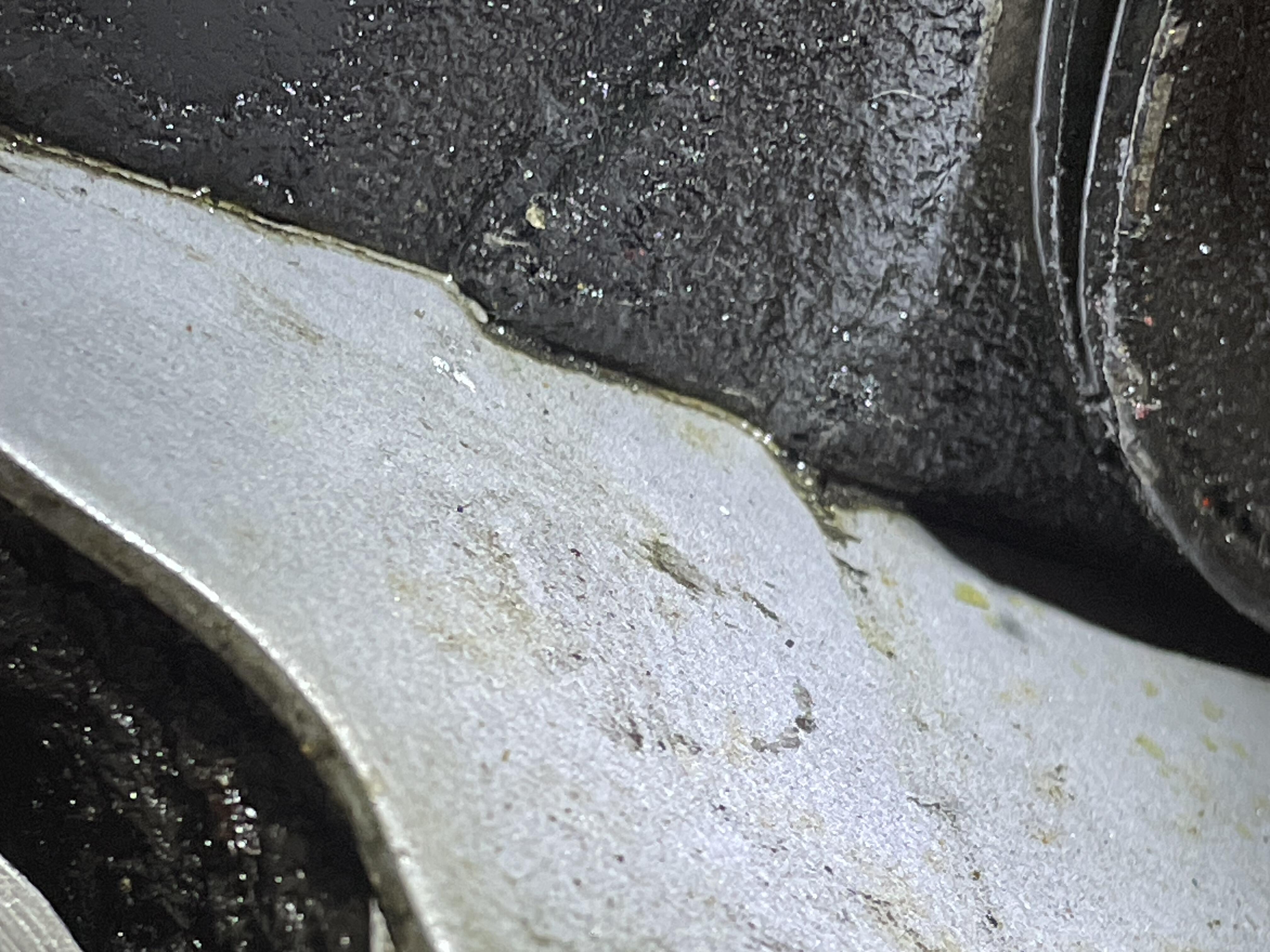

I do see it’s wet in these two areas, where dust cover connects into the engine black.

Go buy some gunk degreaser and clean the bottom area. Either way the transmission needs to come out to do any of the repairs needed. Common problem. Better to drop it and everything will become obvious
The pan holds engine oil and that's a common leak point as is the rear main seal.  When the RMS (Rear Main Seal) leaks, the oil will come out all around the dust shield and drip out of the weep hole of the bellhousing.  If you really want to know, you can get the car in the air on jack stands and pull the rubber boot around the clutch release fork.  With a borescope ($20 from Amazon), you can look towards the rear and see if there is a gear oil stream coming from the trans input shaft seal area.  Again, other than ordering parts ahead of time, it desn't really matter.  The trans has to come out either way.  The seals are cheap, so just replace the RMS no matter what.  The oil pan gasket can be done with the engine in and on the mounts, but it's tight.
