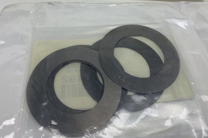

The shims came in the mail on Saturday.  They fit like they were designed for the R180.  Though the OD is bigger than the original shim/washer, it is no larger the rear pinion bearing.  They appear to be high quality/strength steel, but I don't know if I can determine conclusively if they are suitable for this application @Captain Obvious.  Probably best to still make a shim out of suitable material.
Previously, I had cut .001" shims by hand and stacked 8 of them.  This time, I rolled the dice with using 3 of these which are .005" each.  During assembly, I replaced the pilot bearing with a new one, and left out the front seal.  I torqued the pinion nut to about 100 ft lbs, and measured the turning resistance due to bearing preload at about 7-8 inch pounds (within specification).
I also swapped out the side retainer shims for new ones of the same respective thicknesses.  The old ones had a bit of rust/corrosion, so I felt it best to go with new ones.  Here are my results:
  • With the side shims in their original locations (.3 mm or .0118" on the left side and .4 mm or .0157" and .5 mm or .0197" on the right), I measured backlash at .012".
  • Moving the left shim to the right side flange, I measured backlash at .005" which is within the factory specification of .0039" to .0079"
That... is pretty exciting.
Basically, each time I "push" the pinion gear closer to the ring gear with shims (a total of .015" so far) the backlash as been reduced.  Now, the question is, do I disassemble, and add more shims to space the pinion even closer to the ring gear, and move the one side shim back to the left, or do I go with no shim on the left and the .3 mm +.4 mm + .5 mm shims on the right.
It shouldn't matter, right?  I mean, what if I add another .005" shim to the .015" thus far and get backlash that is still more than the .0079" max... and then when I swap the side shim from left to right I get less than .0039".  I kind of don't want to mess with it anymore.
