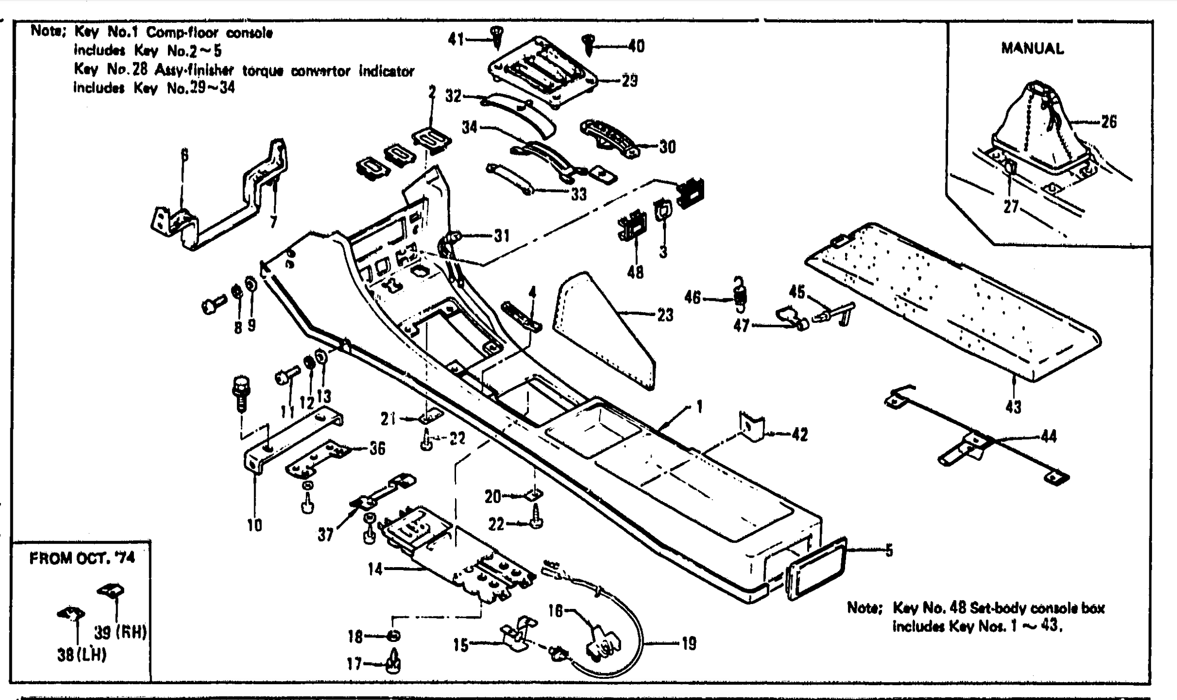

Perfect. I'm also replacing my center console with a new piece, and the original was missing all the mount hardware. I looked in the fiche - and had to 'assume' the forward screws were self tappers, since they are not described or assigned an item #
