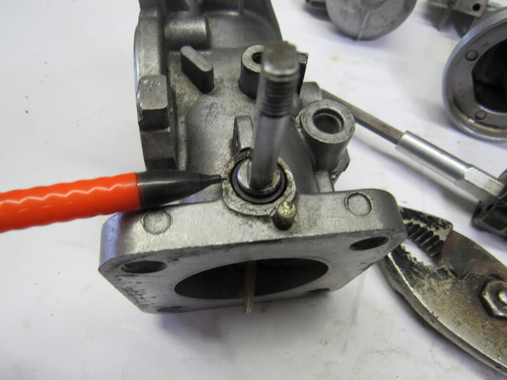

There is a fine screen filter in the banjo fitting, but it is after the main and finer filter, so just wondering if it is needed?
Has anyone found new bushings for the main butterfly valve shaft or a way to stop the air sneaking through the gap?

First Q - Depends on your definition of "needed". I've seen junk in those filters, so I consider them cheap insurance as a "last chance" filter. Would catch anything that comes off the inside of your fuel pump or the rubber hoses between the main filter and the bowl. As mentioned above, they are still available (for the round tops) and they're not that expensive. I'd run 'em.
Second Q - No. And I doubt the real issue is the bushing. I bet the problem is more the shaft than the bushing. Once you wear through the hard chrome into the soft brass underbelly, it wears pretty easily. You comfortable with precision stuff on your lathe yet?

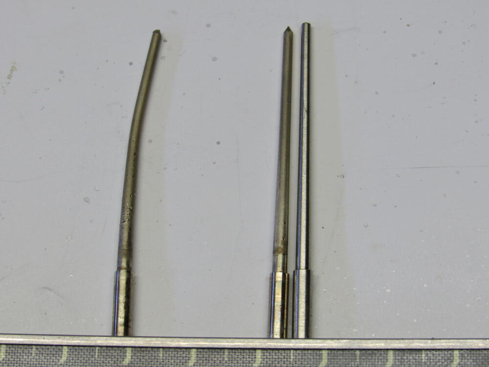

I tried (carefully and briefly) to get the needles out of those a couple of years ago when I was first proving to myself that the engine would run after sitting for 20 years. I wasn't able to get them out, but I wasn't willing to damage them, because I wasn't sure whether either of the two sets in the replacement kit were the correct profile. I did spend some time looking for the filter for the banjo fitting, without any luck. I've tried again this morning, again with no luck. I'm assuming these are from my car, of course!
6 hours ago, Captain Obvious said:
I doubt the needles in the replacement kit were the correct profile.
Noooo, don't tell me that, one of the needles got bent removing it.
Far left and middle are original, right is the closest match.
