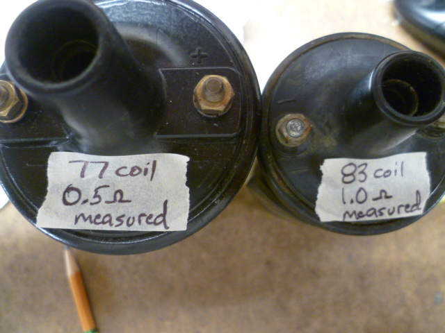

The original ballast resistor nominal is 1.3 Ohms . And the original coil spec is 0.5 Ohms. The total nominal resistance of the two in series is 1.8 Ohms. (Page EE-45 of the 75 FSM)
I'm thinking that with a 1.5 Ohm coil and no ballast resistor, you're very close to stock. You've just moved the resistances around.
And since everyone likes pics:
