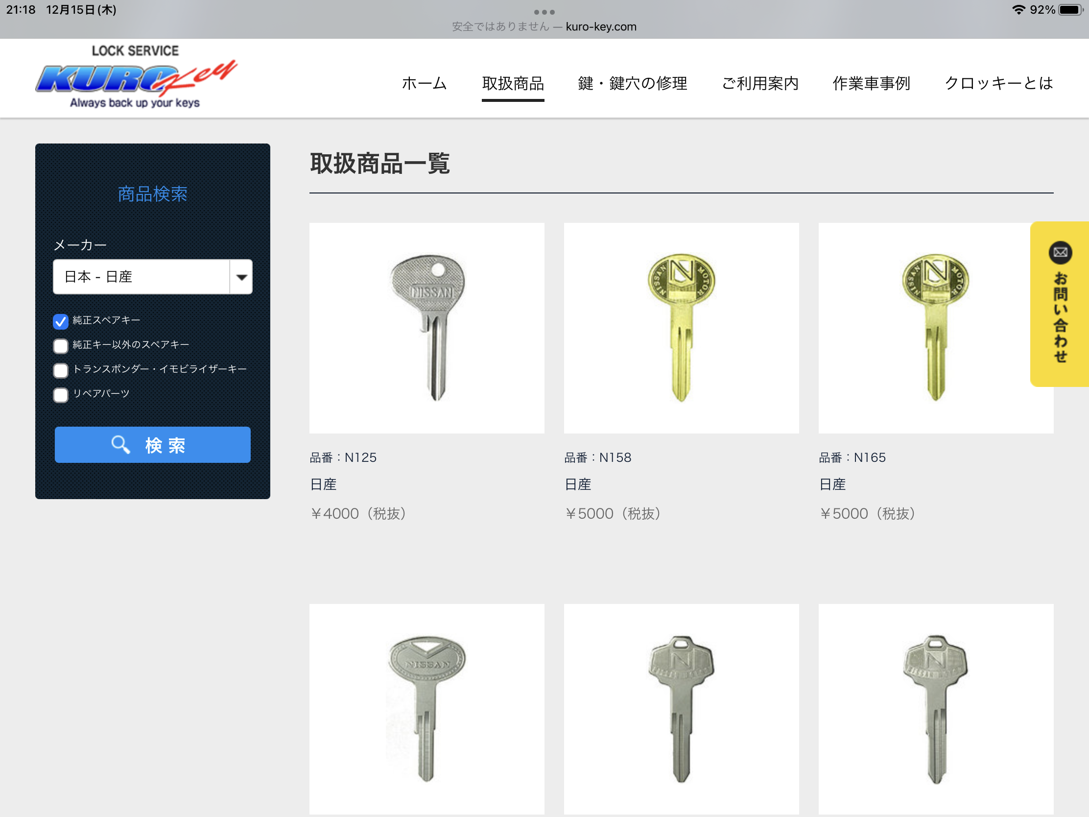

Hi, I bought a key from him a long time ago, http://www.kuro-key.com/item/?ca_category=15&icon[]=1
if he is still in business, it would be a good choice for your car.
I looked at his key very carefully with my genuine key side by side. Only subtle differences between them, I would say
no one can tell which one is which without having a genuine one in hand.

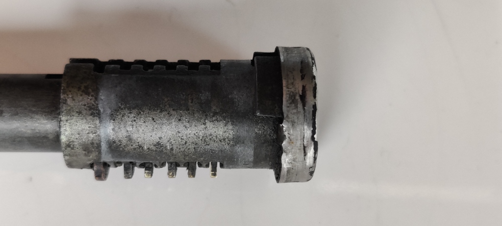

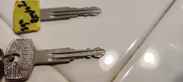

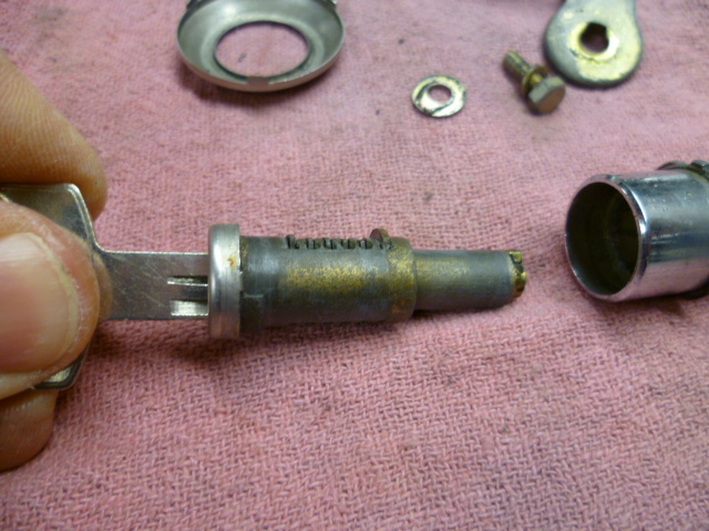

So, in the meantime, I have been messing around with some of the locks I have on hand.  After lubricating two door locks (with the same code) and a hatch lock, I was able to operate all three with a key I have (cut into a Curtis blank).  The stainless covers and key "doors" on all of these locks are in rough shape.  Curiosity got the best of me and I took the hatch lock apart and took some pictures.
What you are looking at here is the hatch lock cylinder in side profile view.  The key is not inserted presently.  Note the little bumps along the bottom of the cylinder - bottom in the picture those are "wafers", which we will see more closely in a min:

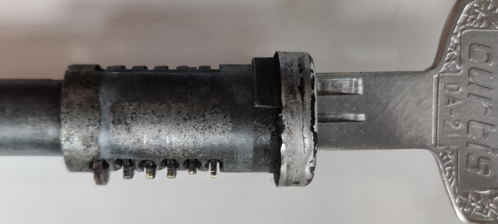

In this next picture, the key has been inserted.  Note that the bumps (wafers) have moved a bit.  The second one from the right is sticking out from the cylinder noticeably less:

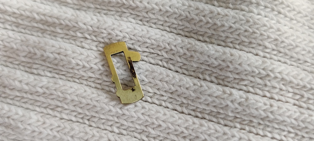

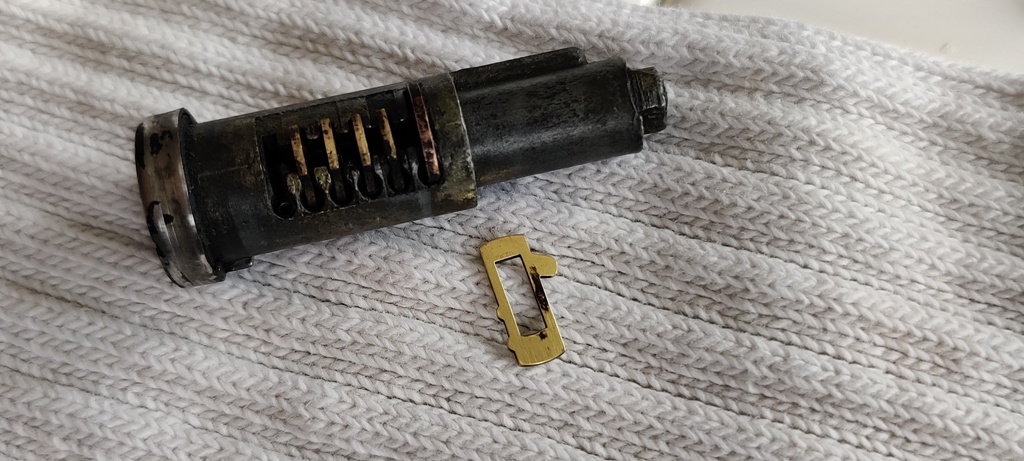

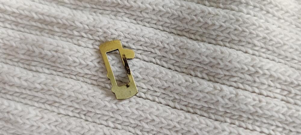

Here, I have removed one wafer.  It pushes out (snaps out) with only a little, initial resistance.
A closer look at the wafer:
I'm not sure how they differ, but one thing I suspect after looking at things closely:  The key I have, which works the lock... I don't think it is actually the correct key.  When I insert the key, the wafers are supposed to retract into the body of the cylinder fully, or at least such that, all of them extend out of the cylinder only a small and equal amount.  With all retracted, the cylinder will turn inside the sleeve (not pictured), and thus the lock operates.  With any of the wafers sticking out of the cylinder, the lock is not supposed to turn/operate.

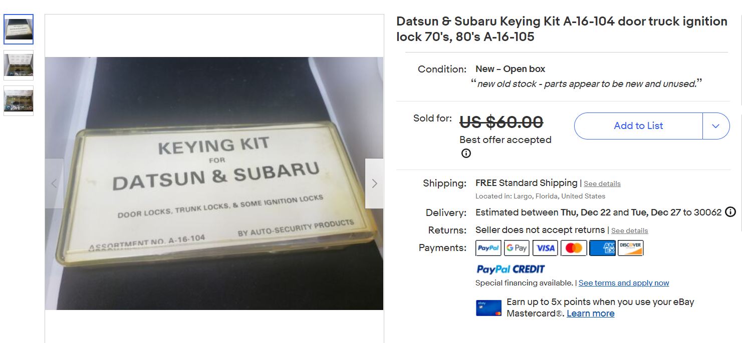

Just bought this and will play around with it some, see what I can accomplish.  Maybe, the right parts are here to rekey the hatch and door and glove box to match my ignition key.  Or, maybe some other option is possible.

They differ by changing the where the location of the rectangular hole is with respect to the top and bottom edges.
When you get the right wafers in the right spots and insert the right key, it should look like this pic. Note that the wafer farthest from the key is used simply as a retaining device for the cylinder to be held into the lock body. In other words... It should always be proud, even with a key inserted. Looks like this:
So, the rectangular slot cut in the wafer varies in height.  And thanks for confirming the correct position of the wafers when the key is inserted.

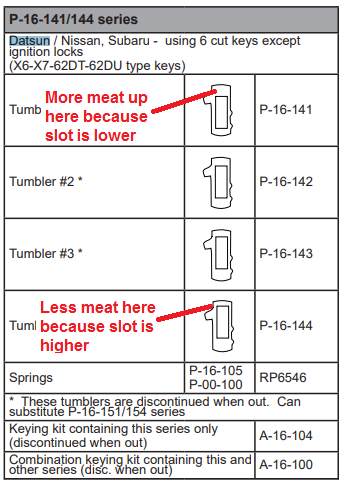

From looking at key codes on various locks I have, it seems likely that the numeric digits vary for Datsun locks from 0-9.  While investigating the rekeying kits, the one I bought seems to be comprehensive for door locks. The kit, however, has only 4 wafer part numbers.
Picture 2 of 3
How does one use 4 tumbler wafers and achieve all the combinations to correspond to the lock codes (0-9)?  Do locksmiths have to modify to slots in the wafers?
I don't know that you can if they have 9 wafers and you only have 4. You can't invert them because they're not symmetrical.
I rekey kwickset and Schlage locks sometimes and there are only like 6 different pins. I would be surprised if there were 9 different wafers available for a 50 yo Datsun lock...
No, the rectangular slot does not vary in height. It varies in position. The position of the slot will be closer to the top of the tumbler for each tumbler.

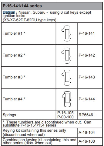

If you look closely at the pic you posted of from the ASP catalog, you can see they tried to draw them that way. It's a subtle difference, but enough to make the lock work. Goes like this:
And about the number of tumblers... I'm no locksmith, but I've only ever seen four different tumblers for these locks. Where are you getting numbers between 0 and 9?
I don't know if they changed the number of tumblers in the hatch over the years (like they did with the ignition lock), but my 77 has five tumblers in it. With four choices of tumbler for each position, that works out to different 1024 possibilities.

Regarding the numbers 0-9, if you look on eBay for NOS Datsun locks, there are enough right now to see lock code combinations including 1, 2, 3, 4, 5, 7, 8, 9, and 0.  I'm guessing 6 is valid as well.  So, I don't know how 4 wafers identified as #1, #2, #3, and #4 in the kit turn into codes like M7048, N1709, N1534, (all ebay auctions for NOS Nissan locks) etc.  My hatch lock only has 4 tumblers.  This kit has four distinct wafers  I can't see any evidence looking online of the existence of another necessary kit for the 240z.  So, I am wondering if locksmiths have to use special files in order to modify the rectangular cutouts depending on the code number.  Maybe the wafers in the kit are starting points, and for certain code numbers, you have to file the slot.  Doesn't make any sense to me, actually.  There must be something I am missing.
