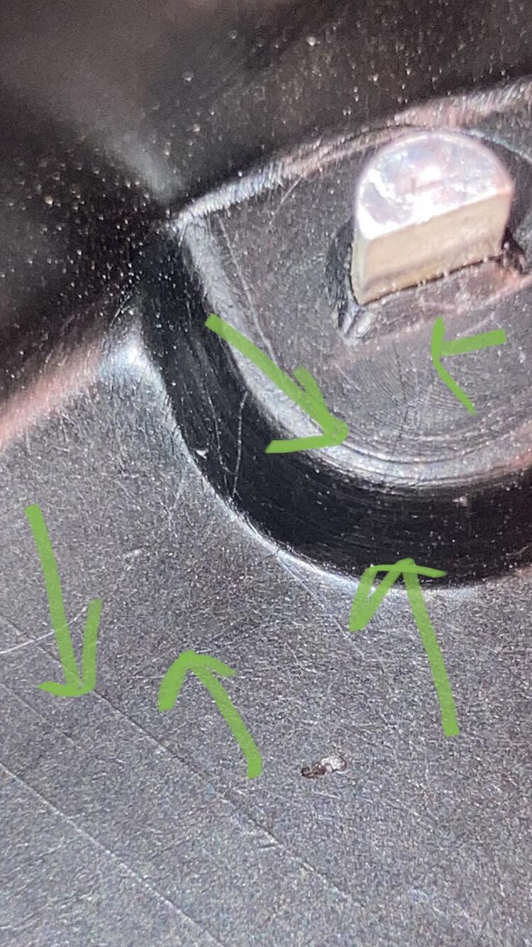

Rotor seems perfectly fine. Cap seems fine. There is a possible microcrack in the cap, but it is hard to tell. I did resistance test all throughout the cap, and it all tested out as should. No terminals were continuous with eachother.  As you can tell the crack is super small. I couldn't see how this could be my issue. As I would assume if the cap was bad it would be a constant misfire, not bobbling rpm like power keeps cutting.

Yup, low side of the the ignition system triggers both the tach and the ECM (as well as the coil). But since the tach seems to be working without an issue (even when the car is bucking) I'm thinking the low side of the ignition system is OK.
And yes, coils can fail intermittently, but there can be other things at play... It might not be a hard black-n-white fail kind of thing. It might be a failure that presents itself above a certain RPM range. Or it might be engine load related since it's more difficult to spark a plug when there is a more dense mixture in the cylinder.
Sparks that travel just fine at idle might jump somewhere they don't belong at higher engine loads or RPM. That kind of thing. I'm not expecting a dead short in the cap. Certainly nothing you would measure with your typical VOM.
