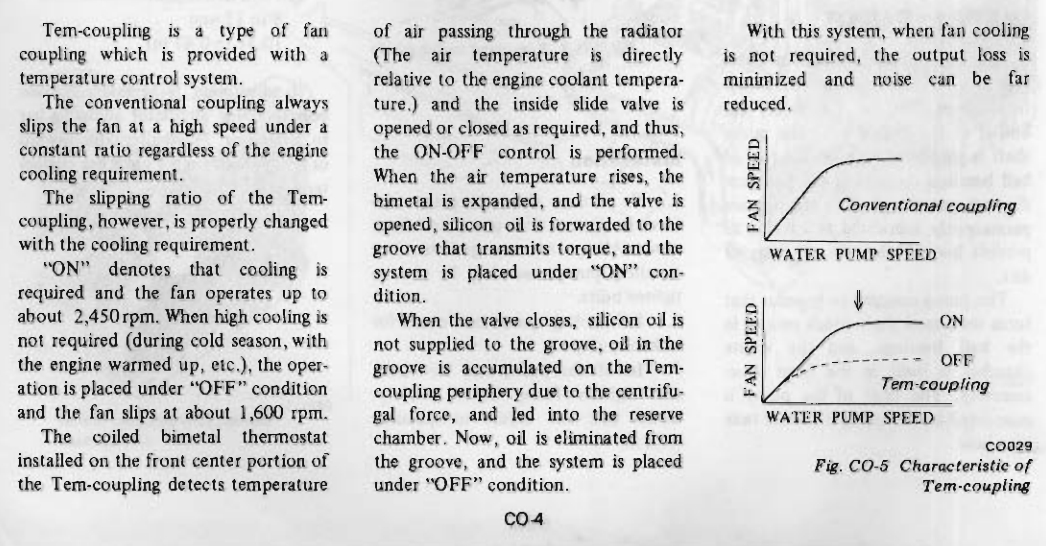

I've always read that if you can spin the fan blades around more than one or 1.5 complete rotations while the car is off and "cold" the clutch could be bad. Another way that's a little trickier is if you can stop the running fan with a piece of cardboard it's most likely bad.  They're oil filled so it should be harder to spin freely by hand before cranking while the oil is cool.

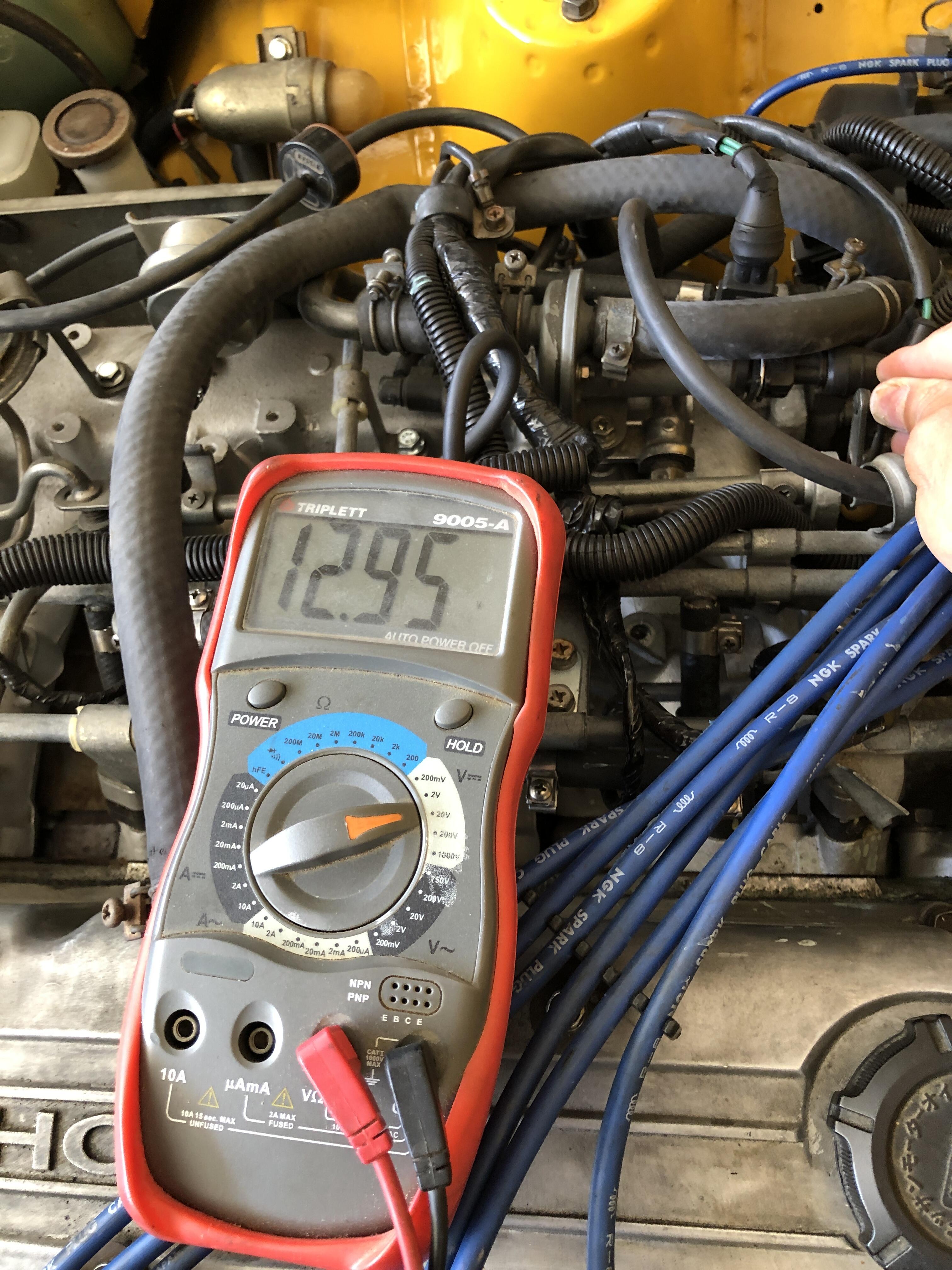

the volt gauge might not display correct?!. I measured at idle and rev up at the battery terminal and the voltage is less than 13v.  This is when all lights were on.
That voltage is on the low side. It should really be reading around 14 above 2000 RPM.
I suggested the cigarette lighter voltmeter because it's easy to compare it to the voltmeter in a 280Z and know what the voltage is while you're driving around.
If you are measuring the voltage at the battery, you are only seeing the battery state of charge. Around 13 volts is OK.
Measuring the output of the alternator you should see closer to 14 volts as the alternator is operating.

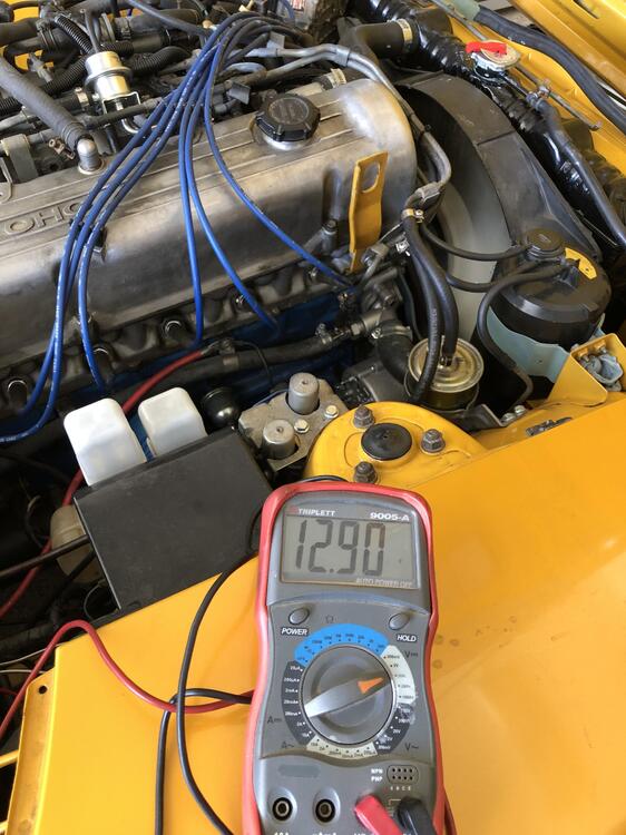

take a look at the photos below.  This is at idle at red light after 15 minutes of driving in the morning.  Around 8:10am.  The outside temperature was in the low 70F.
as I stepped on the gas pedal from the red light, the clutch fan engaged, around 3rd gear, then disengaged after couple of seconds.

In the first photo, you can see the fan is blurred, so the car is running. Unless @240zadmirehad not tried to rev the engine to excite the alternator before that photo, the voltage is low. Since the alternator and battery are connected, you should see the same voltage at both. The only thing that would drop the voltage at the battery is corrosion.
The car was running.  The second photo I rev up the engine while trying to take a photo.  As you can see I had to put the voltmeter on the fuel rail and my right thumb on the throttle linkage on the second photo, on the right.

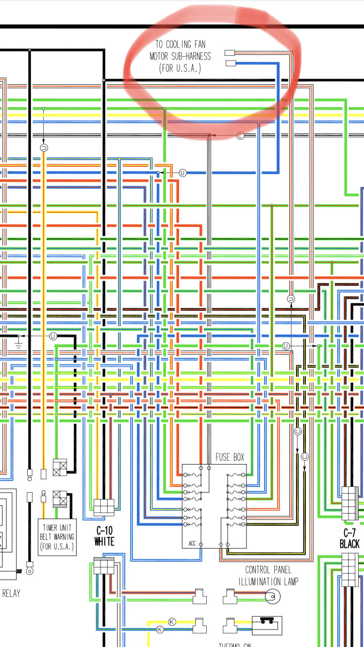

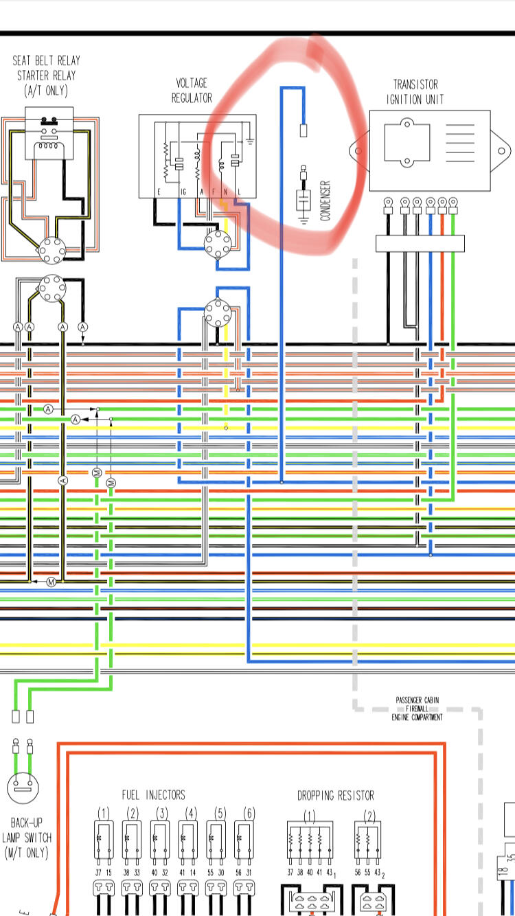

I need a little bit help locate the condenser as highlighted in the photo below.  Look like the temp, oil pressure… all connected to this condenser.  It also connected to cooling fan motor sub-harness.  What and where is that?  There’s only 2 fans I know off, radiator fan and the heater/ac motor fan.
