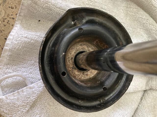

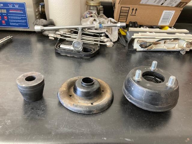

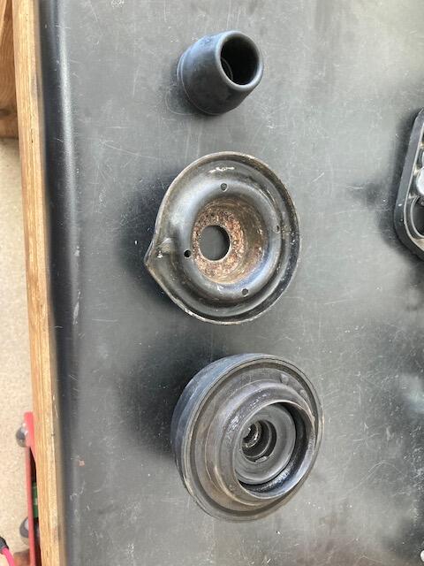

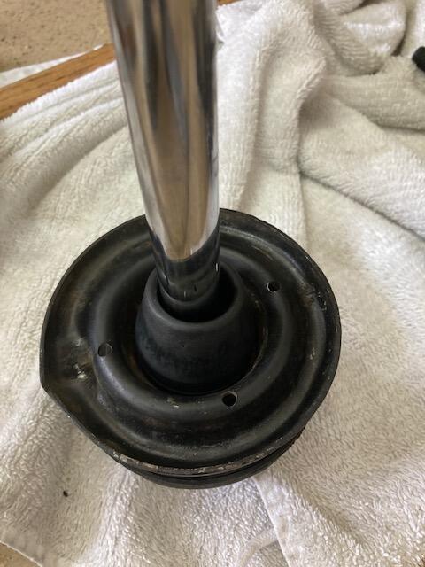

When I received the car my first step was a visual inspection, followed by tightening every nut and bolt in the rear end to assure nothing was missing or loose. The banging was still present. At that point I thought the strut insulator may have come apart causing metal to metal contact when the suspension was loaded and unloaded. I pulled one of the rear struts out and disassembled it to look for damage or perhaps a missing part or incorrect assembly. Nothing was readily apparent (see pictures).

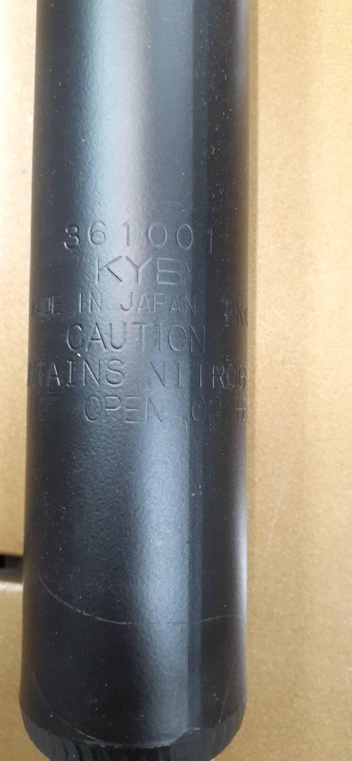

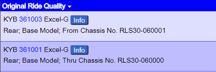

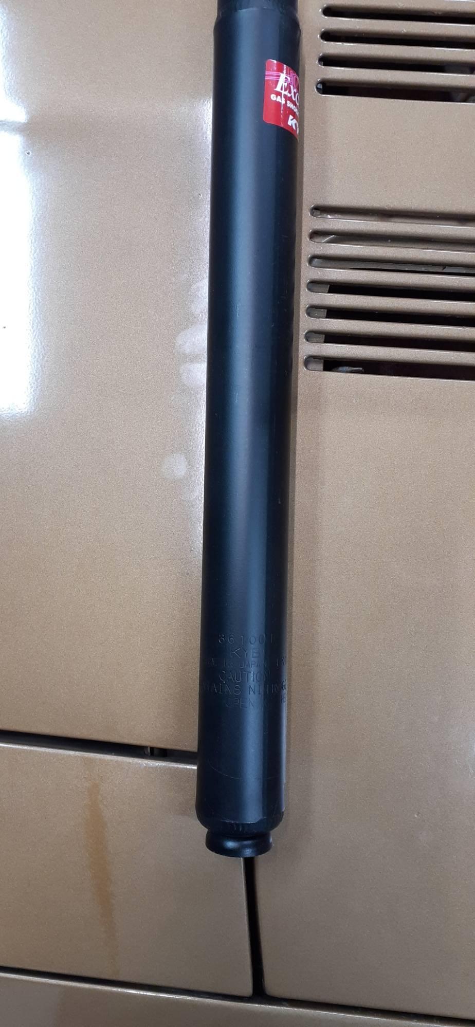

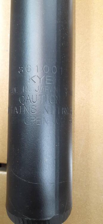

After contacting KYB, I learned they had two distinct part numbers for strut replacements on a 260Z, one for early cars and one for late cars. Each one is dimensionally different, 12mm vs. 20mm, from the bottom of the threaded portion to the point where the shaft flares. Apparently the correct part number for this car is 361001 (the 20mm version), but I don't know if that is what's on the car or not. I also noticed while I had the strut apart that there is quite a gap (1/4”) between the shaft of the insert and the hole in the spring perch that it passes through. I thought there might be movement/contact when the suspension was loaded and unloaded that could cause the banging. There were also no washers around the strut cartridge anywhere, which I seem to remember on other Z cars I've worked on.

FYI - This is a screen snip from Rockauto's website.
It is my understanding that the diameter of the strut tubes got bigger in the later years. From 50mm to 55mm OD and a corresponding increase in the ID as well. The length may have changed as well, but I don't know for sure. So if the ID of the strut tubes increased, I expect that KYB increased the diameter of the insert.
They also changed the height of the rear insulator mount that goes at the top of the strut assembly. The later mounts are taller than the earlier mounts. The mount in your pic appears to be the earlier shorter version.
So I don't know if it's possible to even fit the wrong insert... I suspect (because of the diameter change) that it's impossible to stuff a newer design insert into an older design housing, but the converse may be possible. It may be possible to fit an older design insert into a newer larger housing.
Than about the top insulators... I know the overall height changed, but I don't know if that height change resulted in a change in length of the necked down portion of the insert chromed rod. I can theorize that the taller insulator used a longer non-threaded portion of the shaft, while the shorter insulator needs a shorter non-threaded portion.
All that said... Here's my thoughts. If they fit a smaller diameter insert into a larger tube, it may be knocking around inside there. And if there is some sort of mismatch on the rear insulator mount, the threaded portion of the insert shaft may not be long enough. You may be bottoming out the nut on the threads before you get to the shoulder. In other words... The nut will get tight, but only because it's binding on the threads instead of tightening up against the shoulder like it should.
Bottom line? Make sure all the parts are matched for the car. An early thin bumper 260 should have the smaller strut tube and the shorter insulator on top of the strut assembly.
And I'm a little confused by this part - "I pulled one of the rear struts out and disassembled it to look for damage or perhaps a missing part or incorrect assembly.  Apparently the correct part number for this car is 361001 (the 20mm version), but I don't know if that is what's on the car or not."
If you took a strut assembly apart, then why don't know if the insert is the right one or not? Isn't it as simple as looking at the part number on the side of the insert?  :unsure:
Thank you Captain Obvious for this. You're confirming where my head is currently at. Re: your inquiry, why I don't know the part number on the insert, I reassembled the strut and installed it back in the car before I had all the information I tracked down subsequently. Looks like I'm moving toward replacing both cartridges with the correct ones for an early 260Z, and hoping I have the correct insulators. I only wish I had a duplicate set of early and late 260 components so I could inspect and mic everything, side by side. Anyone out there have a 260 parts stash that's willing to take on that challenge?🤪
I've seen several times when replacing strut cartridges that the new gland nuts that came with the cartridges were too tall and the threads bottomed out prior to clamping the strut cartridge into the tube.  I had to use the old gland nuts and then there was no vertical gap between the cartridge and the inside of the nut.  With the spring off, the cartridge should not have any axial play.  If there is any play, it will bang.  With the spring installed, it's impossible to tell if there is play, although if you see a lot of exposed threads, chances are good this is your issue.
Thank you Jeff. Will definitely check that during disassembly/reassembly with the new cartridges. The current condition is that the gland nut holds the cartridge tight with a couple of threads still showing.

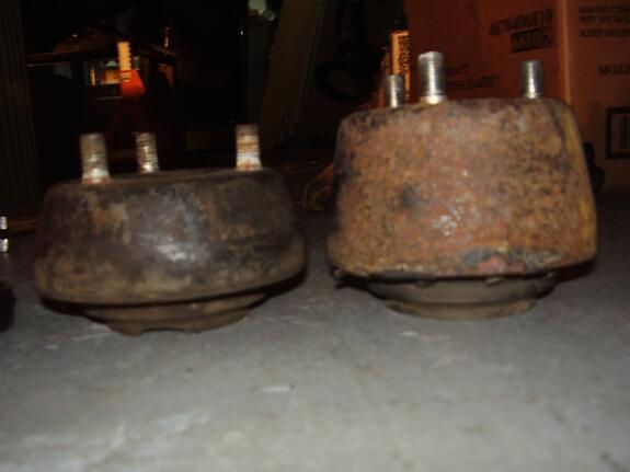

As for the insulators, it's pretty easy to tell the difference between early and late. The difference is significant. Here's a pic I hoovered off the internets of the two side by side:
The one you showed above appears to be the early shorter version. And that would make sense for an early 260.
