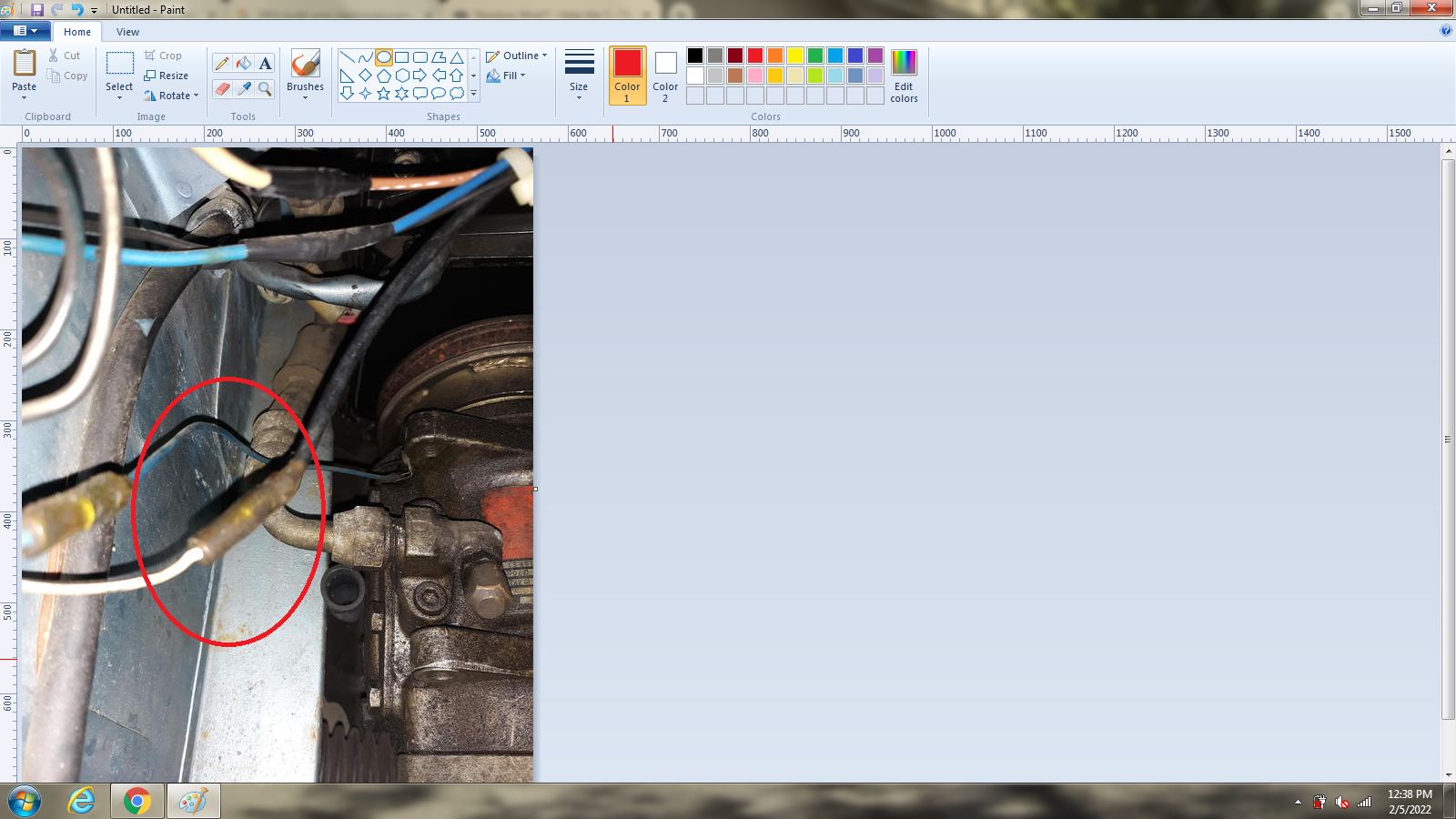

Just for the fun of it I would unplug the BCDD wire and see what it does. That thing causes fluctuating RPMs too.
The butterfly in the throttle body could be gummed up and stick when it's cold allowing more air through raising the RPM. Then when it warms up the sticky goes away. You can clean that with an old toothbrush and some lacquer thinner.
Here's a picture of the connection where you can unplug the BCDD and a thread that talks about function. Good luck. I hope you figure it out.
