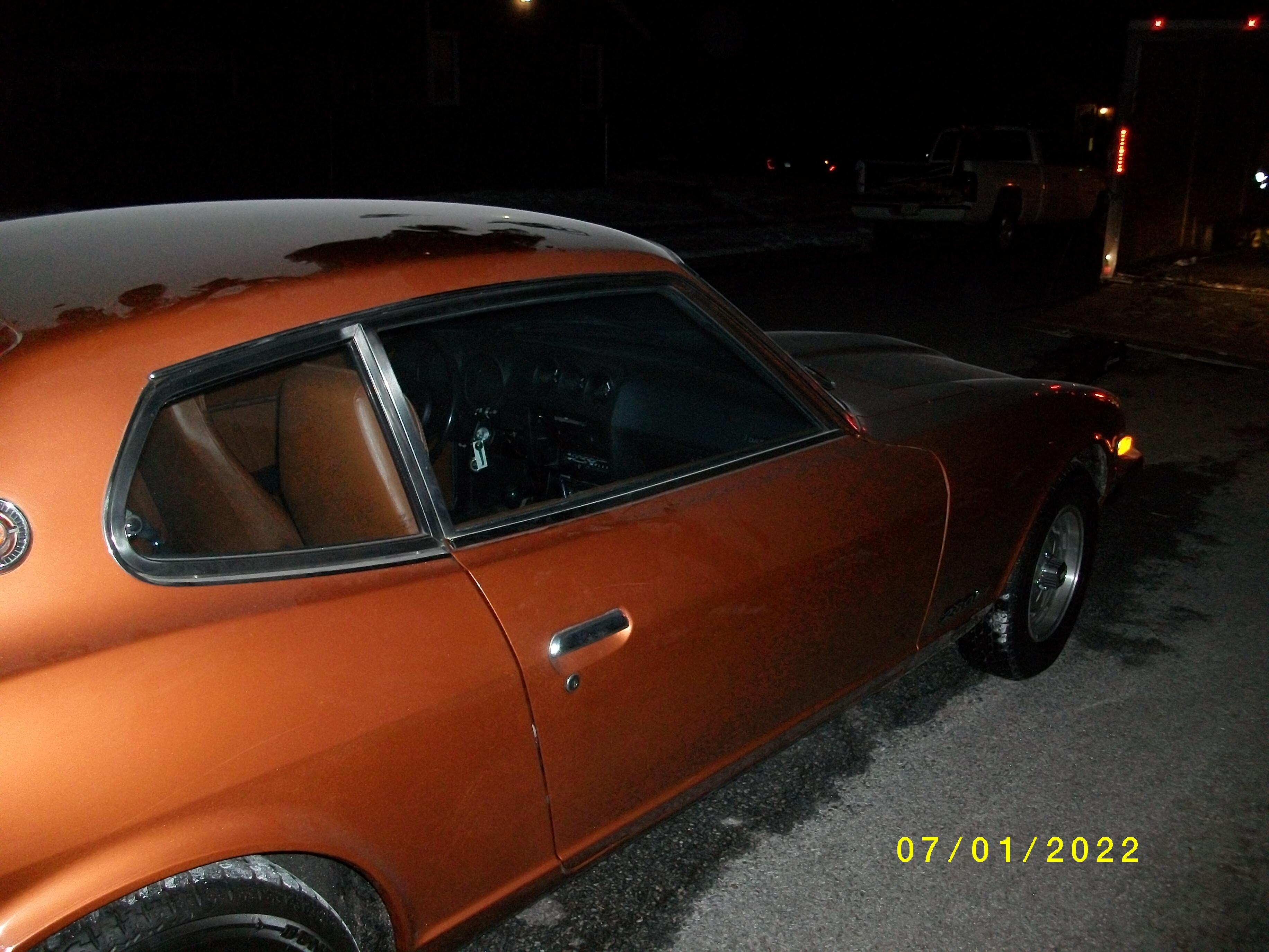

January 31, 20223 yr Author comment_635098 Hay Thank you, I'm not sure if this was a CA car or not, but I don't have that big shielding on my car, I'll post a pic here in a minute, I think the car was saved by always being in a garage and the dealer optioned Undercoating. You can see it pretty clearly and I don't see the bolting for the shielding. I hired an appraiser/Inspector from the Hemmings motor news magazine to inspect it for me, and he said the brakes and clutch MC need replacing but he drove it a little and said he thought that this was a true 'Survivor' since the glass is and the headlight bulbs are still Japanese. I'm trying to figure out what the Cat shielding looks like and where I can find one. The car is in my garage, we got a snow storm yesterday. And wow, your car is mighty impressive ! Edited January 31, 20223 yr by Killain Link to comment https://www.classiczcars.com/forums/topic/66300-1975-280z-catalytic-converter-heat-shield/?&page=2#findComment-635098 Share on other sites More sharing options...

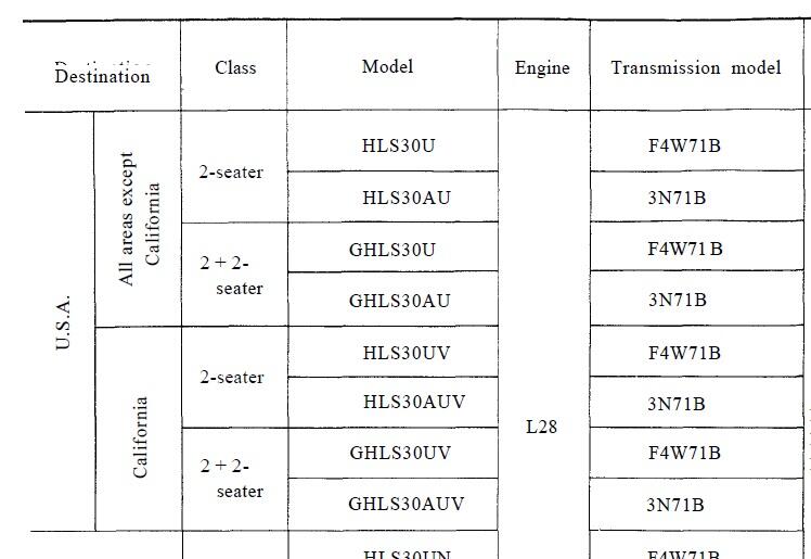

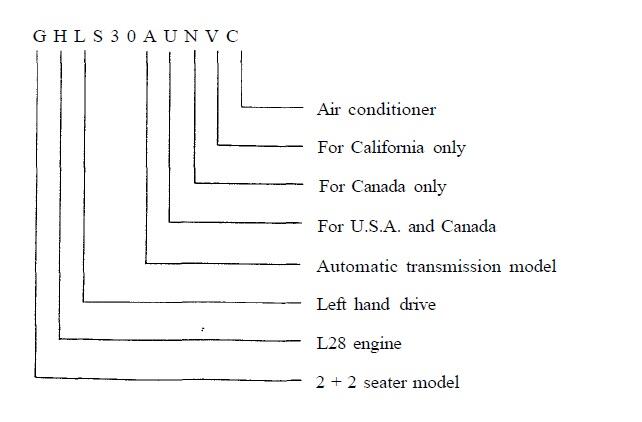

January 31, 20223 yr comment_635138 That's not the altitude compensator. That's a vacuum delay device for the EGR. The altitude switch lives under the dashboard above the driver's knees. But regardless... Other than wiring harness changes, the CA differences can be pretty easily removed if someone really wants to. But according to the FSM, the CA spec should be built into the VIN. Link to comment https://www.classiczcars.com/forums/topic/66300-1975-280z-catalytic-converter-heat-shield/?&page=2#findComment-635138 Share on other sites More sharing options...
