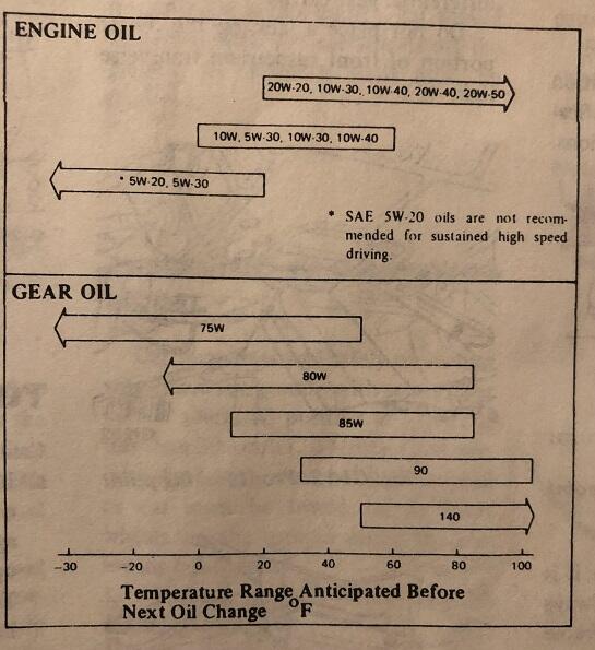

10W-40 is good choice too. I was just going by what was listed in the manual attached. Temp in CA varies quite a lot Winter below 50 and Summer 75+
I have not come across anyone who uses 10W-50 or 20W-50 though as mentioned here in the manual.
