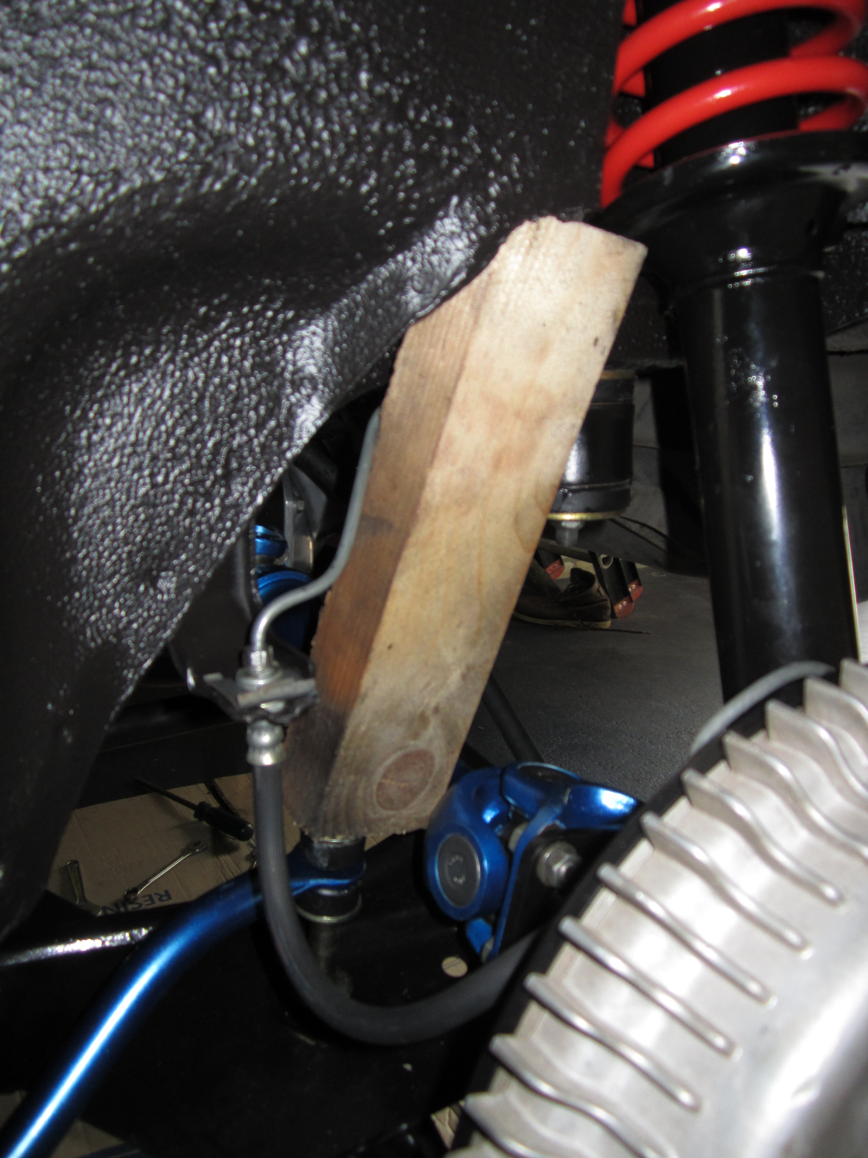

I had the same problems with my energy suspension poly bushings. My solution was a block of wood cut to length and wedged between the body and the swaybar.
The top nut was fastened a couple of turns and then I used a jack to push the control arm up and compress the bushes enough to fit the lower nut.
The photos might make it a little clearer🤔
