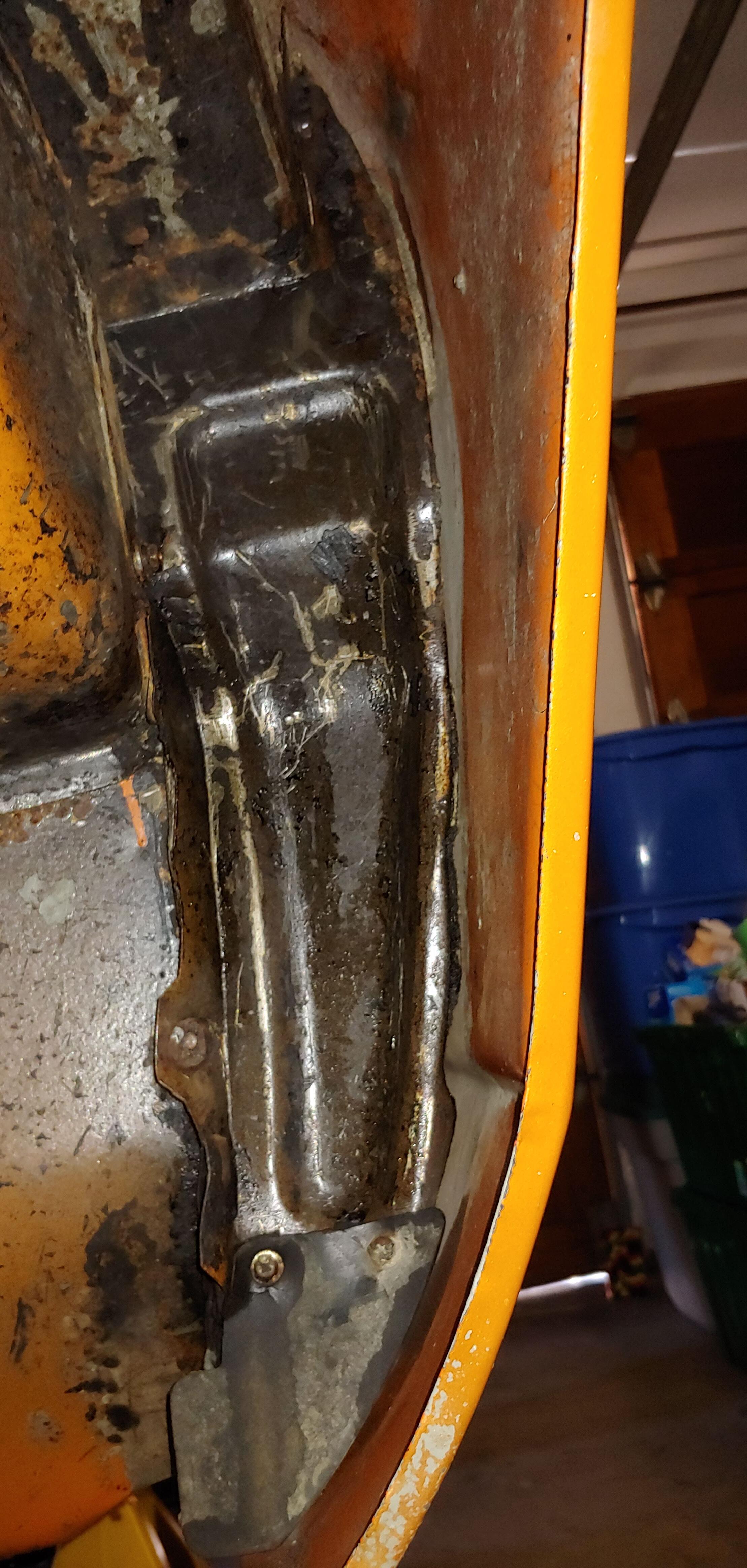

This discussion got me wondering how much dirt and debris had collected in this area on my car. Since I'm working on a restoration, now was as good a time as any for the fenders to come off. While taking some before pictures it struck me that removing the mud guards in the front wheel wells makes it very easy to inspect and clean the area that @inline6is concerned about. In fact all that is really required is to remove the small rubber flap at the bottom of the mud guards.
I checked and it is possible to remove and reinstall the mud guards with the fenders on, there are only three M6 hex head screws holding them on. The upper screw is the most difficult to reinstall with the fender on, but using a m6 screw with a point made it not to bad. The rubber flap is easy as it is held on with two sheet metal screws. I used a magnet to hold it in place while reinstalling.

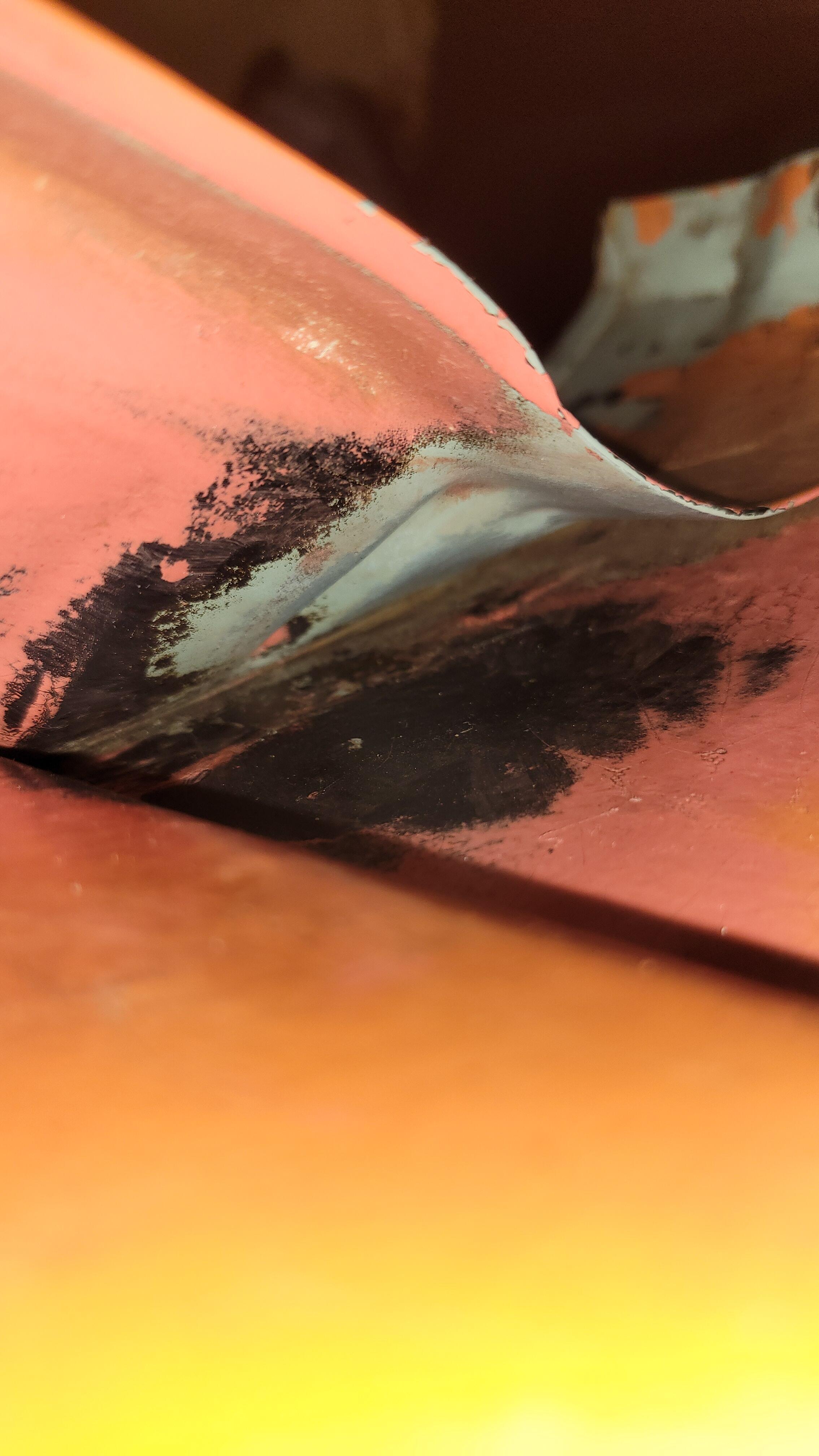

For my 240z undergoing restoration currently, I used the existing fenders.  They had some rust in this area.  I cut out the rust and welded in replacement metal.  I also unfolded the metal that wraps around the reinforcement panel because some rust had occurred within.  As a result, the area captured by the folded rear edge of the fender had "expanded".  This happens when metal rusts.  It expands at the same time.  So, I unfolded the bottom two or three inches where the outer panel wraps around the reinforcement panel.  I manually removed the rusted metal that was loose from within the pinch, and then re-pinched the reinforcement panel.  This time, I poured the epoxy primer into the inside of the reinforcement panel.  And separately, I applied seam sealer to the outside of the pinch to seal the other side of it.
So, that corner of the fender has been "soaked" in chromated epoxy primer on the inside, and seam sealed on the other side.  And of course, now it has a fabricated panel that hopefully will keep debris from settling into this trouble spot.

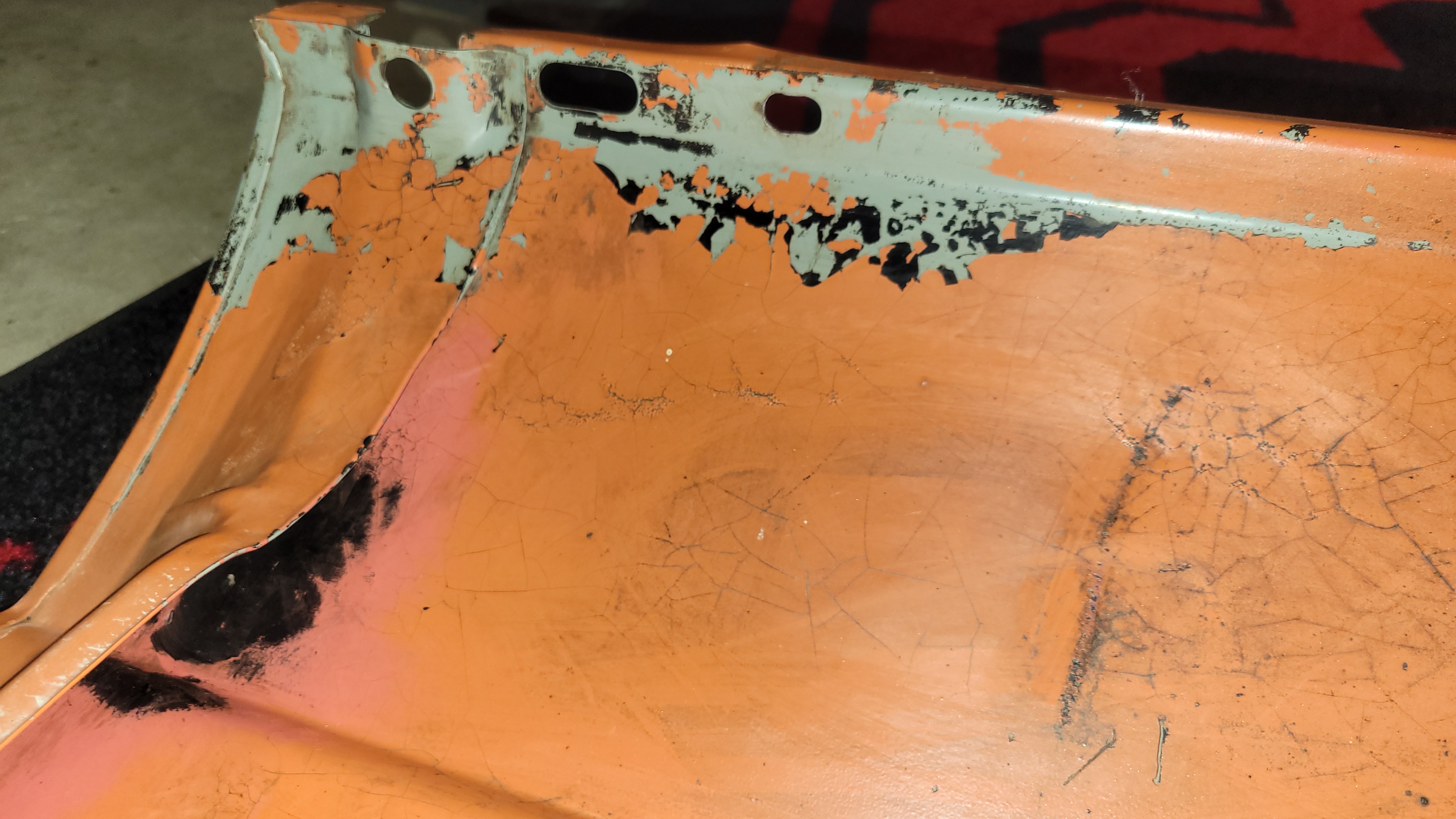

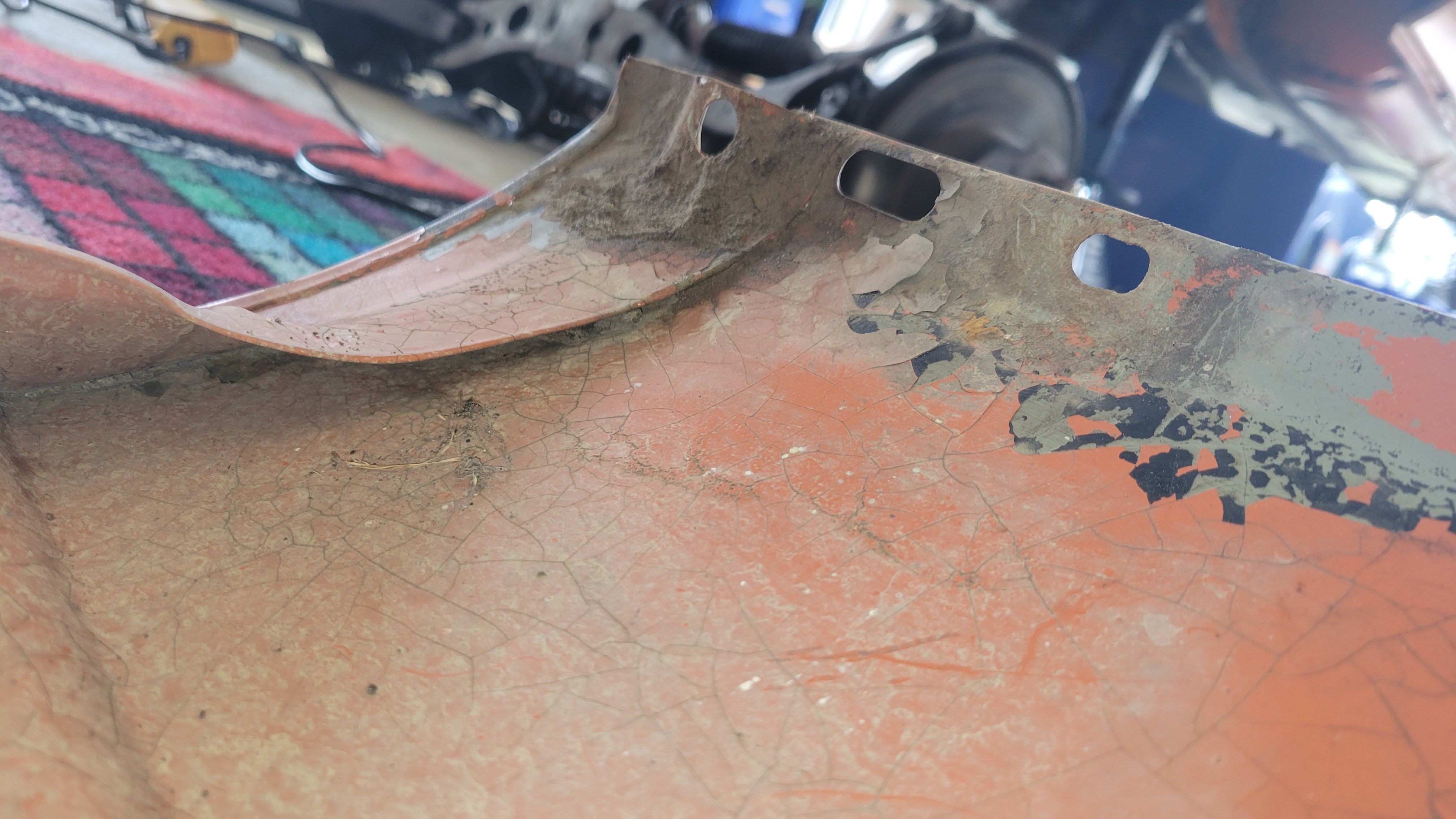

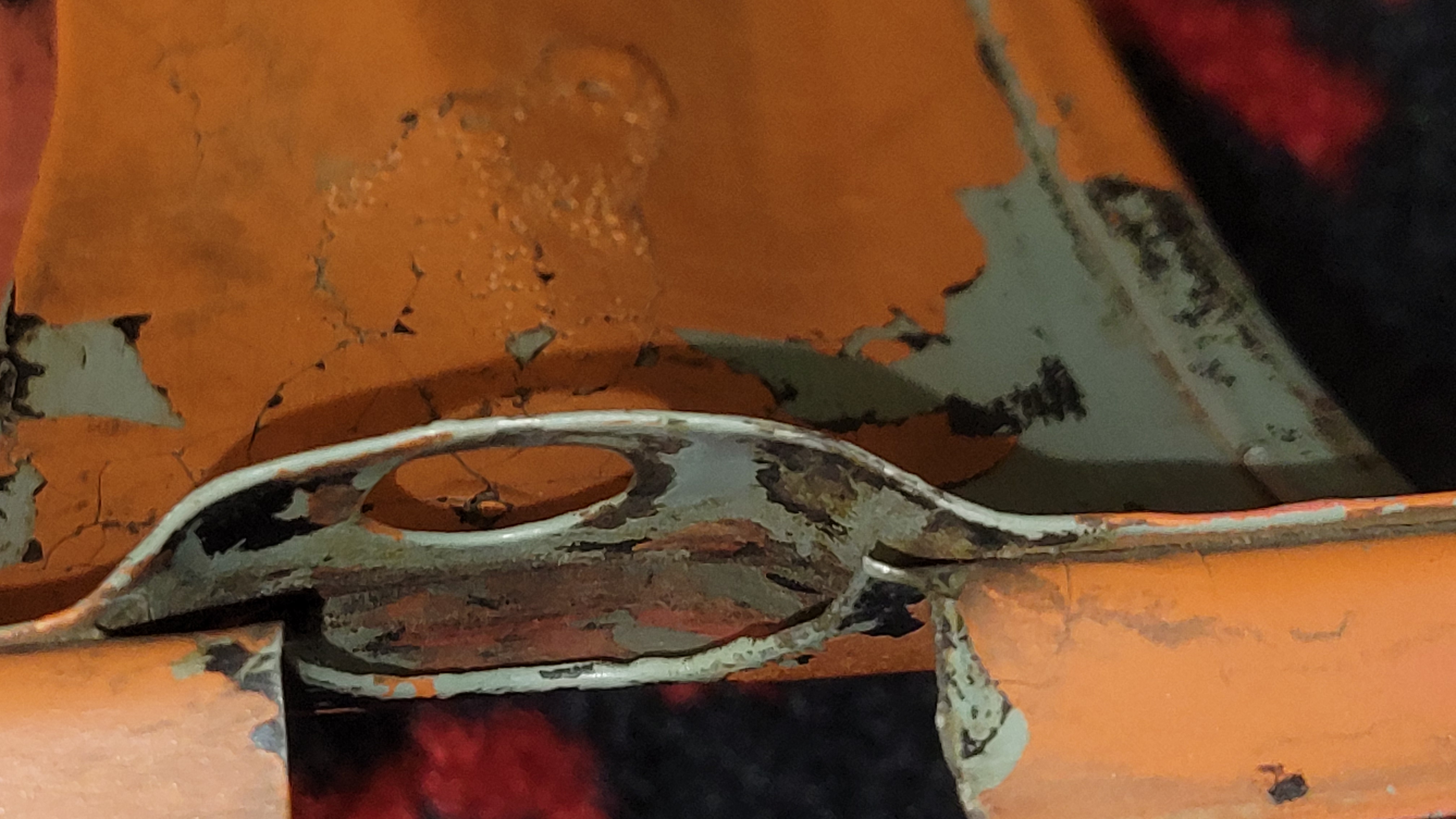

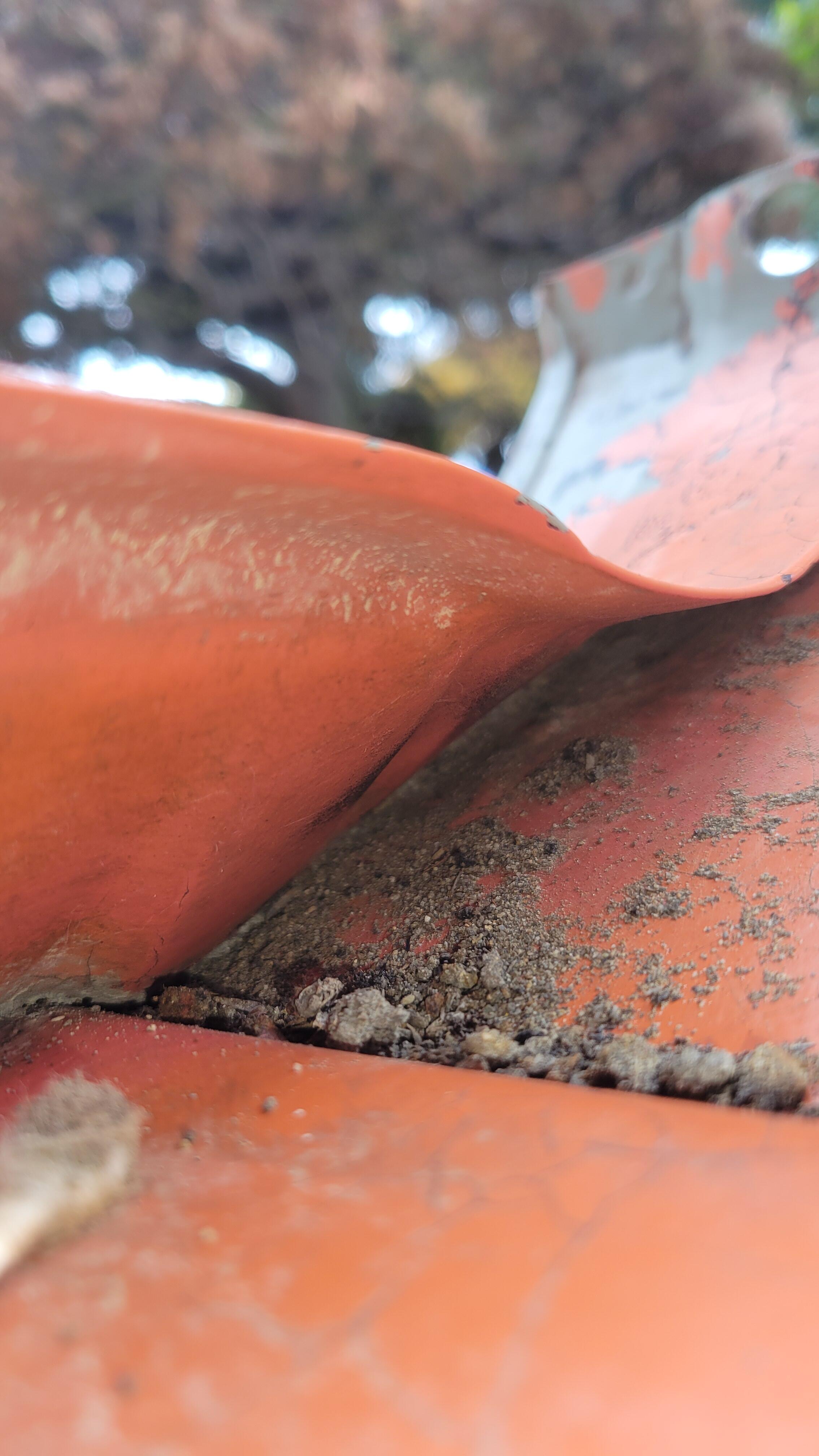

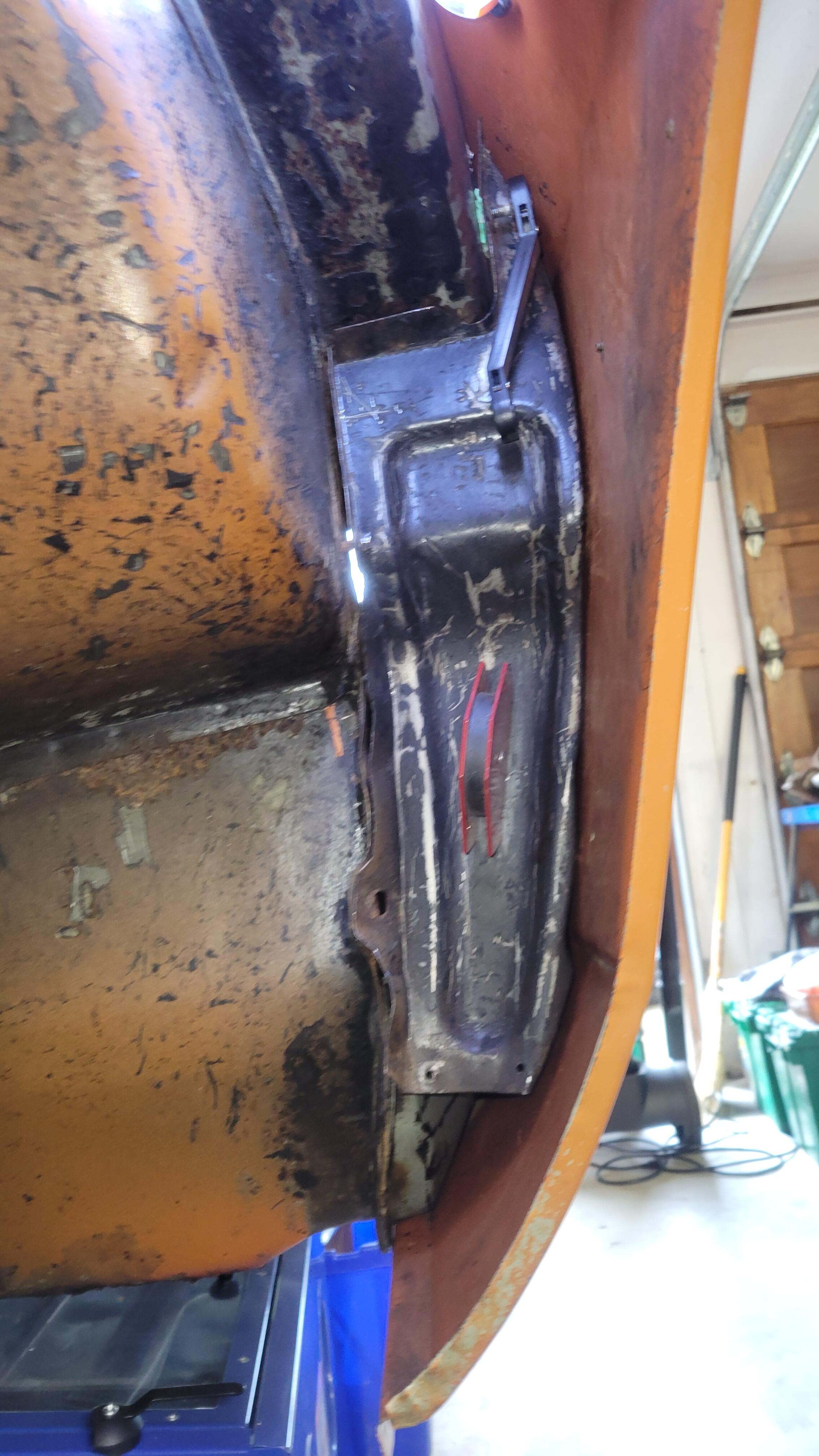

For reference here are some pictures of what my RH fender looked like when I removed it, before and after cleaning. When I did my first restoration on this car in 1982 and I had new fenders (from my local Datsun dealer) put on. No special sealing or rust proofing was done beyond what I think was a light prime and top coat over the factory primer. After 39 years only a small amount of debris had accumulated and after cleaning I found no paint bubbling and virtually no rust.  I guess I'm one of the lucky ones. Full disclosure, since 1982 only about 25K miles have been added.  After the first few years of light daily driving (no winters) it's been infrequent pleasure use only in good weather, but I have been caught in a few downpours.
Edited by CanTechZ
That is amazingly clean.  Love to see some others post up pics of this area of their cars "as found".   I may get some of my passenger fender on my first (now track) car, which unfortunately has been off the road for 7 years now.  I doubt I cleaned it out right when I put it in storage.
