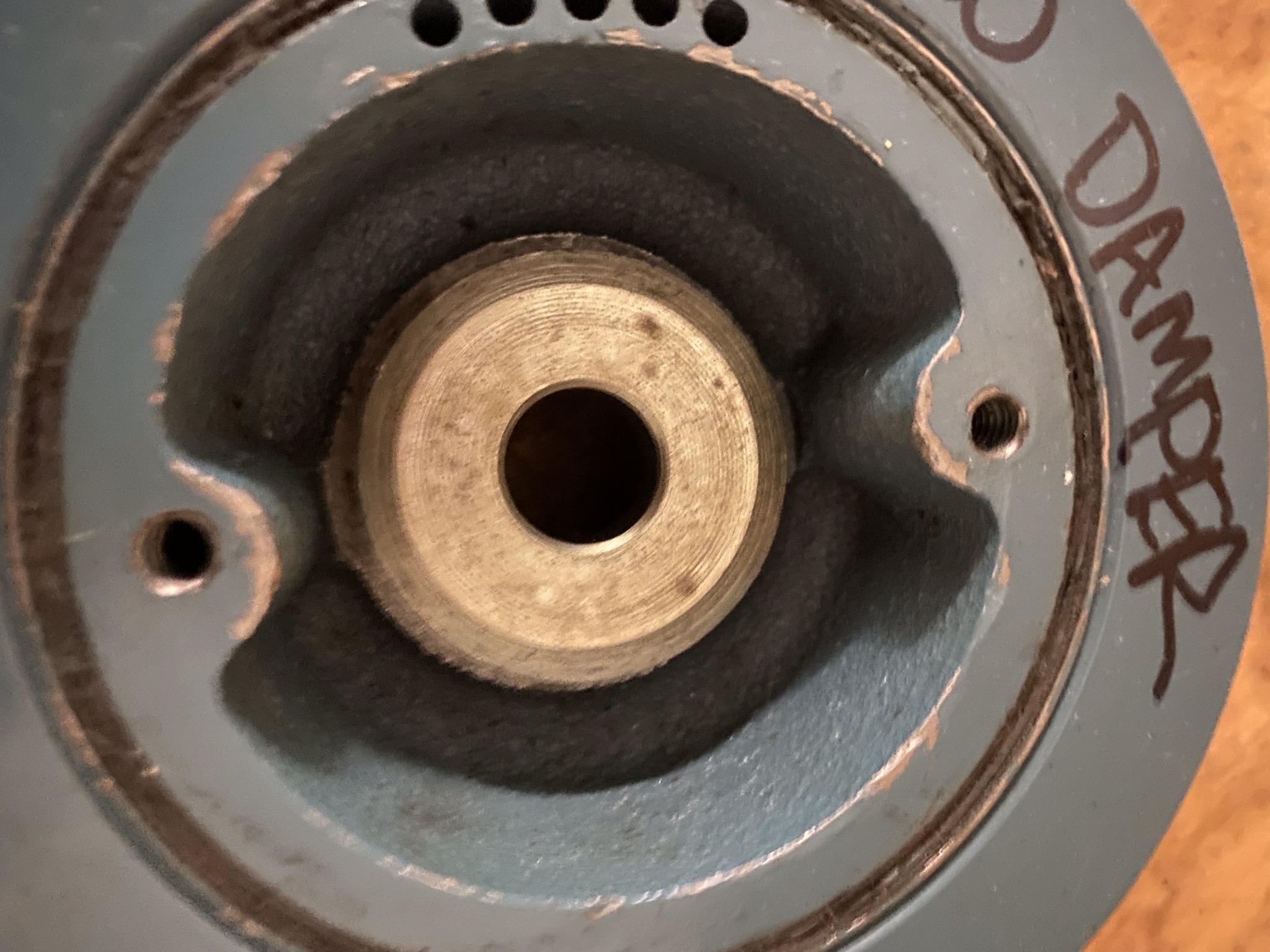

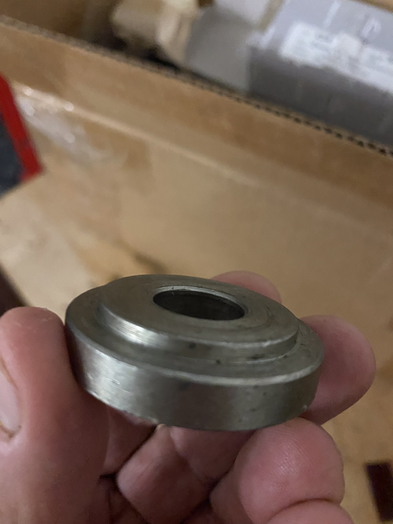

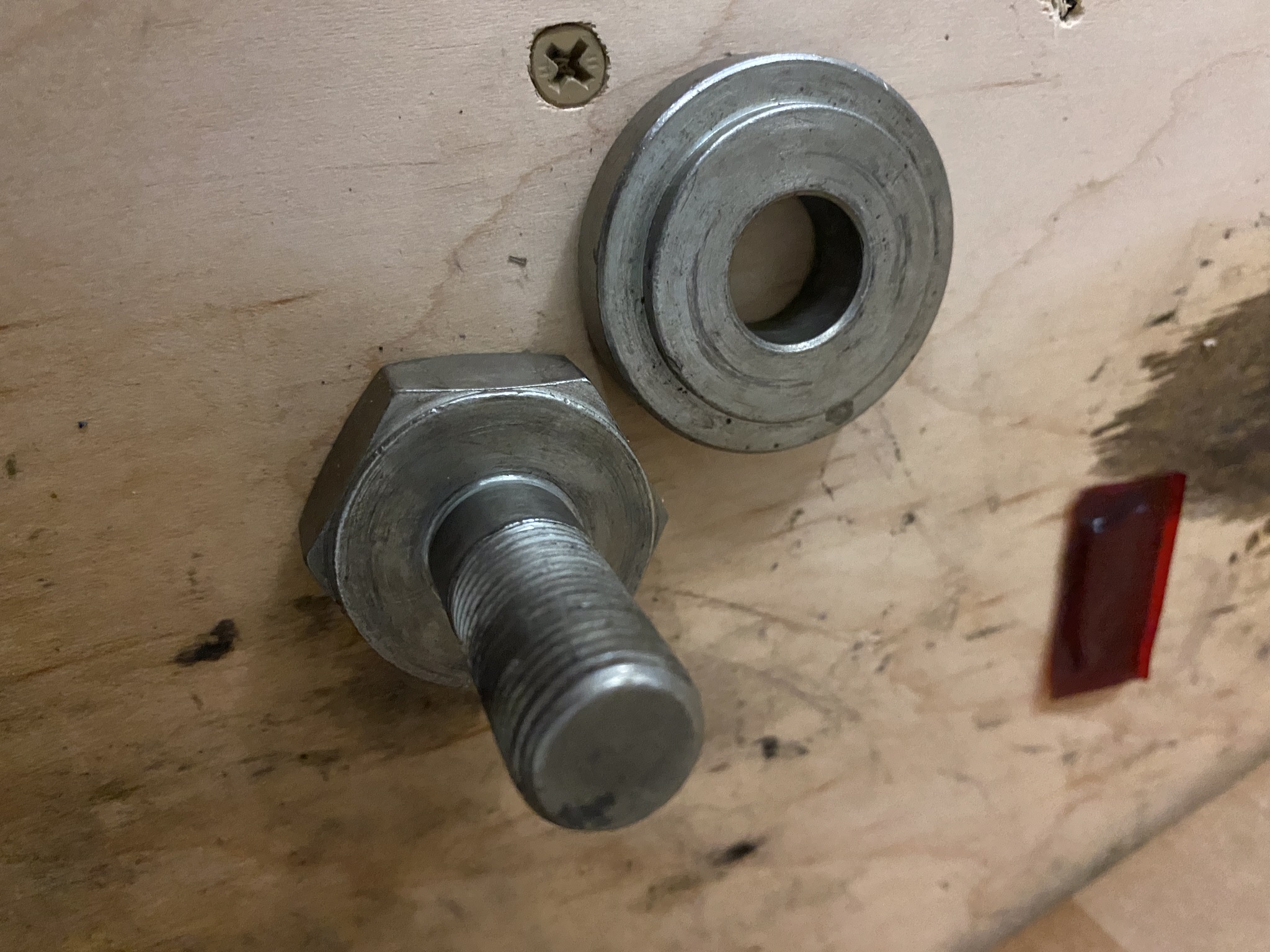

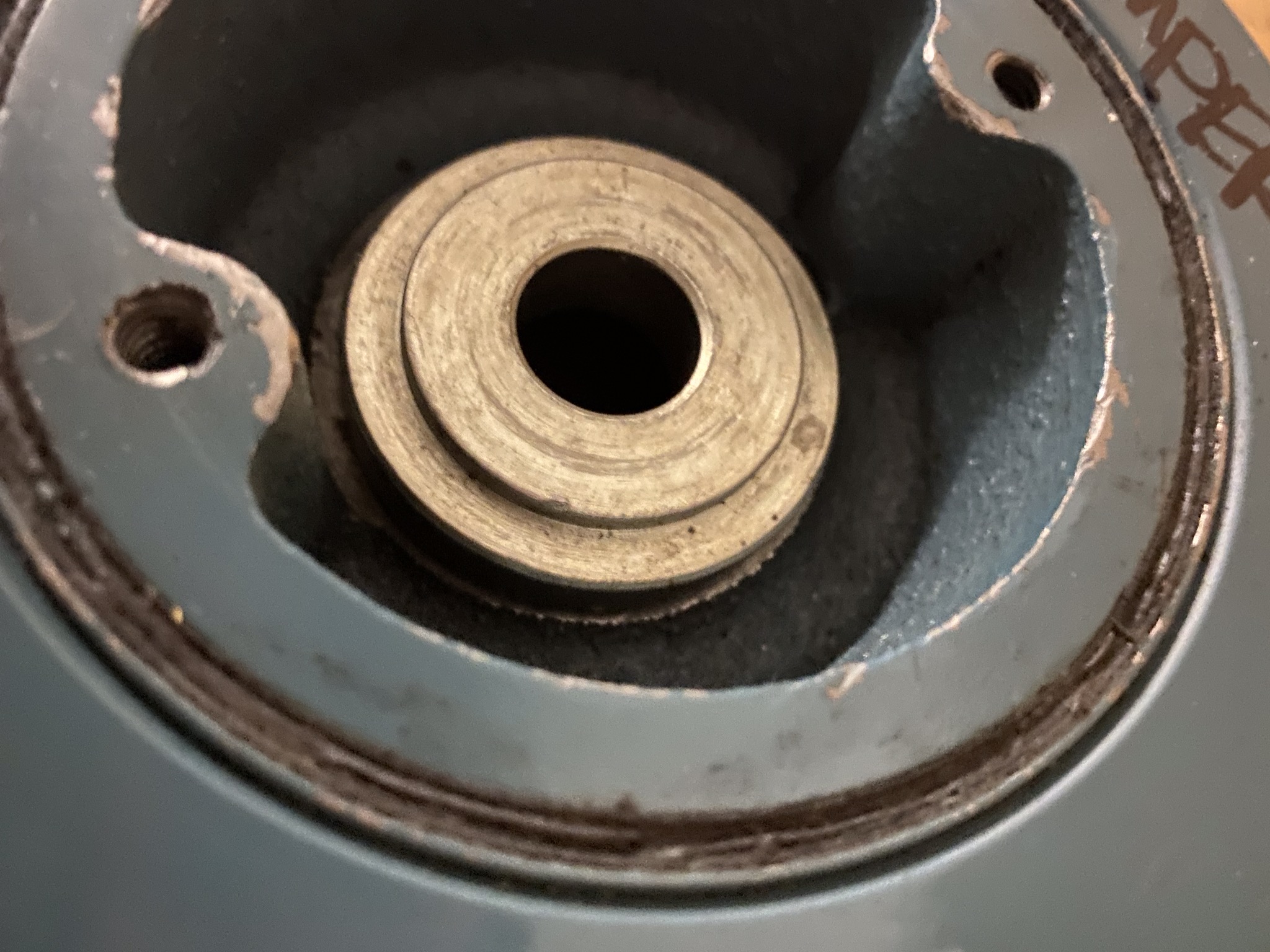

November 10, 20213 yr comment_631336 22 hours ago, Ownallday said: Thanks for the input. I will check it tomorrow or Thursday if I get the chance. So should I just retorque the bolt? MSA has a recommendation to using a special bolt and washer from them for the balancer I have. I don't have air condition installed atm but I do have an AC kit I want to install eventually. Did you have the same combination I currently have? Performance Harmonic balancer from MSA and their special bolt and washer kit? If so what's the best solution? At this point I am pulling my hair out. Is it possible to just switch back to the stock bolt and washer? I don't want to buy another balancer unless there are any with an AC pulley attachment. If I recall, the washer had a step down. If I installed it one way, it dropped into the opening of the damper and caused the bolt to bottom out in the snout......BAD! If installed on the flip side, it wouldn’t drop in and the bolt wouldn’t bottom out. I just ditched the expensive “so called” Nismo bolt combo and went back to the stock damper bolt and washer and the noise disappeared. I pulled my hair out too. You can thank @Zed Headfor this if that was your problem.....he saved your arse a ton of hair pulling. I have a thread called “Strange noise coming from my L28” or something to that effect. If someone knows how to find it, it explains the whole process. I don’t know how to find my old threads. Every time I learn how to use this site, @Mikechanges it LOL. Good Luck! Sorry Mike.....still waiting for that trip to Holland. PS. I added pictures of that expensive bolt and washer that caused the problem. Edited November 10, 20213 yr by Diseazd Link to comment https://www.classiczcars.com/forums/topic/65932-new-oil-pump-installed-now-hearing-noise-from-engine/?&page=5#findComment-631336 Share on other sites More sharing options...

November 11, 20213 yr Author comment_631345 1 hour ago, Diseazd said: If I recall, the washer had a step down. If I installed it one way, it dropped into the opening of the damper and caused the bolt to bottom out in the snout......BAD! If installed on the flip side, it wouldn’t drop in and the bolt wouldn’t bottom out. I just ditched the expensive “so called” Nismo bolt combo and went back to the stock damper bolt and washer and the noise disappeared. I pulled my hair out too. You can thank @Zed Headfor this if that was your problem.....he saved your arse a ton of hair pulling. I have a thread called “Strange noise coming from my L28” or something to that effect. If someone knows how to find it, it explains the whole process. I don’t know how to find my old threads. Every time I learn how to use this site, @Mikechanges it LOL. Good Luck! Sorry Mike.....still waiting for that trip to Holland. PS. I added pictures of that expensive bolt and washer that caused the problem. Thanks for the response. I will update later tonight the orientation of the washer. I don't believe it's install "the wrong way" though but I will update later. 1 hour ago, Zed Head said: These two were at the very end of the search I posted. Searching is definitely more difficult than it used to be. Hard to find the right place then get it to do what you want it to do. I used the CZCC function this time but usually I just use Google and "site:classiczcars.com" Thanks, I tried to find them but didn't understand how to search like you stated. I will update later tonight on the washer situation 14 minutes ago, Yarb said: @OwnalldayDid you mention in an earlier thread whether or not your using the stock bolt or the one MSA recommended? Which bolt is currently attaching the balancer? I am using the MSA recommend bolt and washer kit so the washer that they recommend for the performance harmonic balancer that they sell Link to comment https://www.classiczcars.com/forums/topic/65932-new-oil-pump-installed-now-hearing-noise-from-engine/?&page=5#findComment-631345 Share on other sites More sharing options...
November 11, 20213 yr comment_631347 6 minutes ago, Ownallday said: I am using the MSA recommend bolt and washer kit so the washer that they recommend for the performance harmonic balancer that they sell If you read Diseazd's thread you'll see that he was too. That was the point - the MSA recommendation did not work correctly. Link to comment https://www.classiczcars.com/forums/topic/65932-new-oil-pump-installed-now-hearing-noise-from-engine/?&page=5#findComment-631347 Share on other sites More sharing options...
