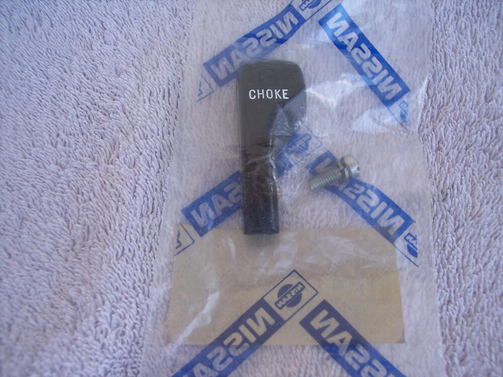

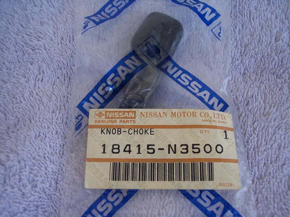

This NOS choke knob was in a group of parts I picked up a while back, it's not listed in the online catalog for Z's (the 260Z has a number close to this). Any help on identifying what model car it is for? Thanks!

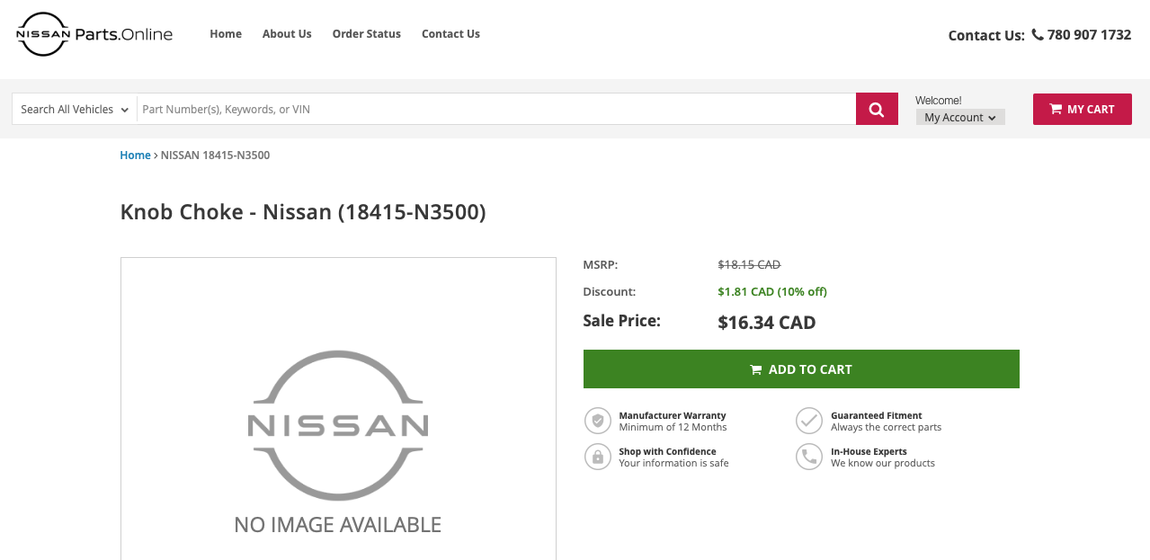

Here is what I found on a google search, seems to be a newer part number that supersedes the 18415-N3601 in the 1979 parts book
https://parts.nissanusa.com/p/Datsun__/Knob-Choke/89430726/18415-N3500.html
Still shows available on the Canadian Nissan site.
I also agree 260Z and yes I see the superseded numbers N3501 and N3601
