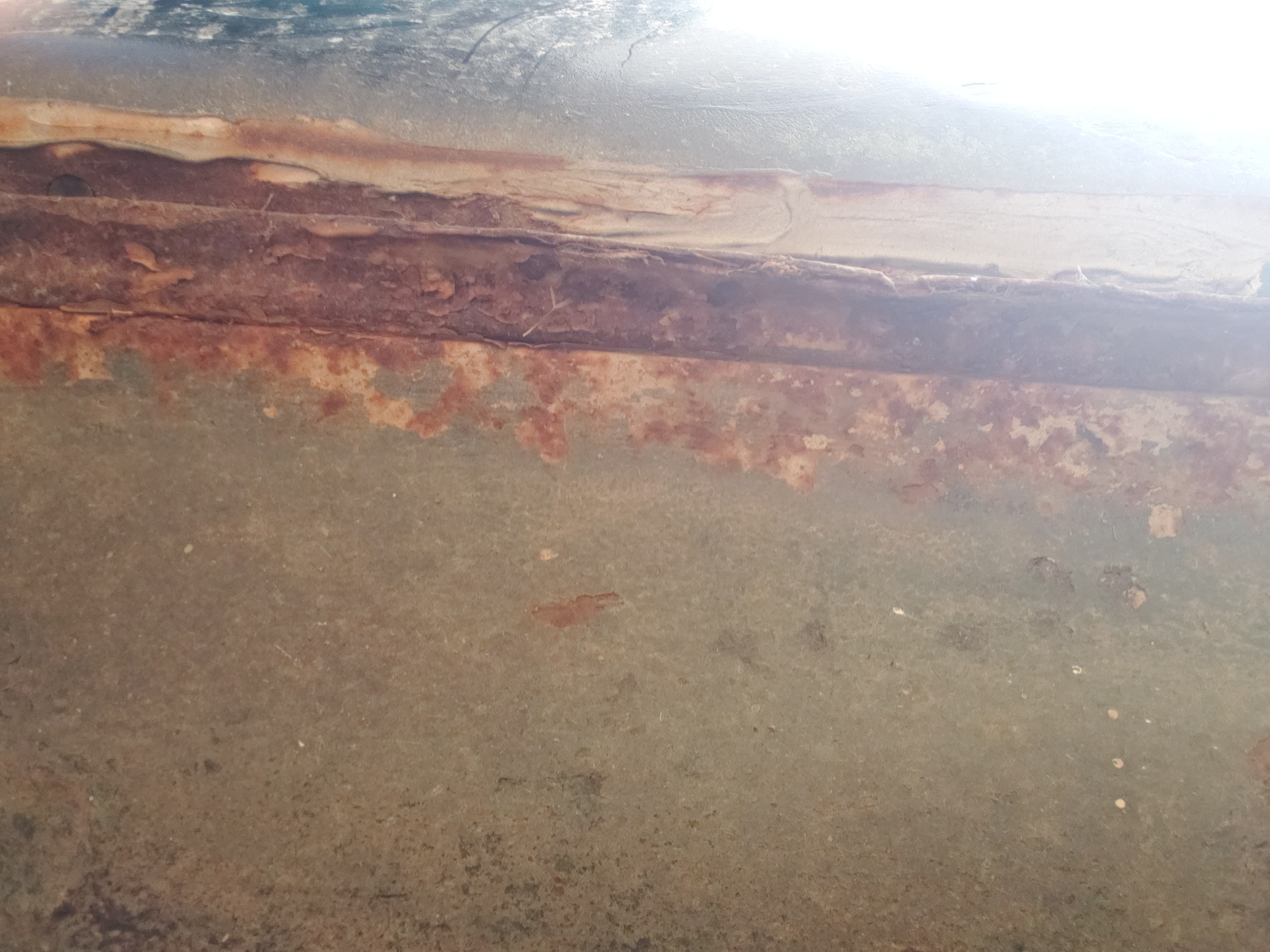

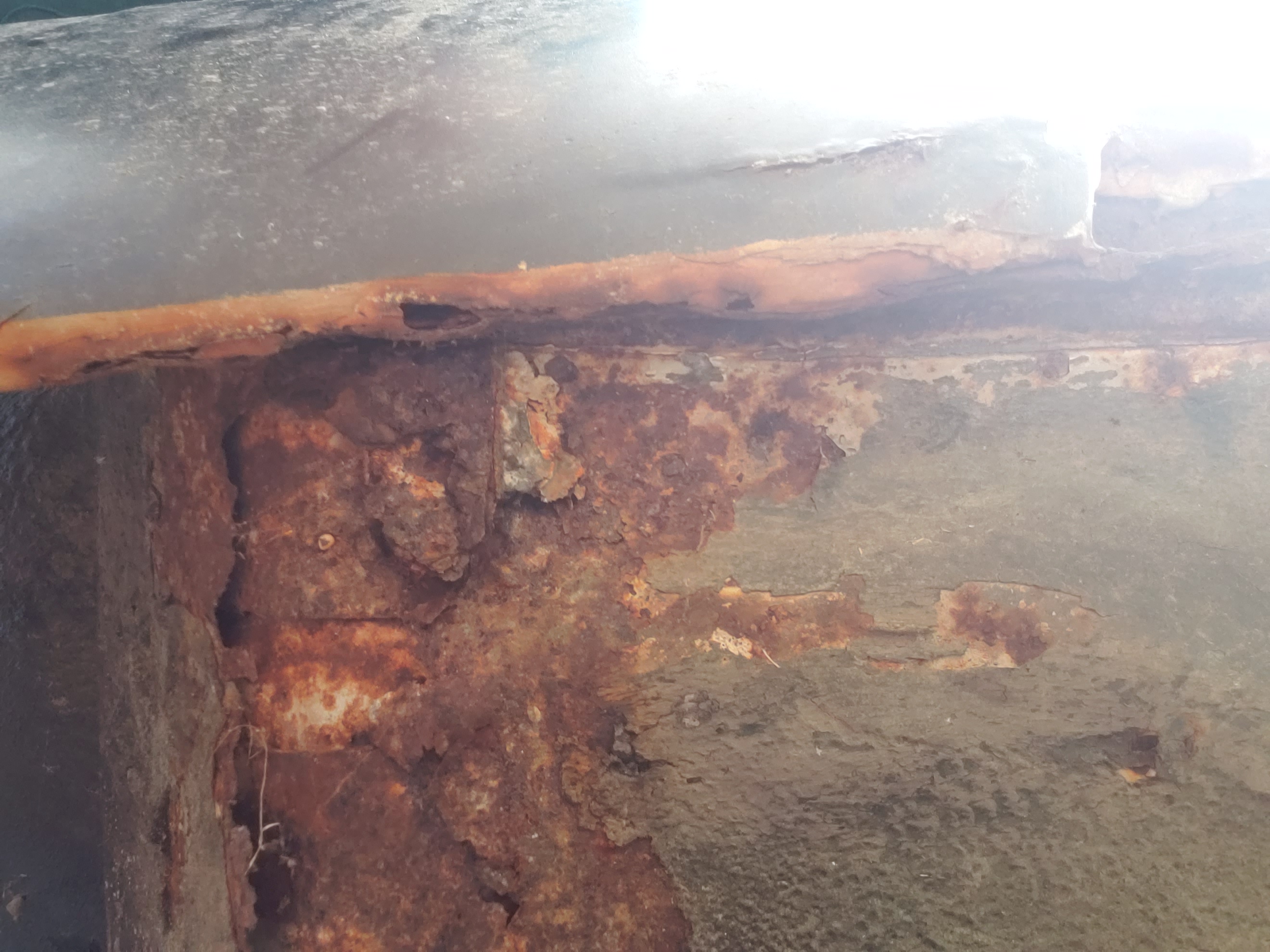

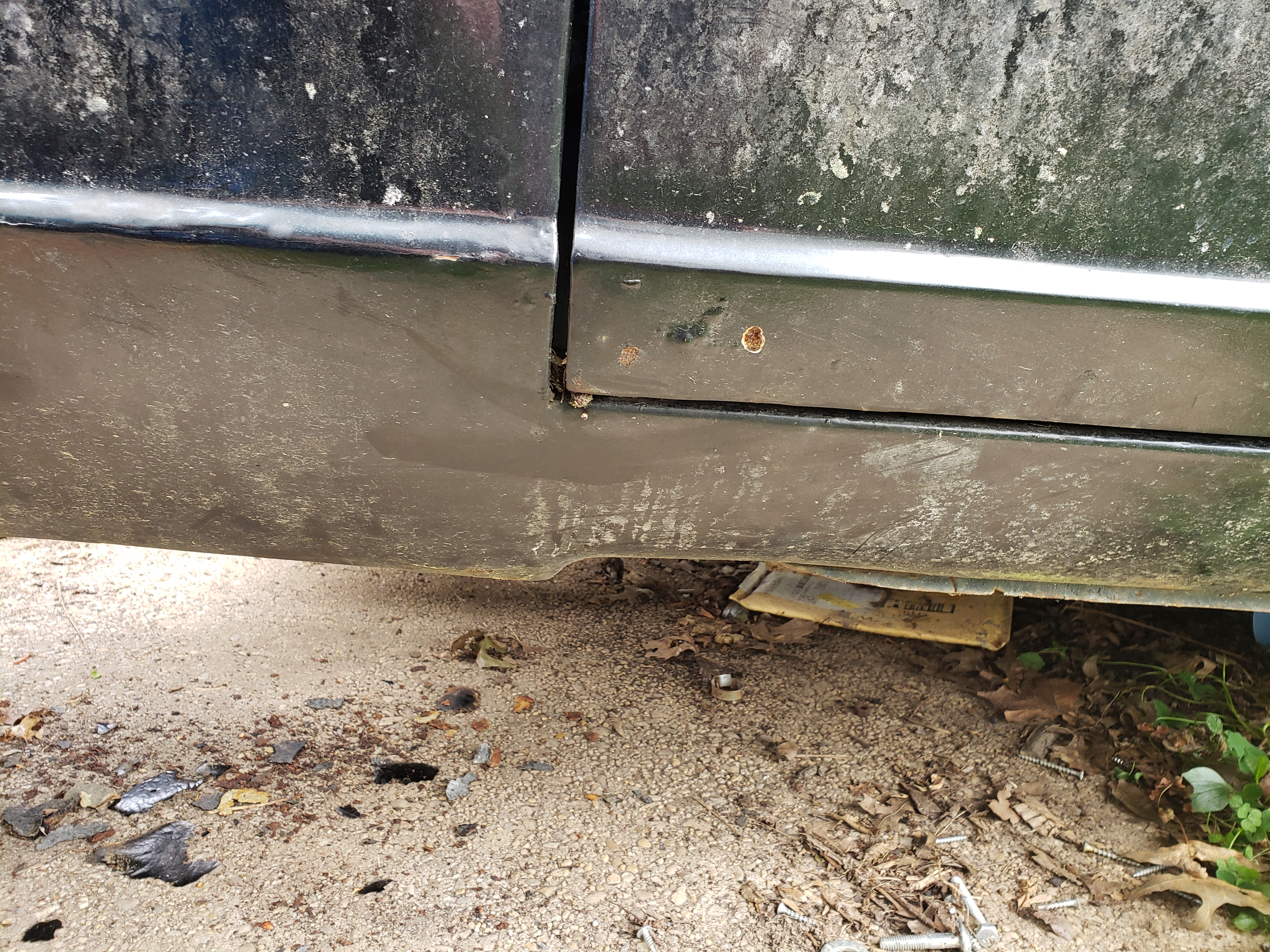

So I'm in the process of tearing down my '77 and it's looking like these fenders are welded onto the rocker panels and maybe the subframe.  Here's a closeup of where the seam should be between the fender and the rocker, and some photos of the underside where the bolt(s) should be attaching the fender...

Well they might have been welded on but at the moment all you can see is where the seam has been mudded over, get your knife out and start digging out all the filer, I have a feeling you are going to find a lot of rust behind it. Anything is possible with POs
Yeah also gonna need to strip the paint away form the area where the seam is supposed to be.  I've removed all the bolts and the headlight cases and both fenders still feel pretty solidly attached.  At this point I'm assuming the worst and that I'll be cutting it out with a grinder.  Praying I can save the fenders.
I agree with GK get a grinder with a flap disc and a dust mask and work your way down. If I had to guess, I would say a previous owner used bondo or fiberglass to attach them to the car. Fiberglass holds pretty good and would make them feel firmly attached

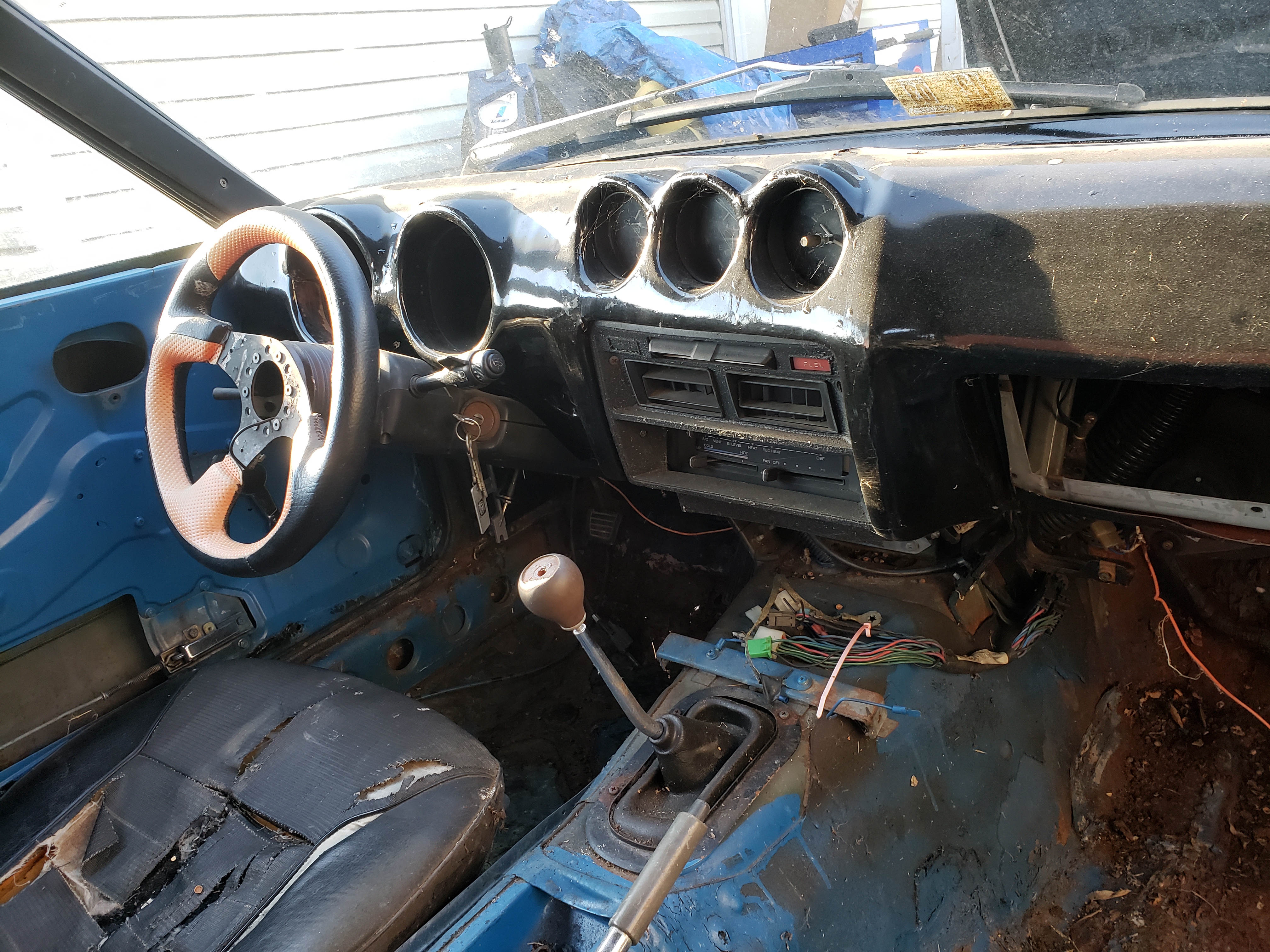

Yeah that makes sense, especially since fiberglass was used on other parts of this car, like completely encasing the center console and the dashboard...

Someone was a big fan of bondo! Interesting effect on the dash.

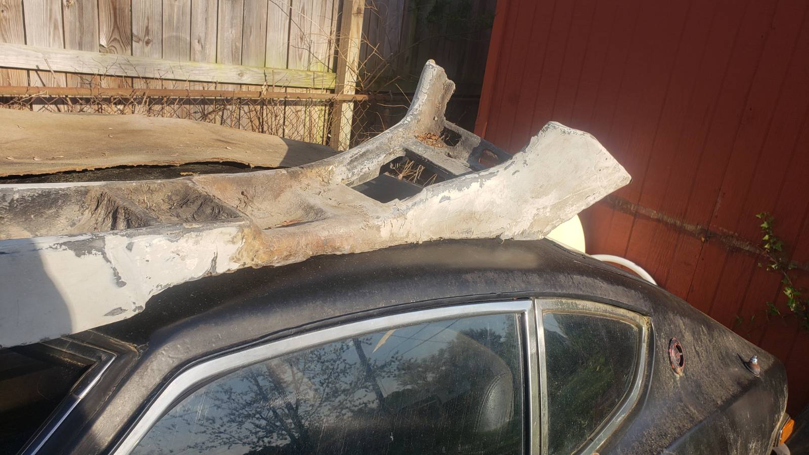

It's a lot uglier in person.  Just can't wait to scrape all that off.  I did get all the fiberglass off of the center console.  That was so much fun...
