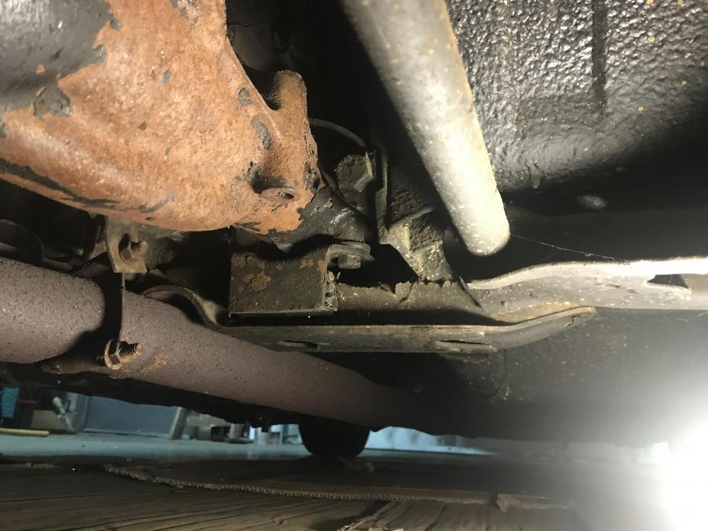

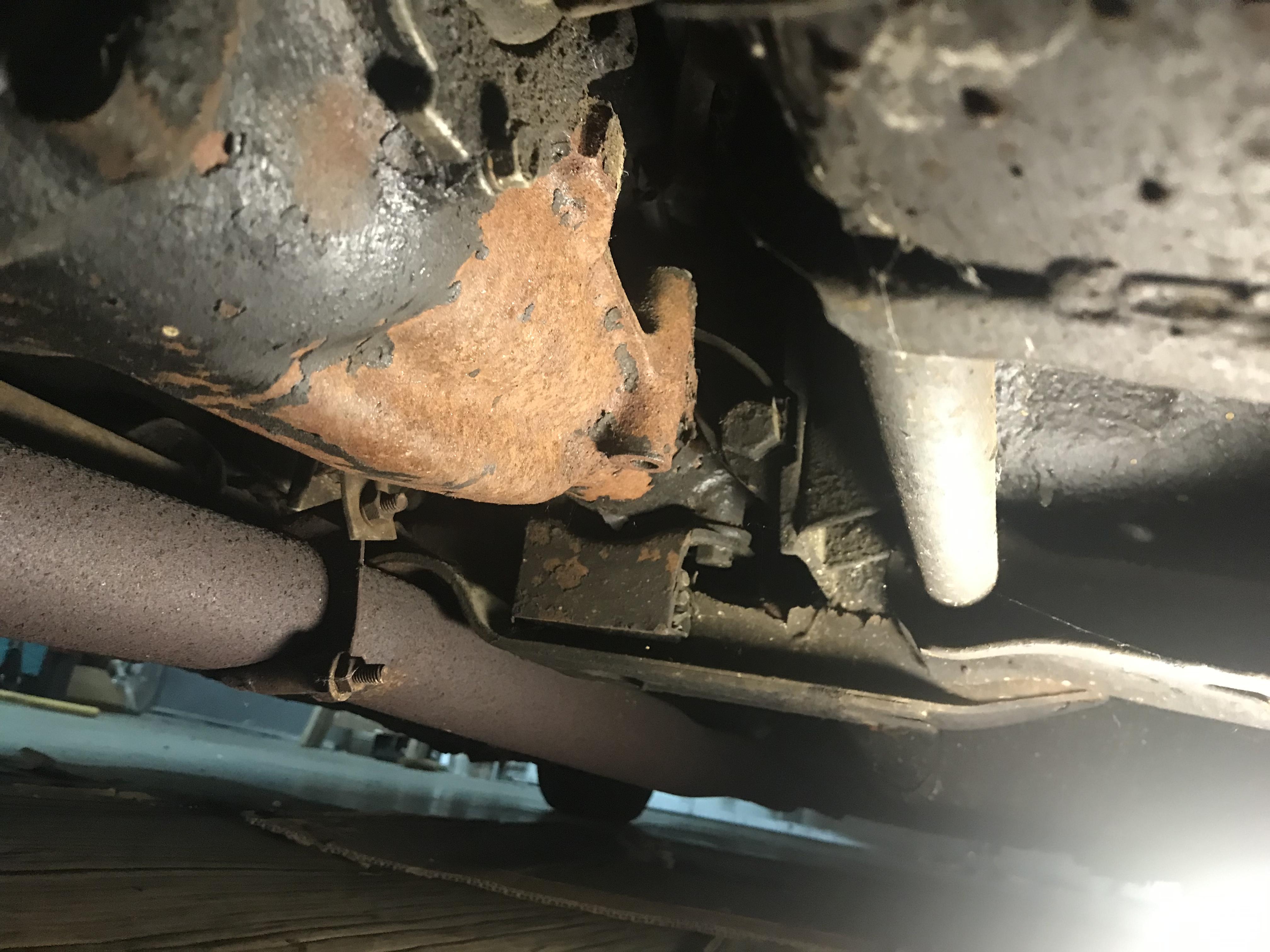

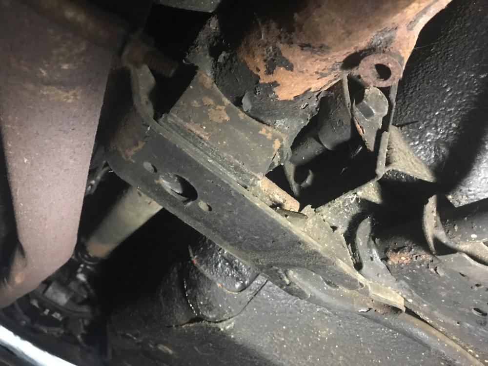

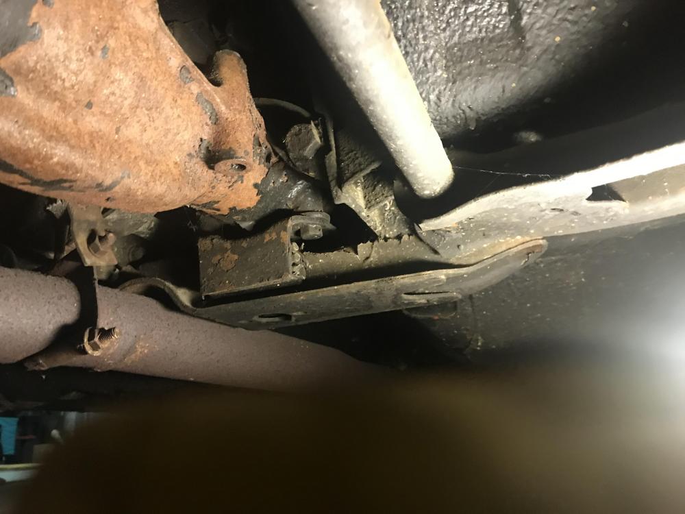

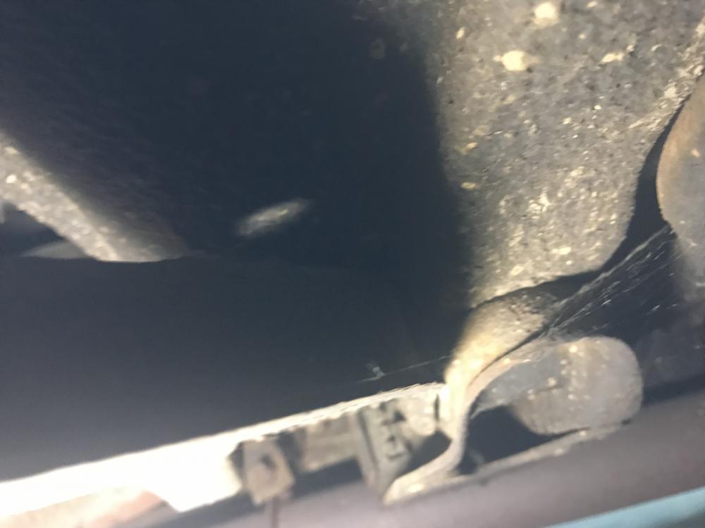

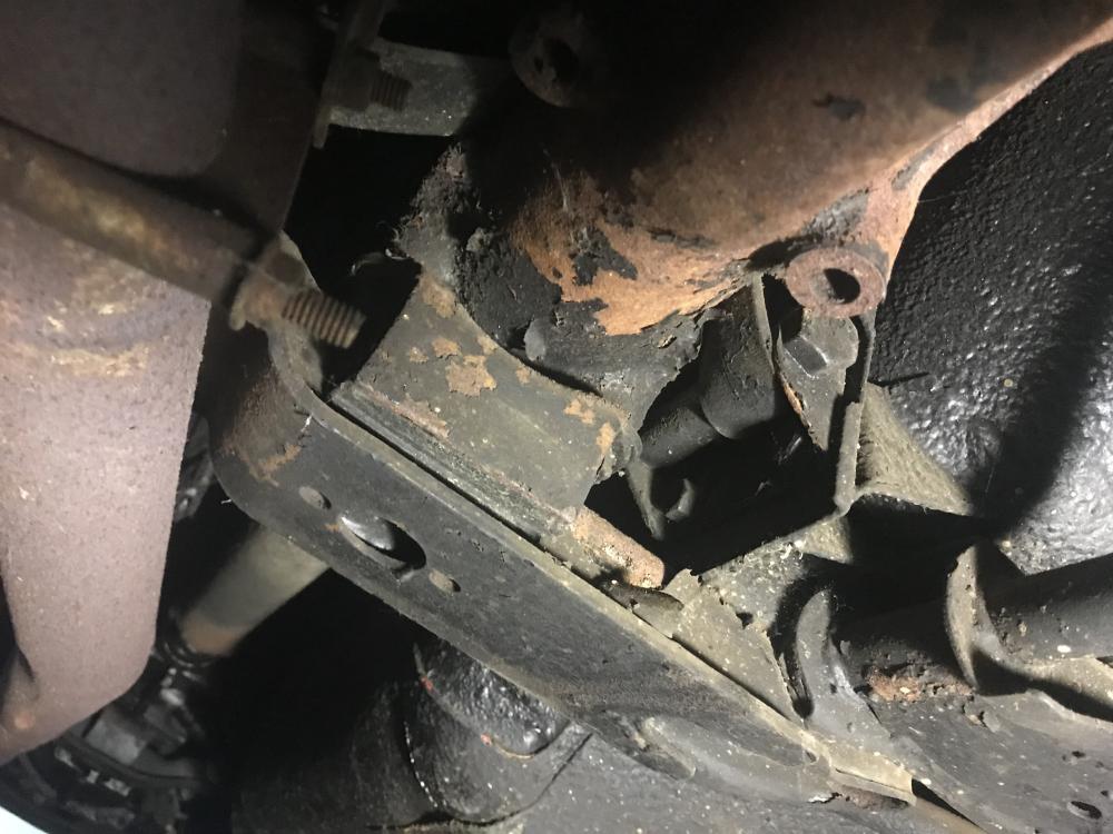

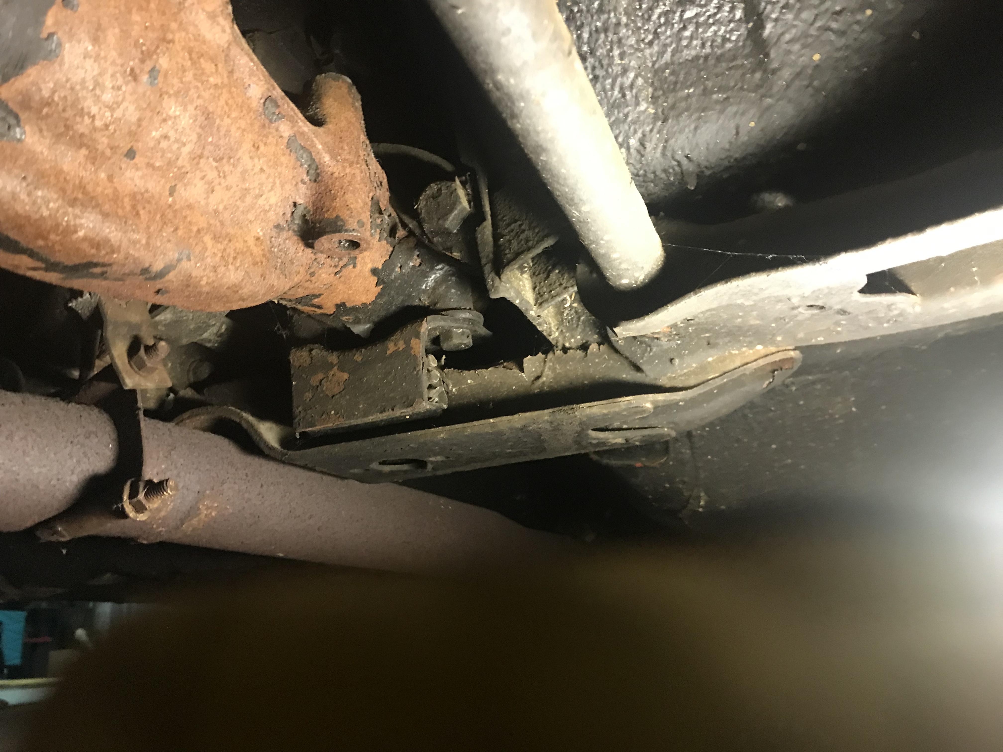

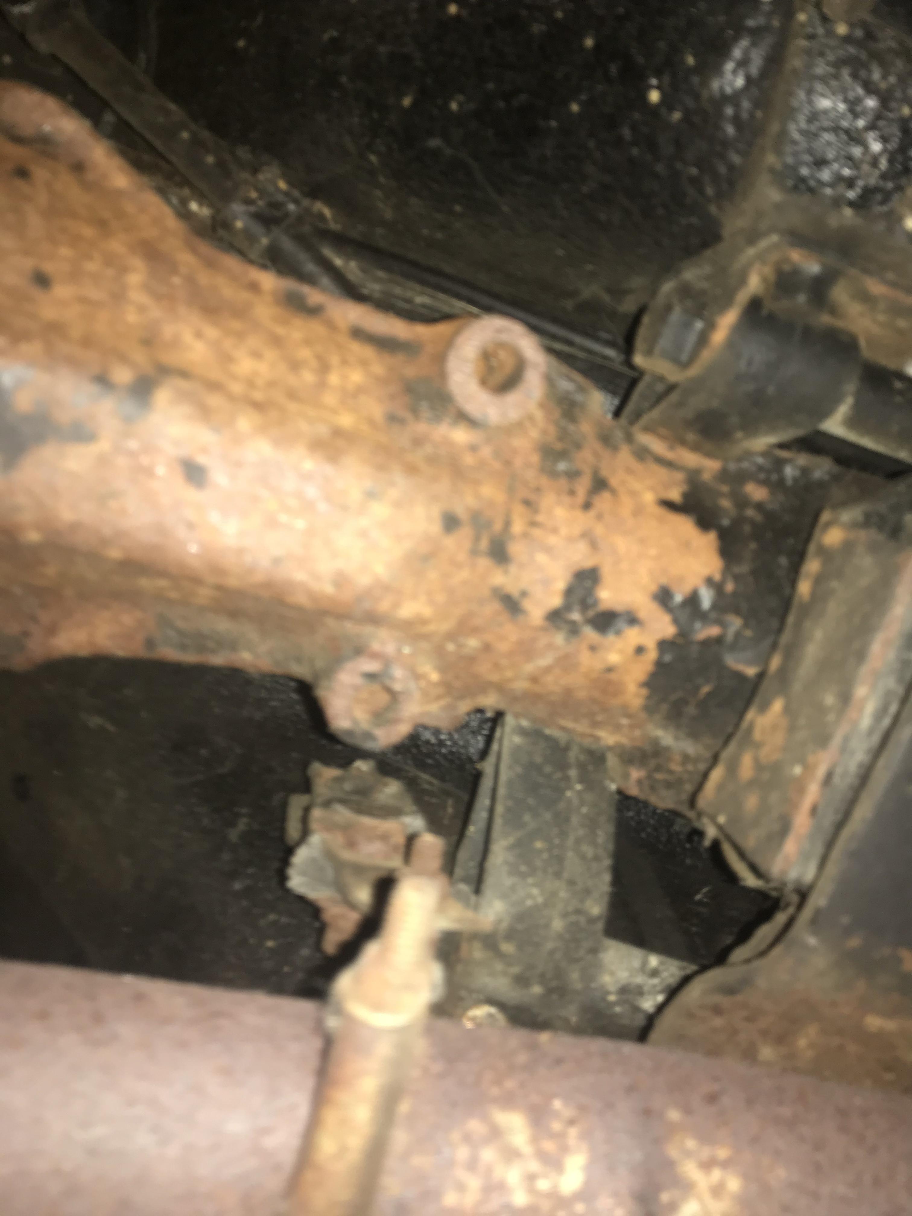

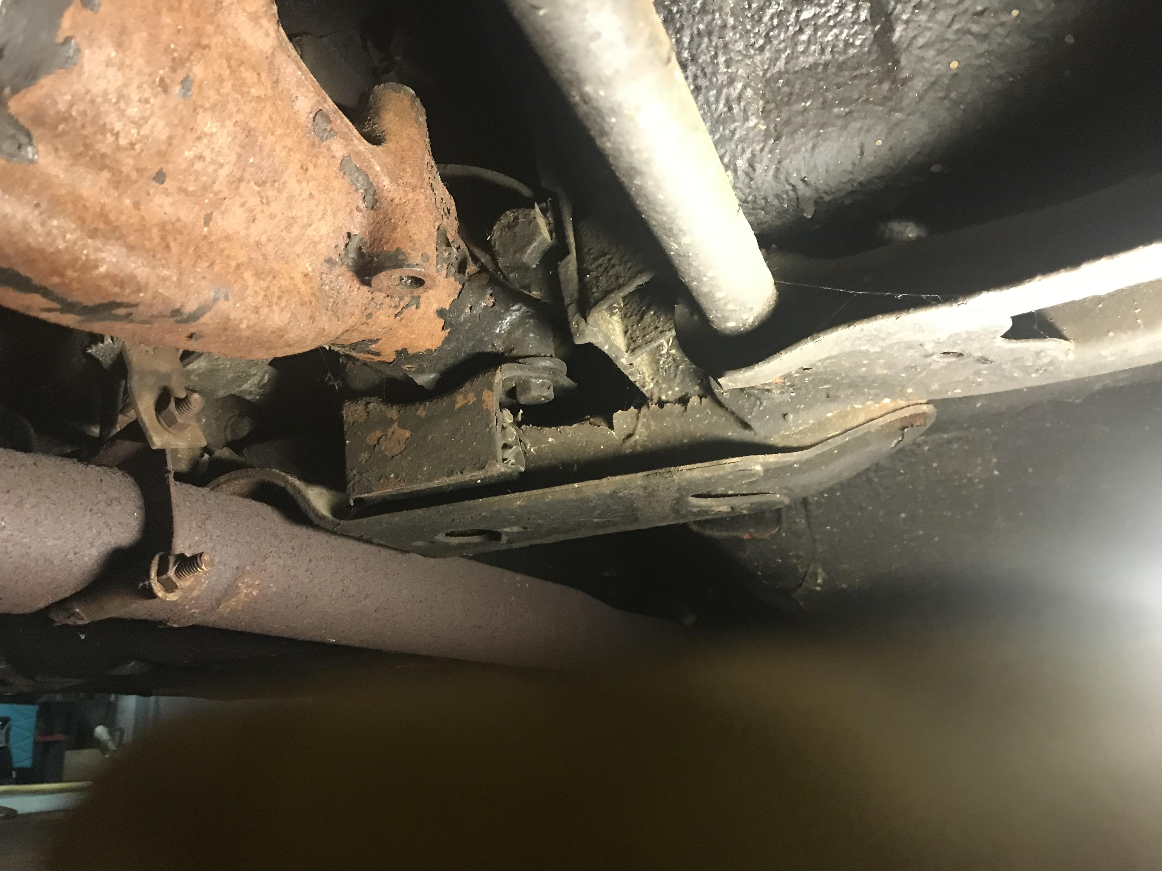

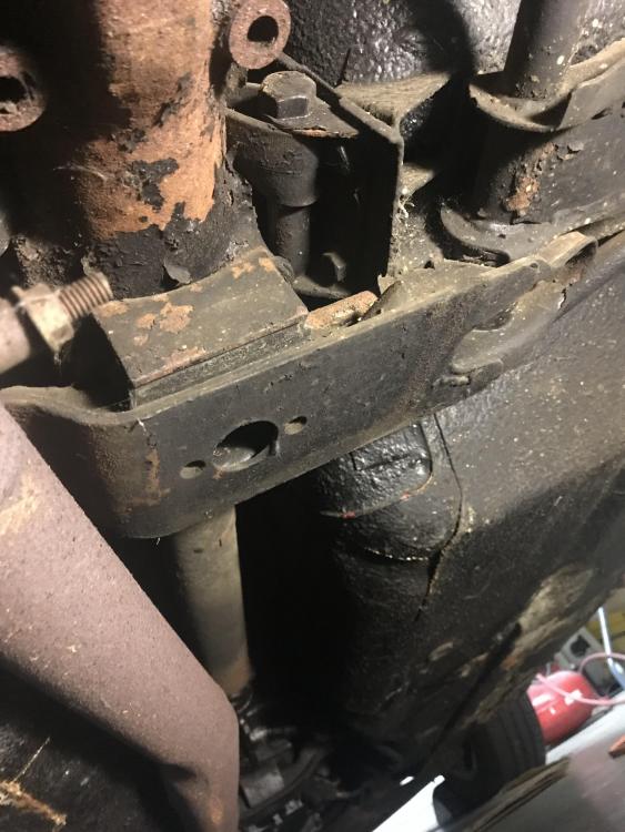

Shawninvancouver Posted June 15, 2021 Author Share #27 Posted June 15, 2021 Here are photos from underneath. Strap is ok. Diff mount is ok. Looked like shaft connector on back was ok. Can you send anything weird in photos ??? Link to comment Share on other sites More sharing options...
Racer X Posted June 15, 2021 Share #28 Posted June 15, 2021 26 minutes ago, Shawninvancouver said: Here are photos from underneath. Strap is ok. Diff mount is ok. Looked like shaft connector on back was ok. Can you send anything weird in photos ??? Not a single picture of the nose mount on the diff showing the condition of the rubber. I would take a look there, use a pry bar and see if there is any play. Those mounts tear somtimes, and that might be the clunking you are hearing. Also check the u joints on the driveshaft and half shafts. 2 Link to comment Share on other sites More sharing options...

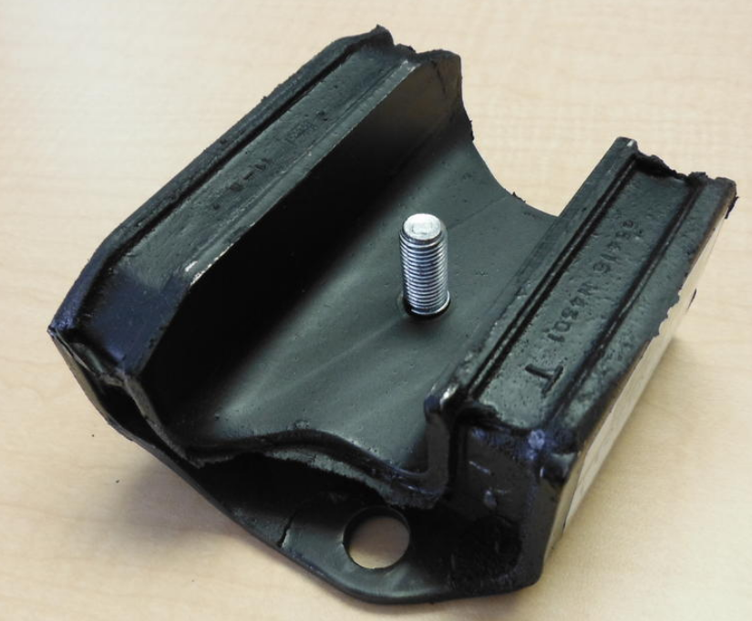

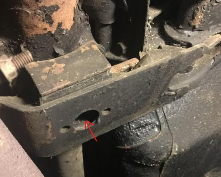

Zed Head Posted June 15, 2021 Share #29 Posted June 15, 2021 The diff mount seems to be sitting high. Look up in this hole and see if there is a nut on the threaded stud. Stole from Namerow. 1 Link to comment Share on other sites More sharing options...
Shawninvancouver Posted June 15, 2021 Author Share #30 Posted June 15, 2021 ok - i will look there for a nut.. what would the effect be with no nut there?? bouncing up and down?? isnt the diff just sitting on that rubber?? so even with no nut it just rests on it?? i looked at u joints as good as i could and they looked ok... i guess strap and mount look ok.. Link to comment Share on other sites More sharing options...
Racer X Posted June 16, 2021 Share #31 Posted June 16, 2021 Here is a video of how to check universal joints, and what you will see when one is bad (this one is really bad, any play is unacceptable). Your Z has 6 universal joints. Check them all. The front differential mount is two pieces of metal joined with rubber. One of the metal pieces is bolted to the differential, the other to the cross member. If both parts are bolted securely, then it is possible that the rubber has torn away from the metal. To check for this use a prybar too lift the nose of the differential, and observe if this is the case. The transmission mount, and the engine mounts are of similar design, and are checked the same way. Check them. Also, check the exhaust. Grab the muffler outlet and see if it wiggles, observe how much, and if you hear any part of the exhaust hitting anything. A little wiggle is OK, a lot, not so much. Examine all of the mounts, repair or replace any broken parts. Bailing wire or coathangers are not acceptable repair materials. Link to comment Share on other sites More sharing options...
