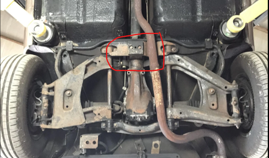

great photo
23 minutes ago, Shawninvancouver said:
great photo
The strap is visible in the picture.  It looks like a strap.
The noise is caused by the nose of the differential lifting up and bumping the stuff in the transmission tunnel and/or the diff nose dropping down and banging off of the crossmember after it lifts up.

The strap can be removed without dropping the diff, depending on what you replace it with you might need to drop the diff to install the parts.

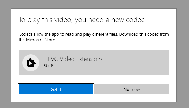

In the attached video do you see something hanging out the bottom of the car as it drives farther away??? I think I see something and it ain’t the exhaust I don’t think.
You should create a youtube channel and put your videos there.  I've only been able to play a couple of them.  Your latest one won't play.
If you lay down under the fuel tank and get a photo it will be easier to tell. It looks like the exhaust going under the diff mount…
+1 on the techoniversions diffmount, it’s great.
If the diff is bouncing around you might need a new lower diff mount too.
some people make new straps, that’s also been documented in other threads.
