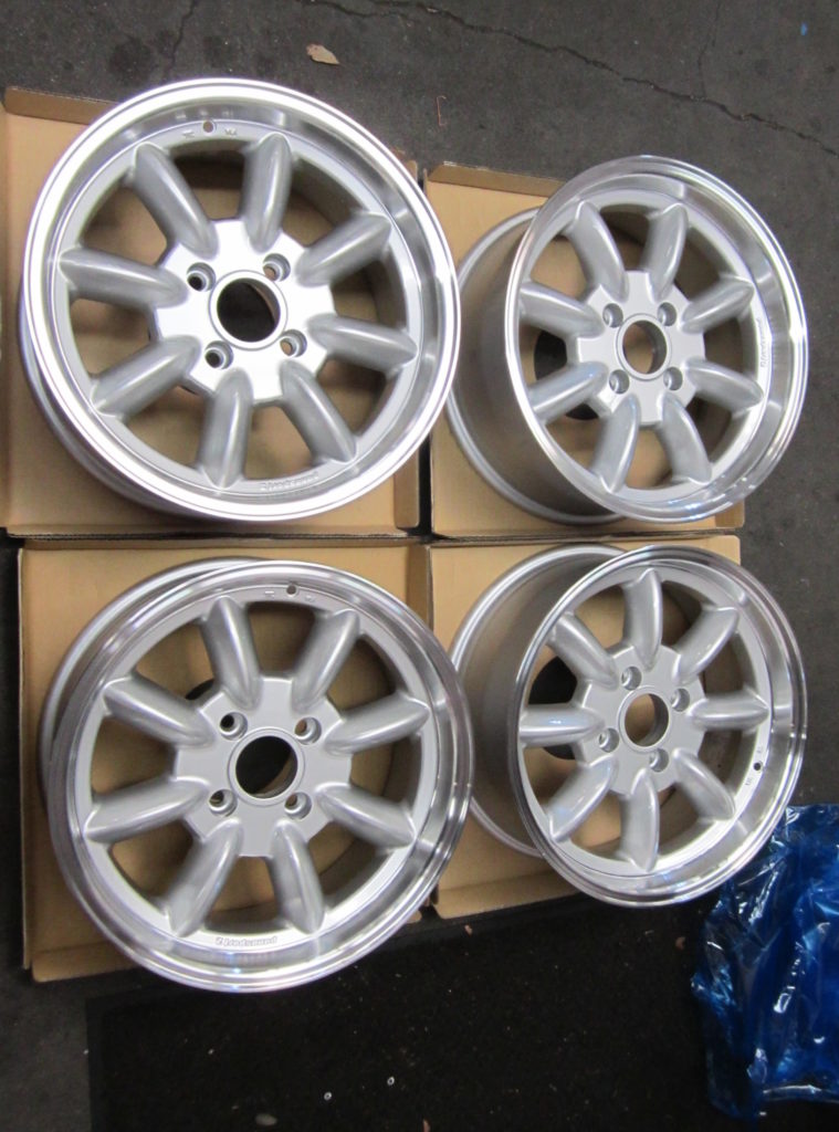

"ZcarGarage is a factory direct dealer for the Japanese Panasport 16X7+11 offset FS wheels that are our favorite go to wheel solution for the S30 model that allows fitment of 225-50-R16 tires.  The wheels have silver centers with machined lip and include the center caps.  Limited sets available.  Timeless styling for your Z car.
Price: $1,220.00 plus shipping.  Please contact ZCG directly."

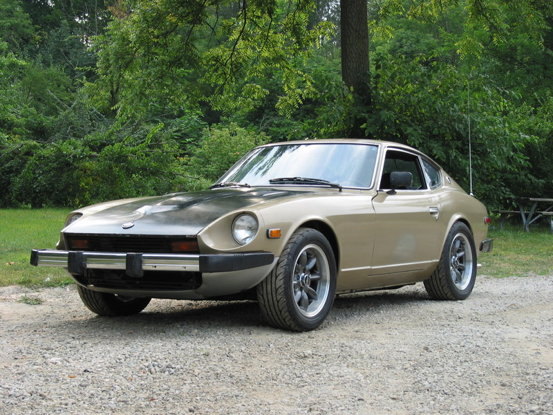

Hi Jeff and other members. I'm new to the forum and excited about fixing up a 73 240z and being involved with so many enthusiastic and knowledgeable members. Jeff, may I ask what the wheels/tires are on the z you posted above? They look great, as does the car! Are they Konig Graphite 16 X 7 with 0 offset? Is a 205 the widest tire you can run on a 16 X 7 with 0 offset and not have rubbing on stock shocks/suspension? Does a Panasport 16 x 7 +11 with 225/50s end up looking the same in the wheel well as a 205 with zero offset? does the Rota 16 X7 +10 offset allow the 225s without rubbing also? I like a little color on the spokes and not sure if the Panasport comes in different colors like the Konigs and Rotas. I do like the wheels/tires filling the wheel well as pictured but hoping to stay stock for now, avoid rubbing and rolling edge (though not opposed to it!)
