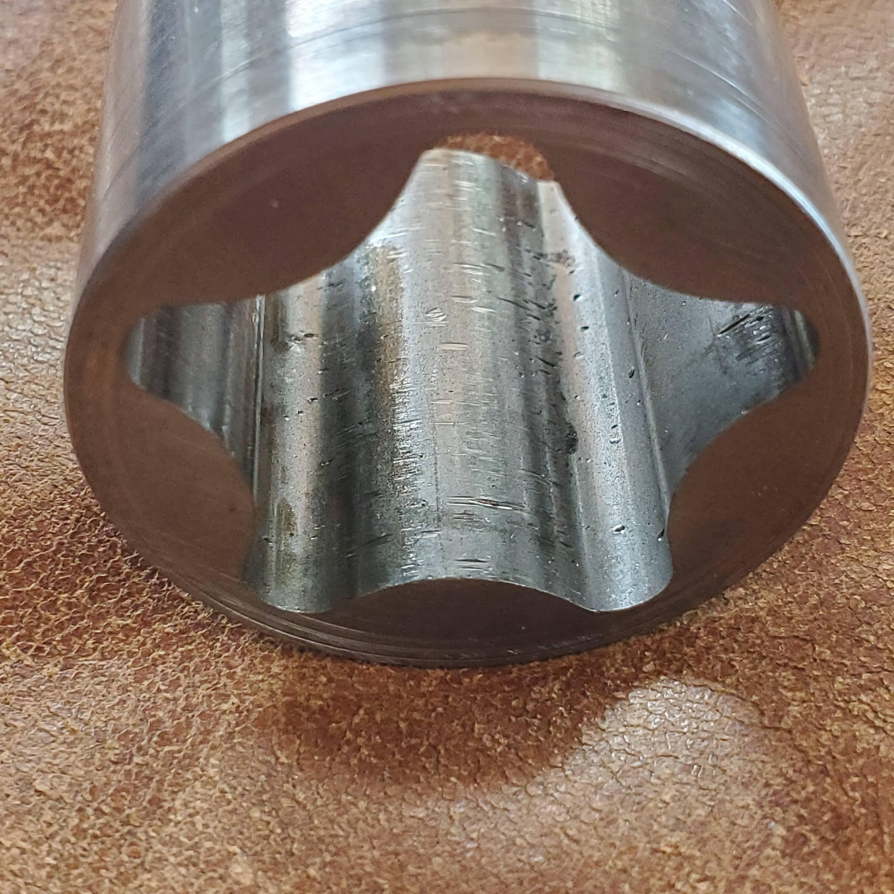

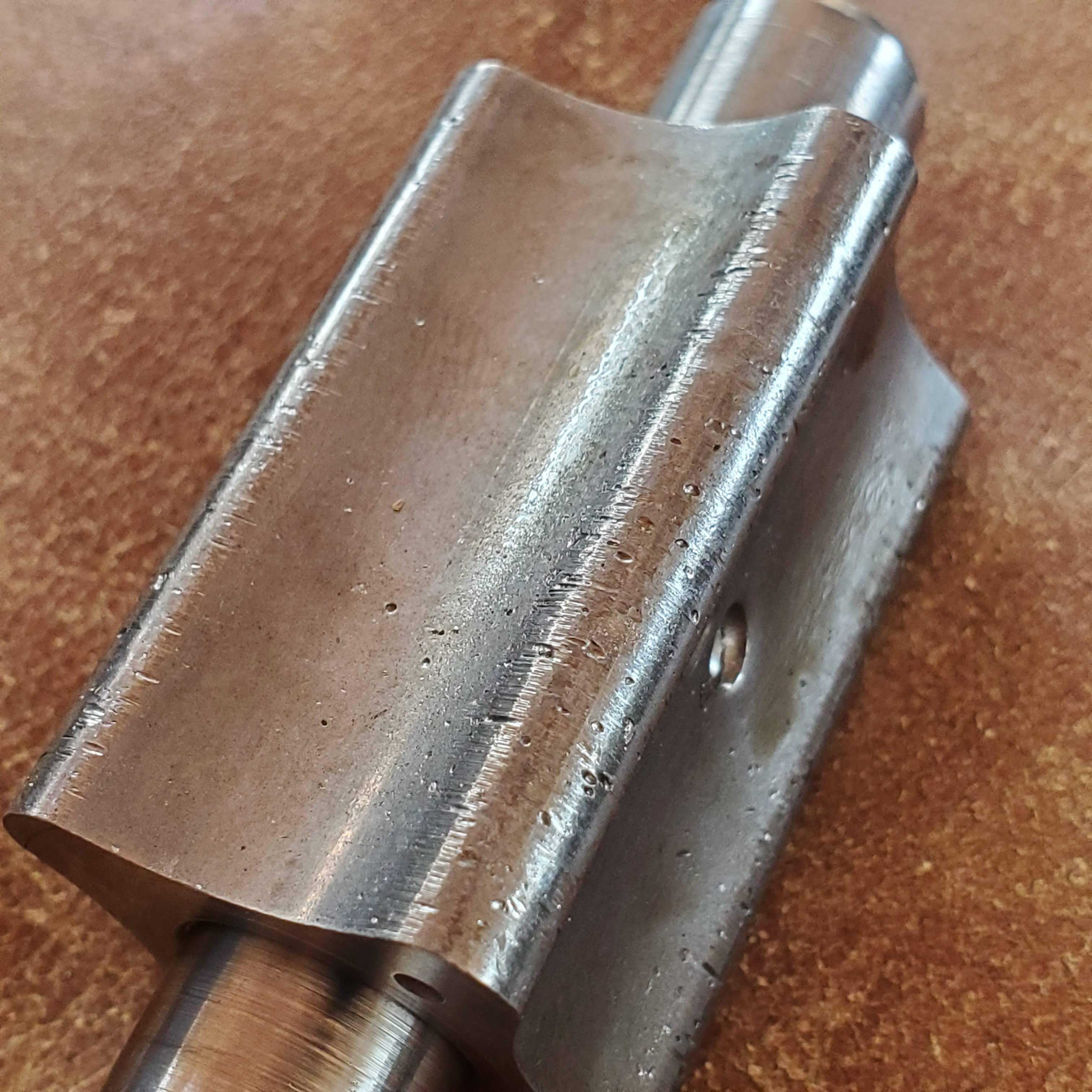

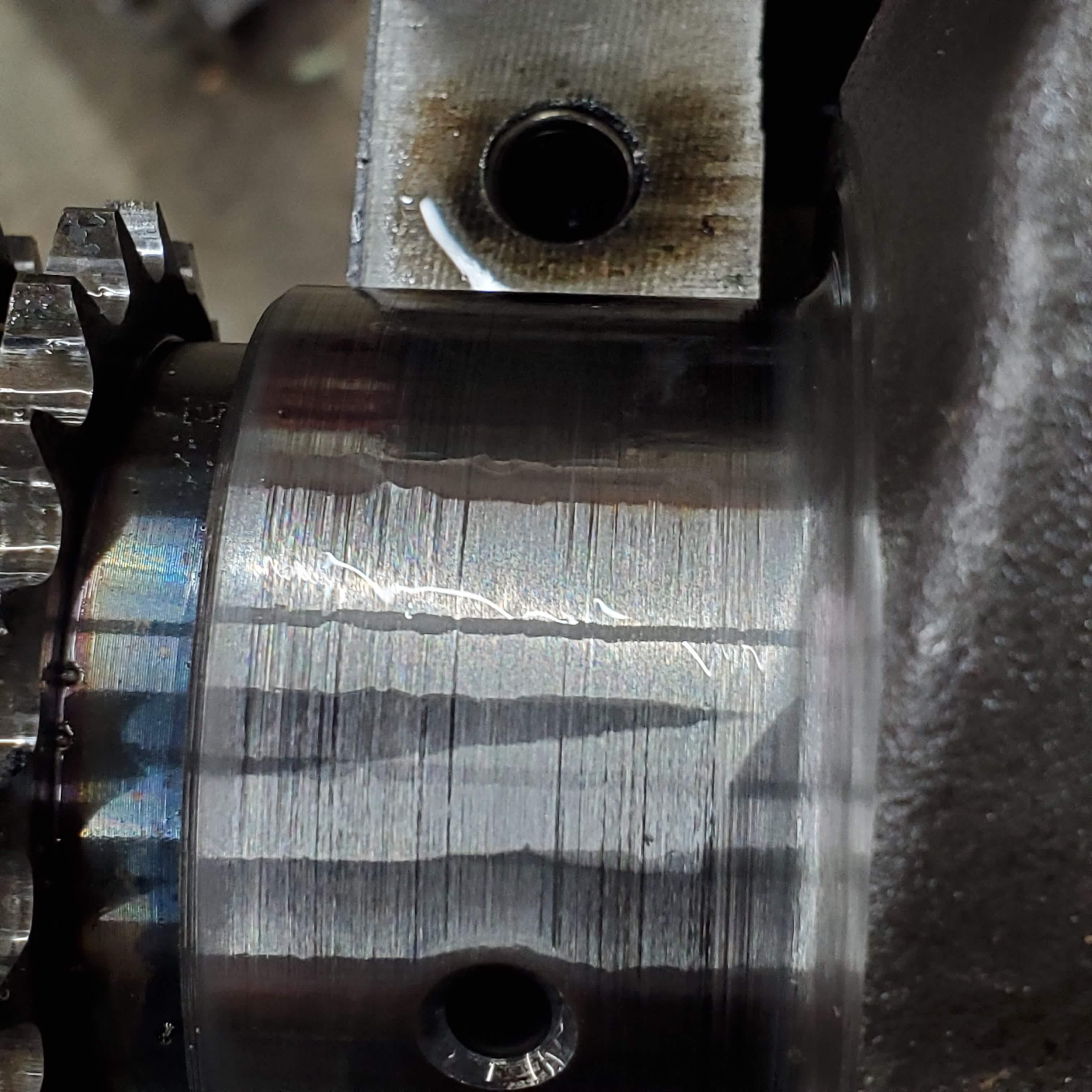

Drove the car maybe 10-15K miles before putting it on the rotisserie (1997).  Upon disassembly of the motor this past Jan found hard debris and metal shavings in the oil pan and head.  The oil pump was badly damaged, journals scratched, cam towers worn past use.  Interestingly, the machine shop just told me that one piston/rod was 12 grams lighter than the others which were all within a few grams of each other.  When they removed the pins and weighed everything separately, that one piston weighs 19 grams less than the others.  I'm going off memory here, but I think that is near one half cubic inch of aluminum.  Machinist says the (ITM) piston looks fine.  Hoping to pick up everything from the shop next week so I can see for myself.
I get the oil pump would be damaged, but can't understand how the other parts ever saw debris to damage them.20210428_171342.jpg
