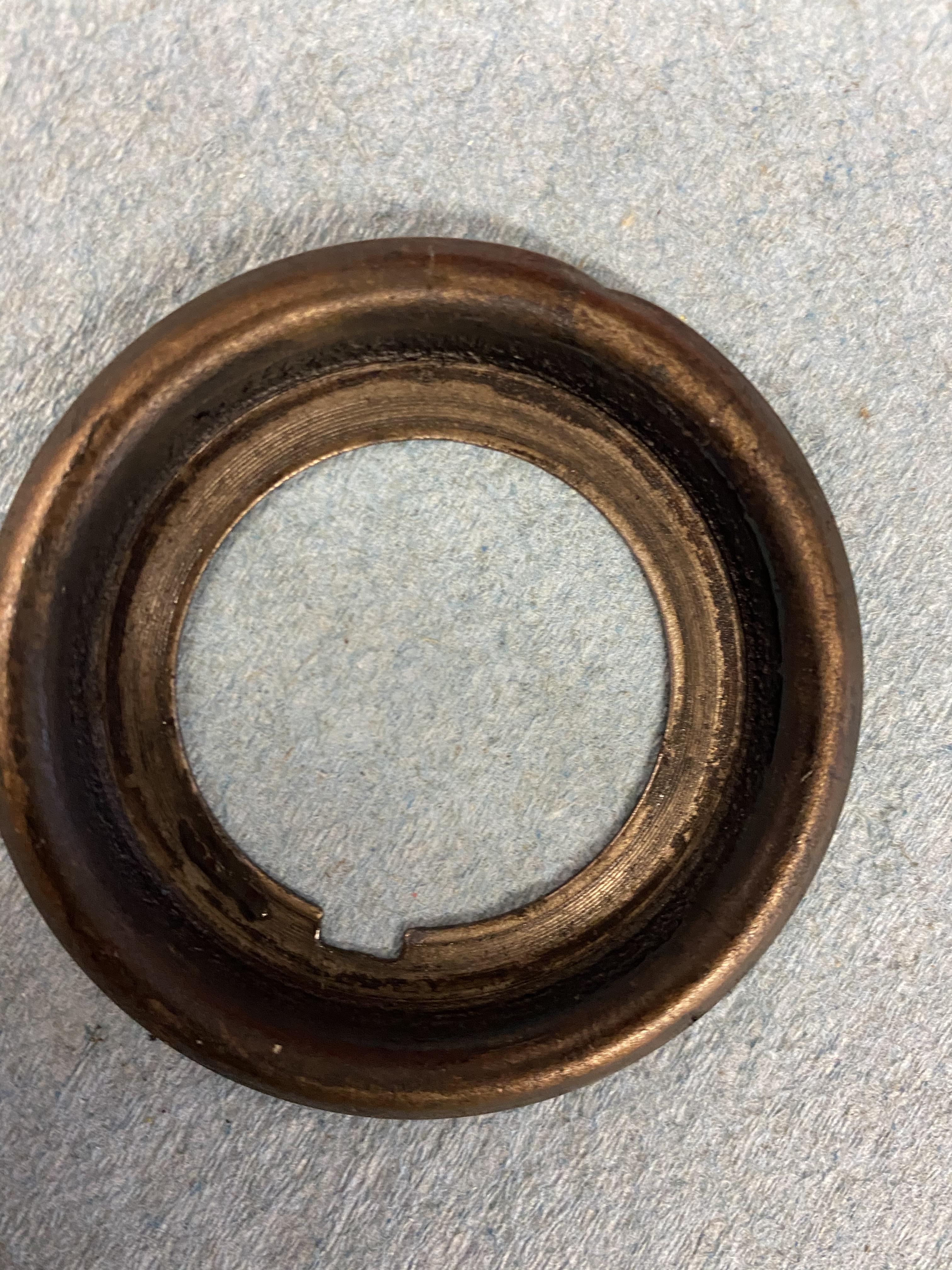

Is your oil slinger intact? If you pushed the woodruff key thru into the pan, it would probably destroy the circular metal oil slinger unless you were very lucky and the notch on the oil slinger was perfectly aligned to the key.
I wonder if the oil slinger is the "metal plate" that somebody was seeing in a recent thread about the woodruff key.  He was just trying to replace the seal and ended up with quite a mess.  His key was jammed in the keyway at an angle.
I've read that some engines didn't come with the slinger and many people just leave it out after working on the engine.

The Honsowetz modify book suggest leaving it out? Don't understand that but did it anyway on my 280. The 240 has one for sure after I researched a liitle better.

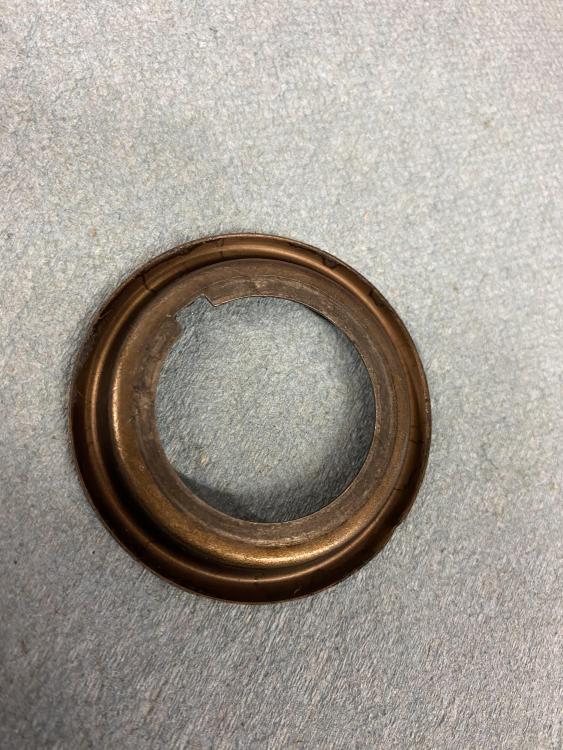

Interesting....I figured if the factory installed it, so would I. All of the engines I’ve taken apart have had them. Wonder why it’s called an oil slinger?
Here’s one those little suckers! Probably keeps oil off the seal would be my guess.
